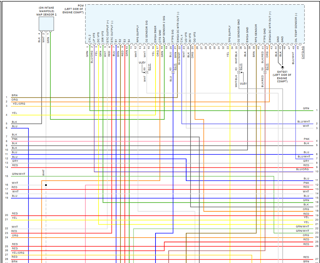

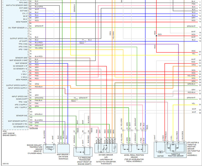

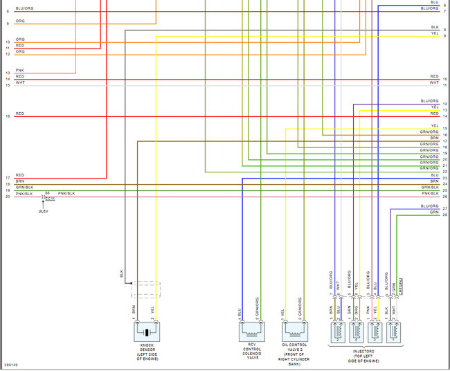

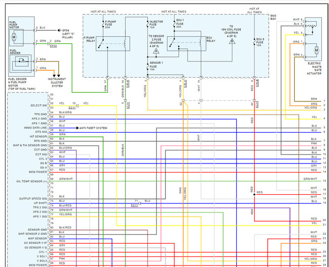

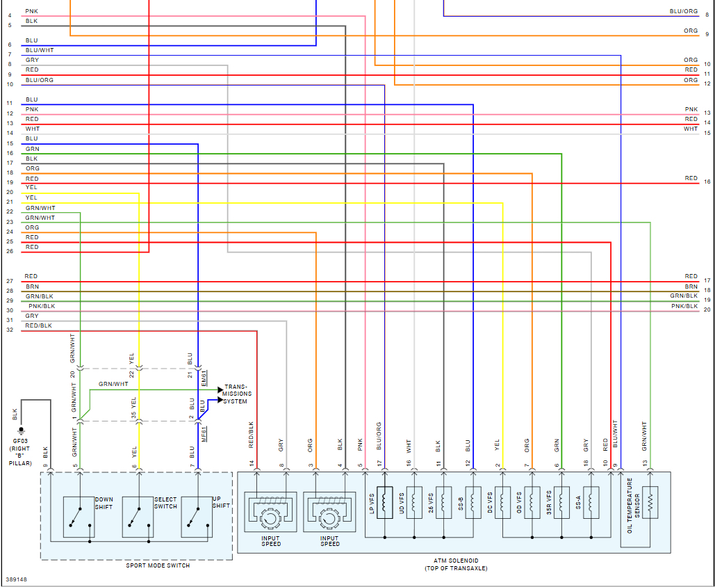

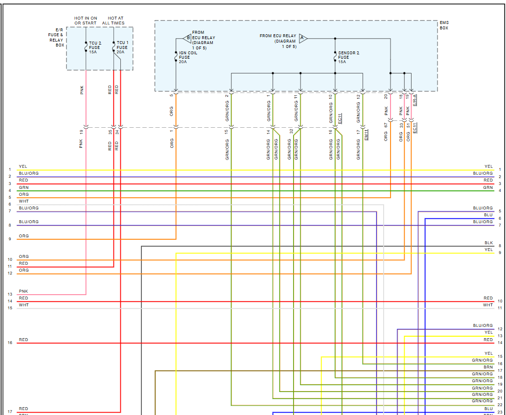

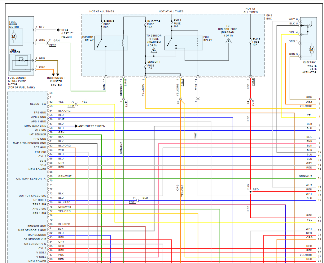

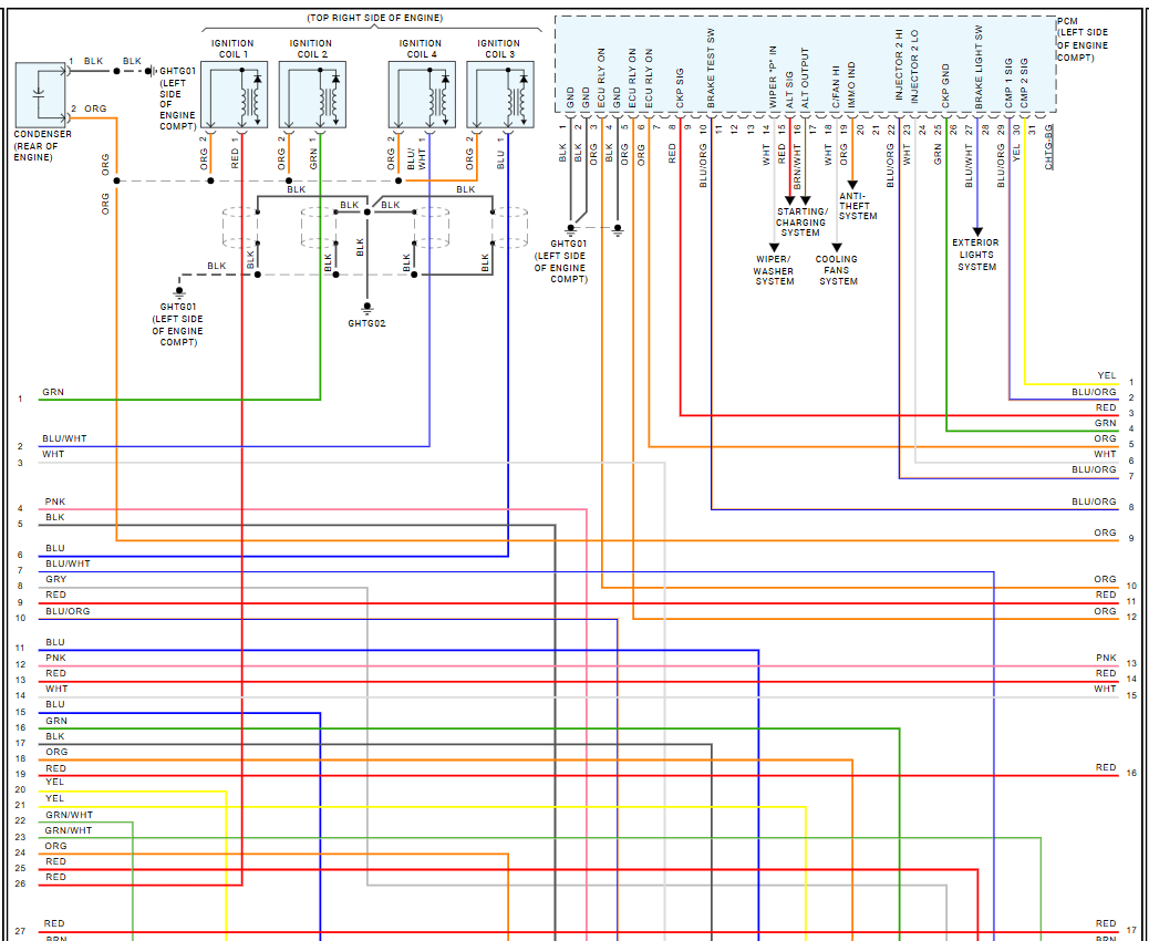

The engine is Cranking but it is not starting. The vehicle has been parked for a long time with driving. Rodents had eaten up the wires connected to the fuel injectors and some other wires on the engine.
Could I get the wire diagram of the engine management system in order to reconnect the damaged wires
Thank you very much.
Feb 4, 2025 at 10:07 AM

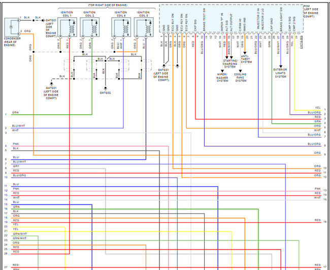

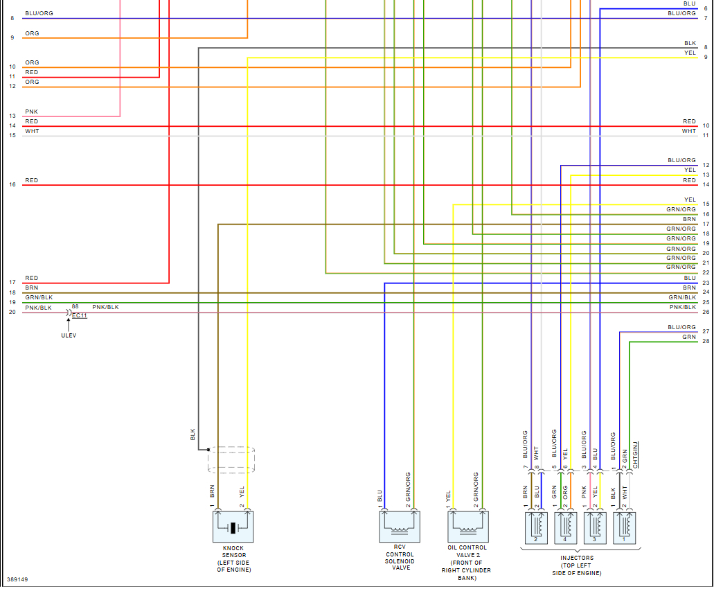

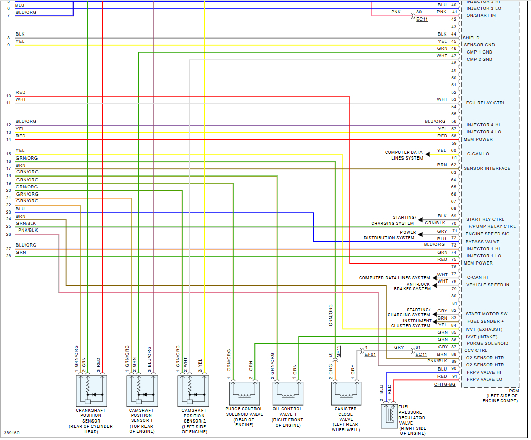

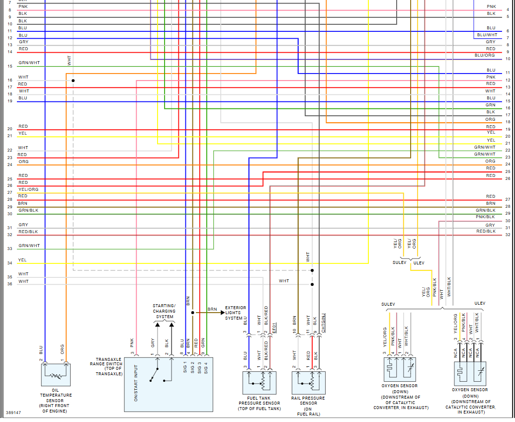

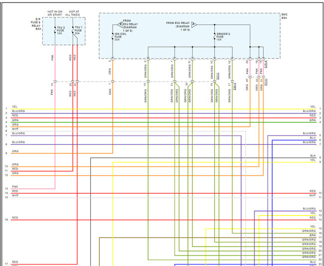

Yep, they like to eat wiring. here is a guide to help you with the testing and the engine wiring diagrams as requested:
