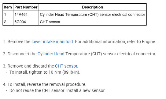

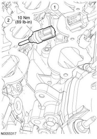

This vehicle doesn't have a traditional coolant temperature sensor. Instead, it has a cylinder head temperature sensor.
This sensor is under the lower intake manifold. See pic 1 below.

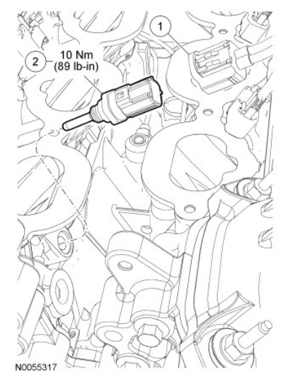

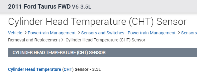

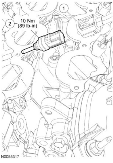

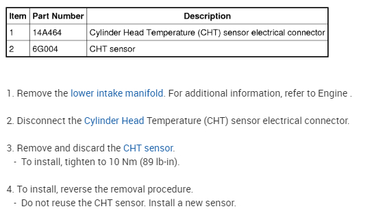

The remaining pics are the directions for replacement.
See pics below.
