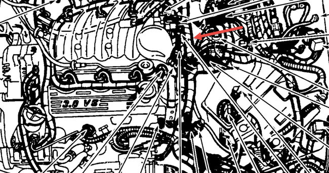

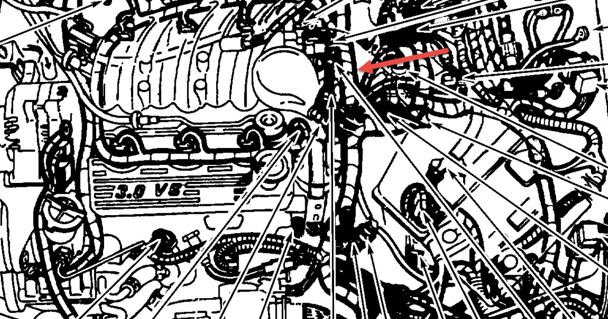

you have two cooling temperature sensors one for PCM and one for gauge. picture shows which one to change for gauge. also do not use silicone on it to seal use Loctite white.
