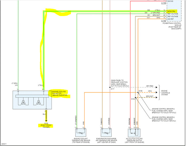

First fans would not shut off.
I was pulling my fuse when I stopped and shut off the car.
Then fans stopped running.
And the fuse is good.
Control module is my guess.
What do you suggest?
Engine cooling fans are two side by side in front of radiator
