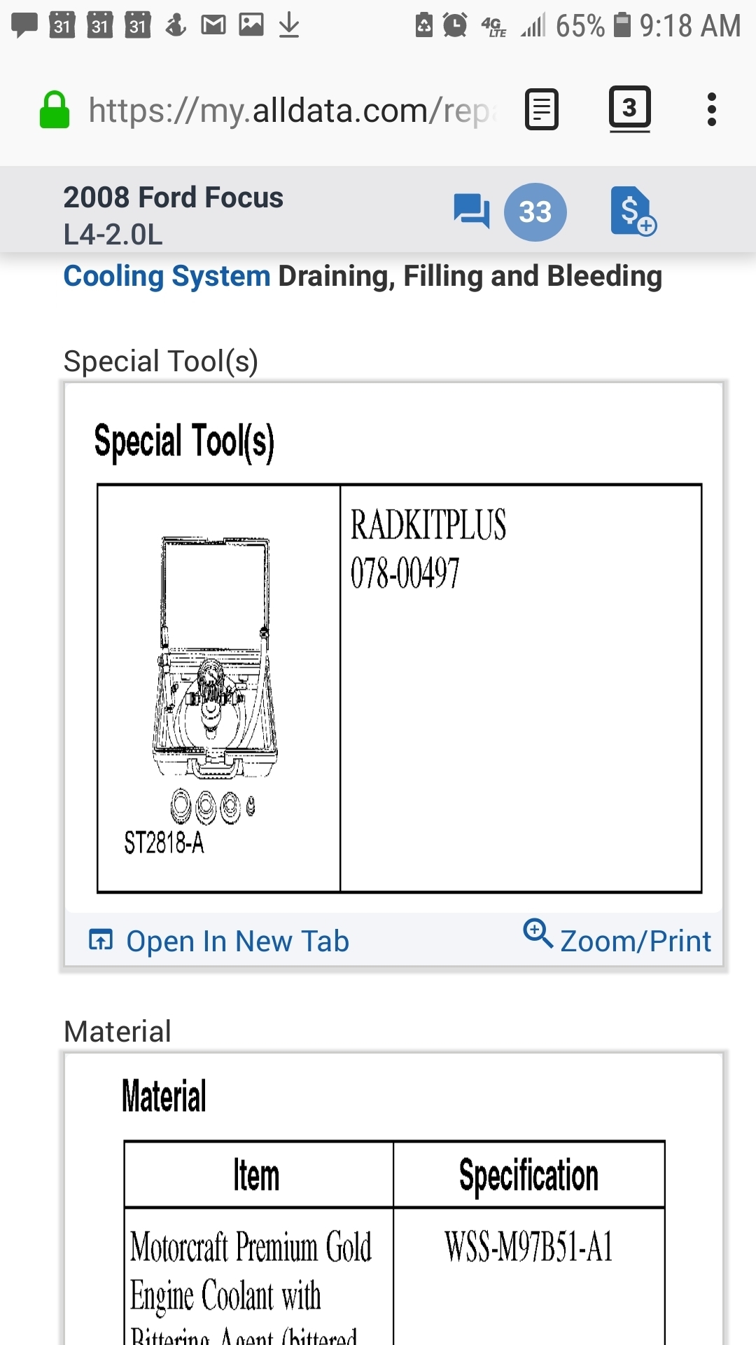

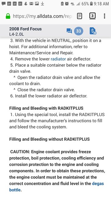

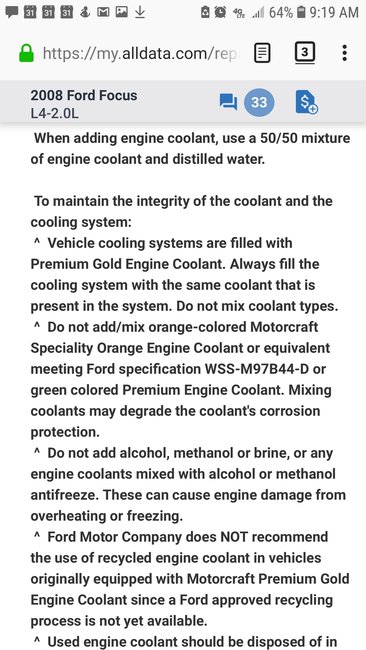

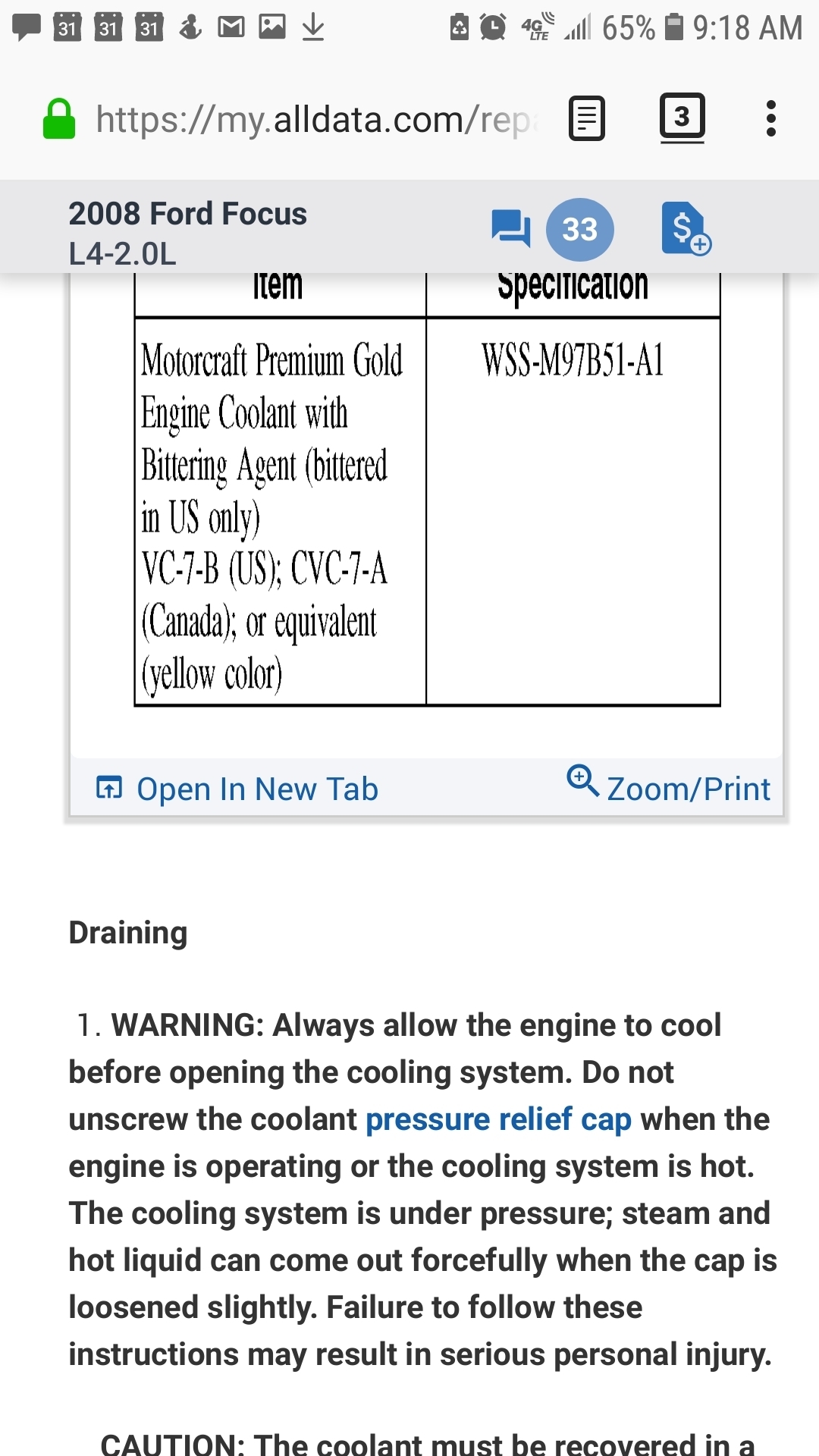

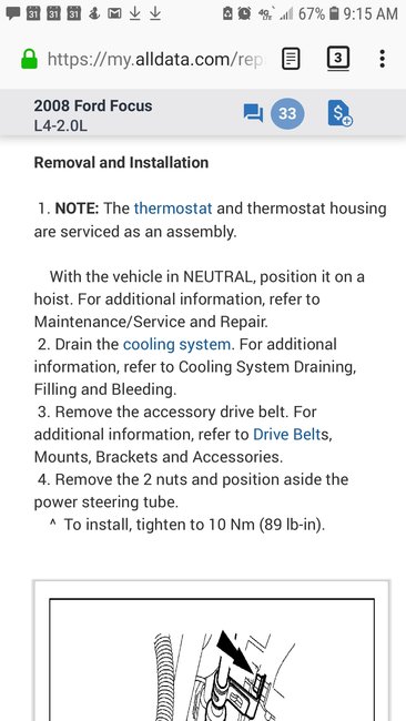

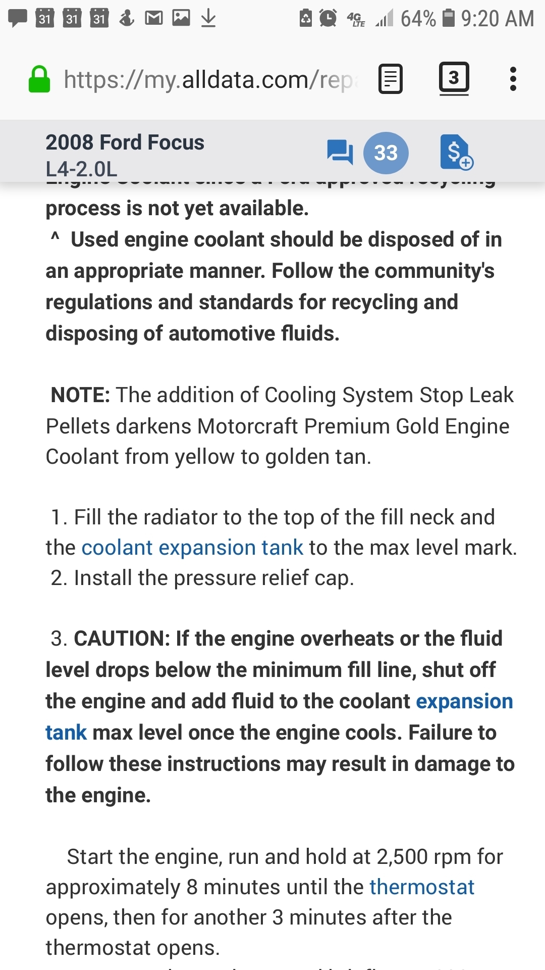

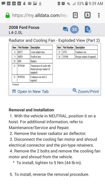

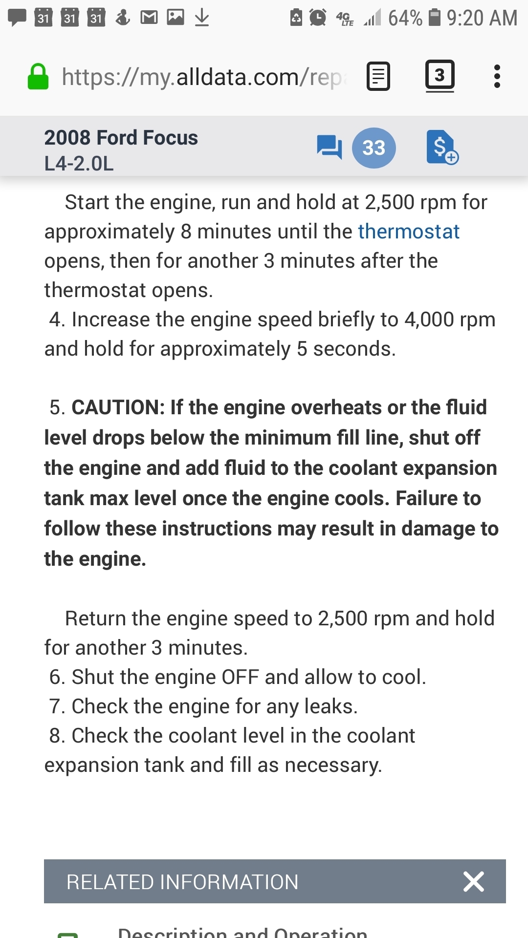

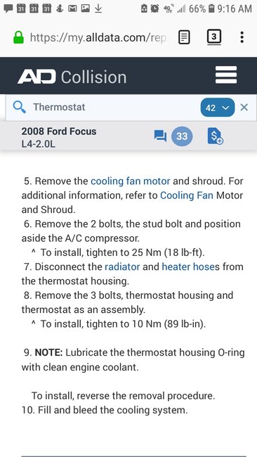

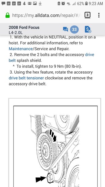

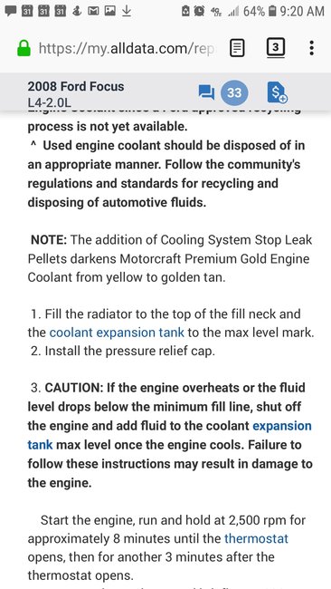

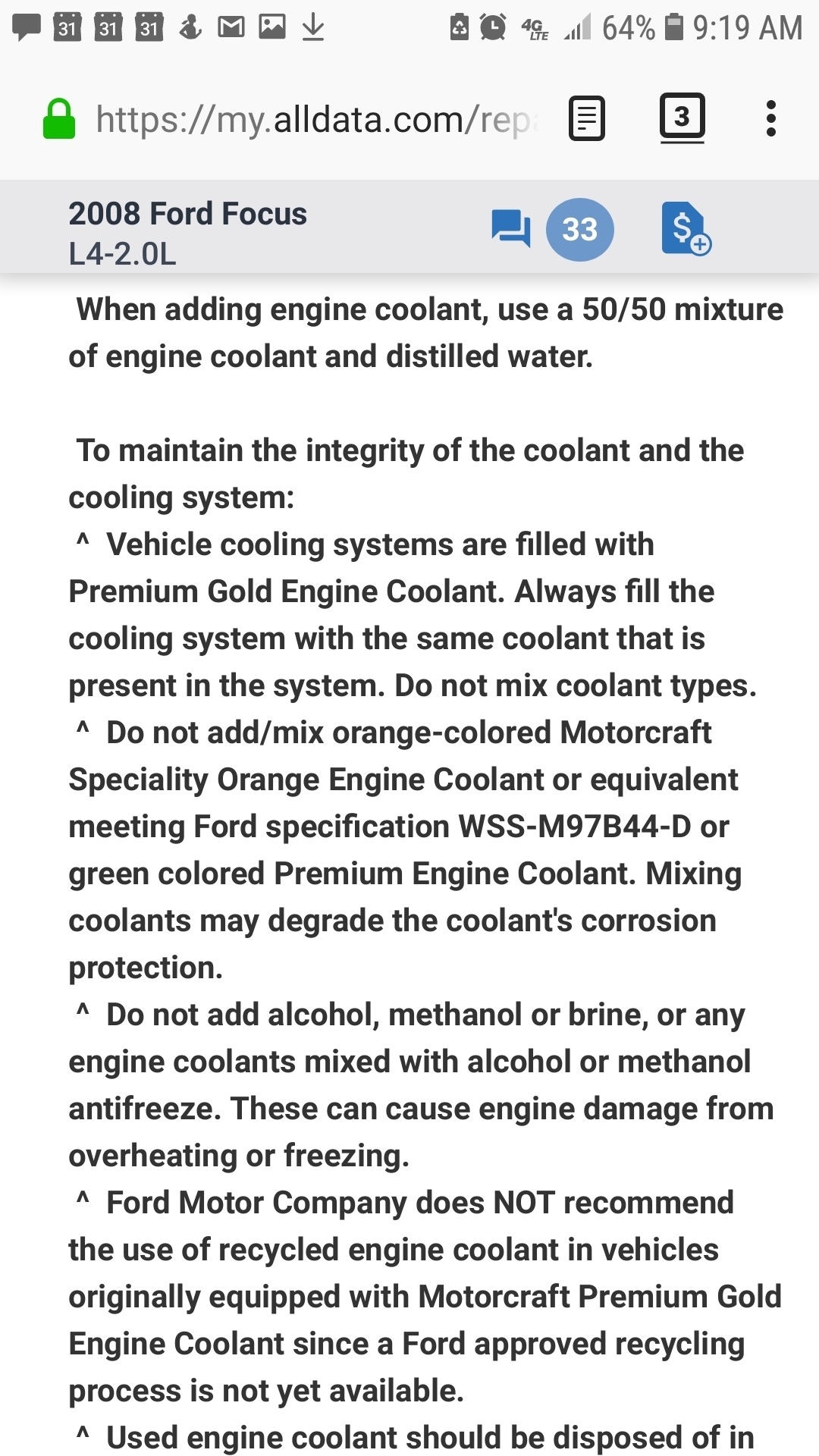

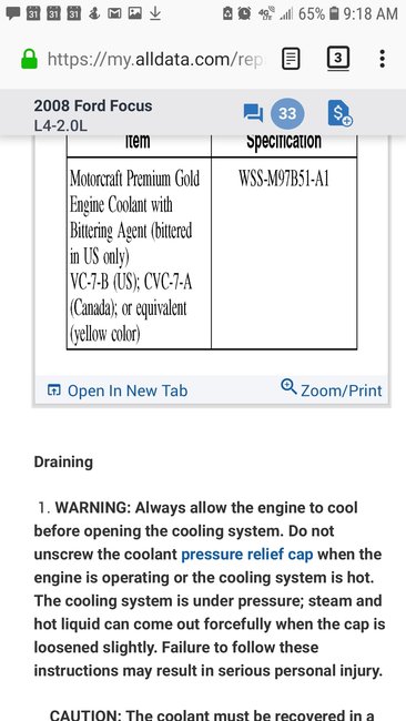

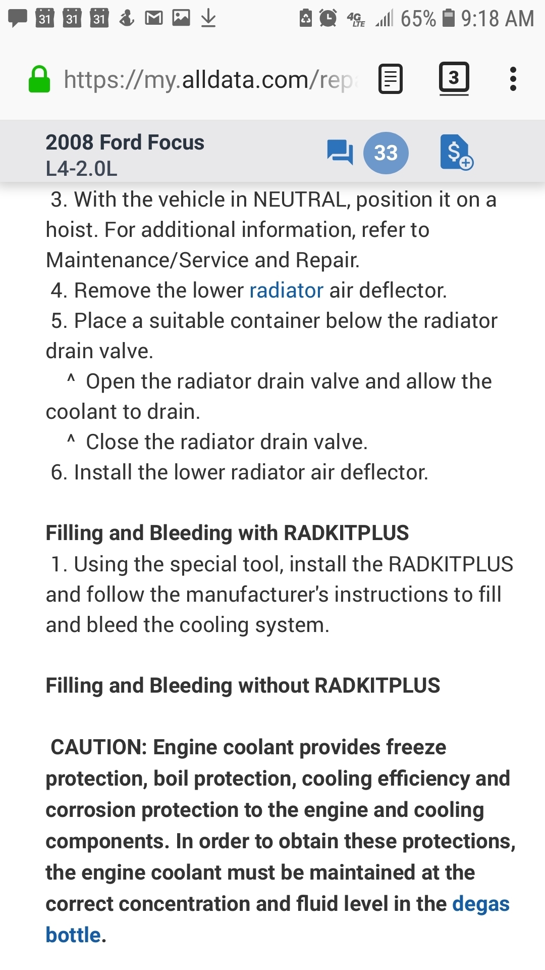

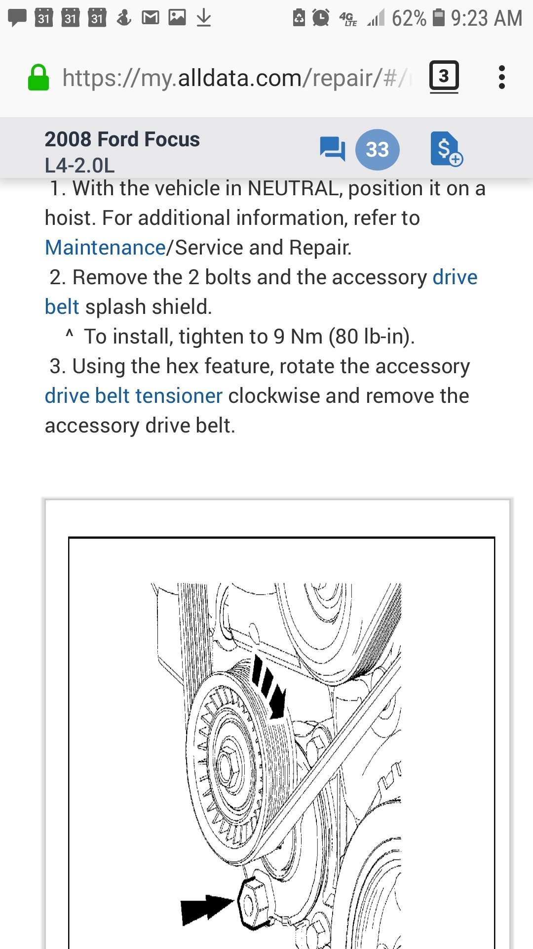

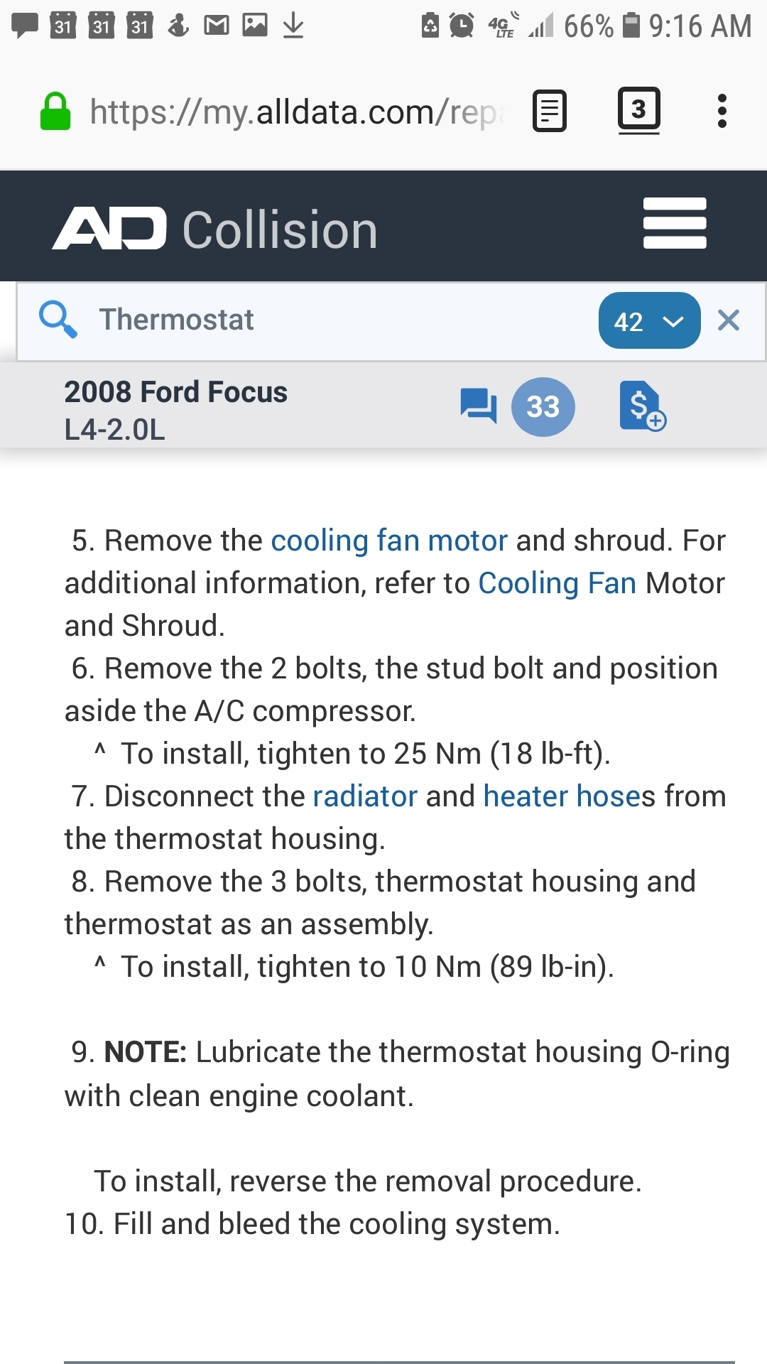

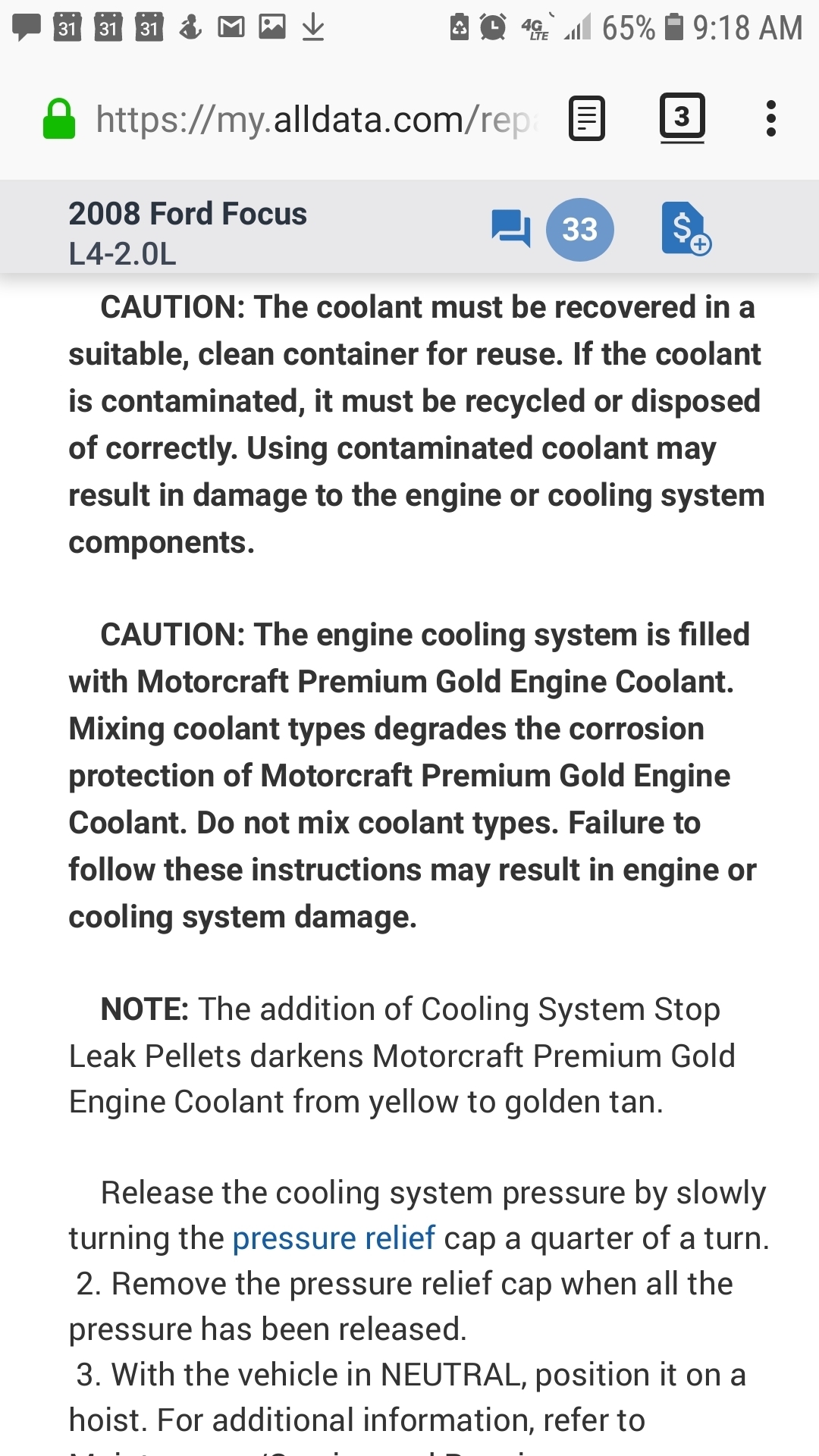

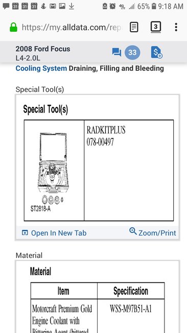

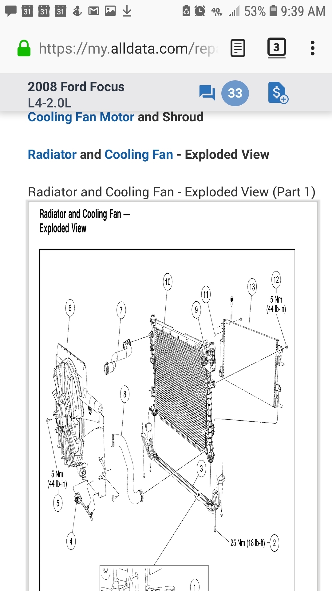

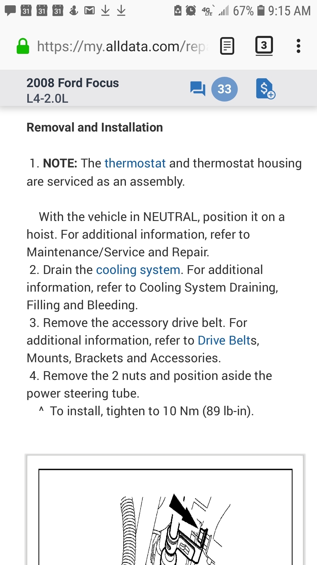

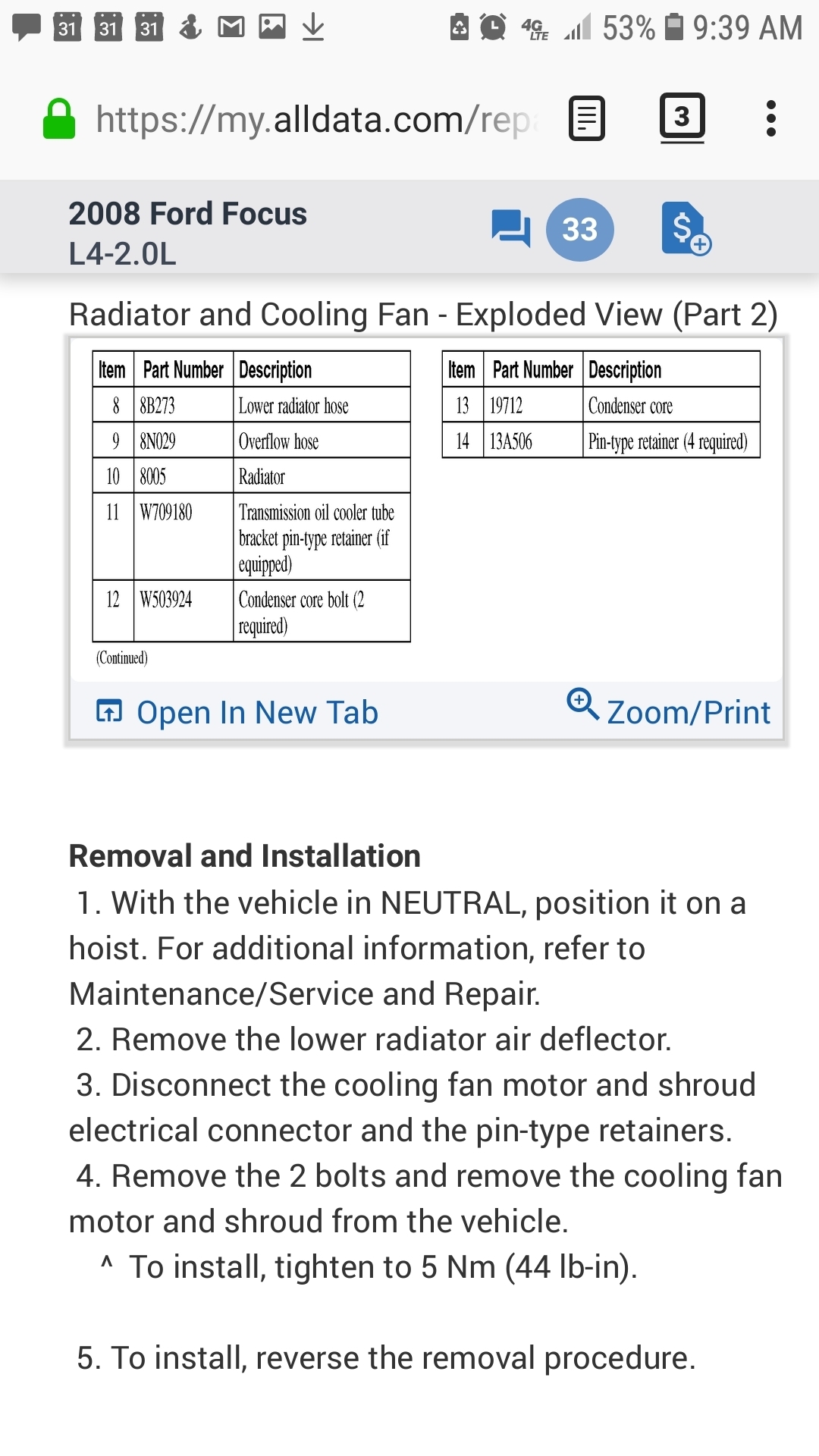

Hello and welcome to 2CarPros. If you can see/hear the electric cooling fan running without the AC running, then I'd bet on a bad thermostat. I'm attaching Alldata's information on how to replace it in the images below. Start there and follow up on this thread and we'll go from there.
Hope this helps!
