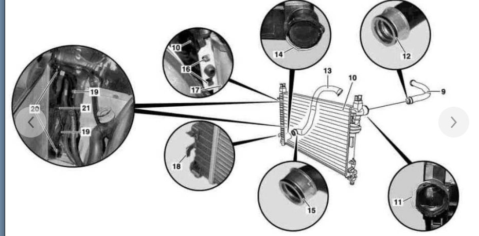

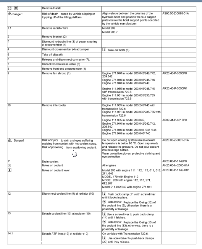

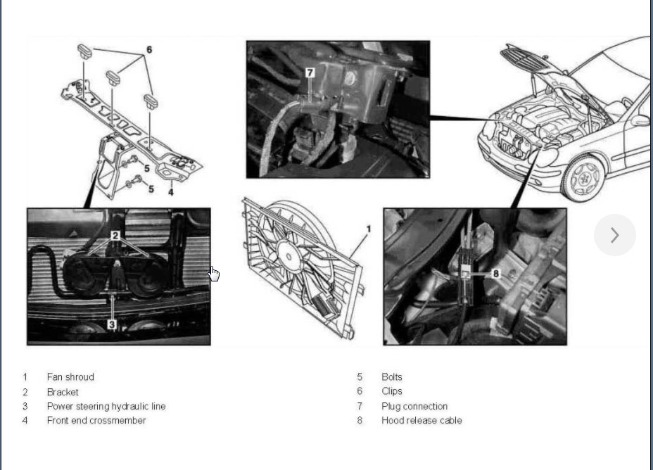

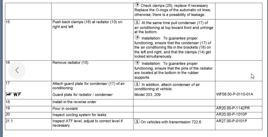

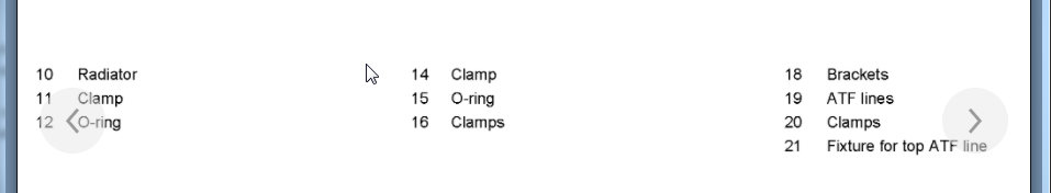

I am attaching the process from the manual on how to install these components and it shows diagrams of how each go together.
