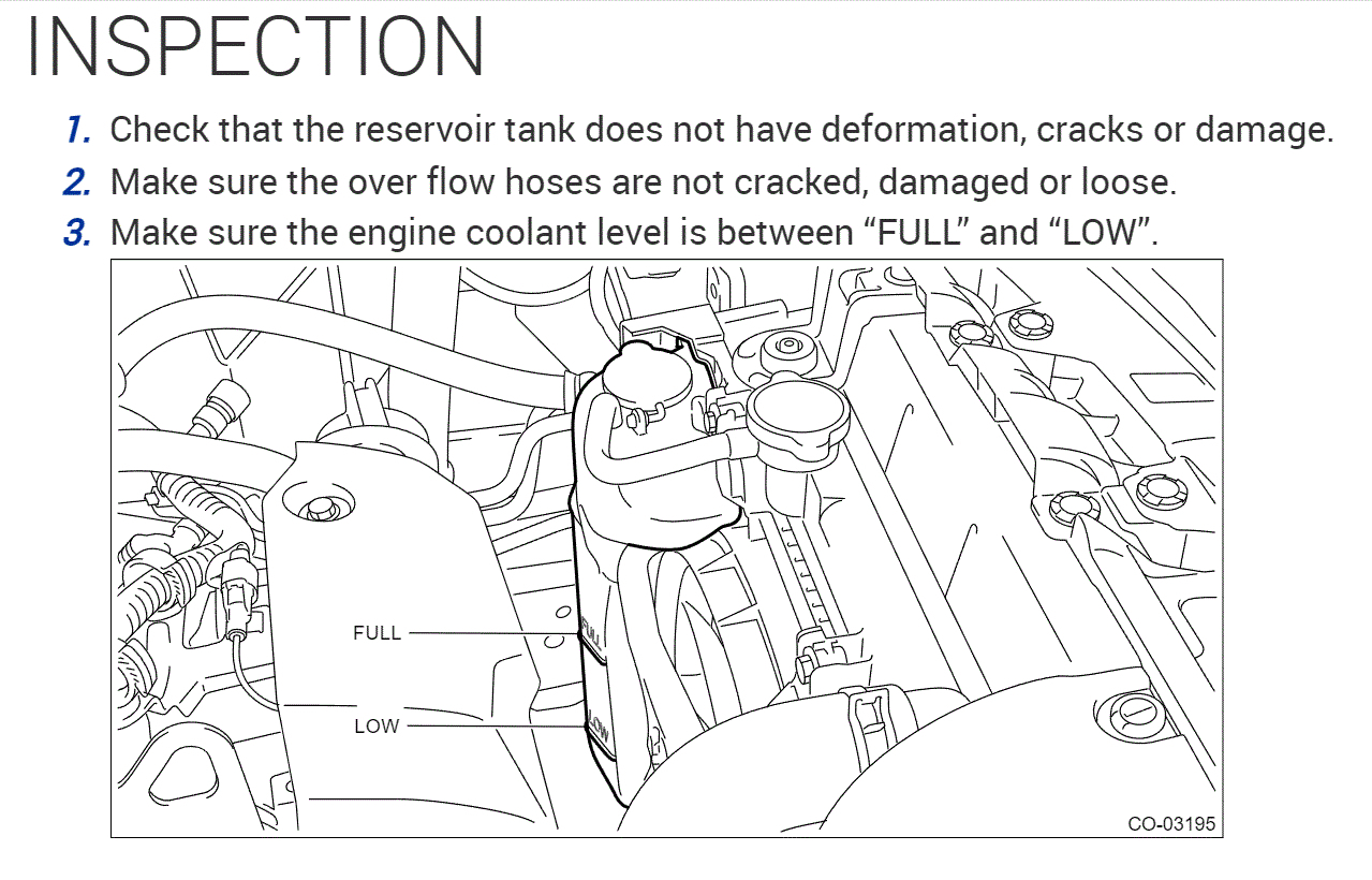

The first thing I recommend is to confirm the vehicle isn't low on coolant. See pic 1 below.
Even if the reservoir is full, when the engine is cold, remove the radiator cap and make sure it is full as well.
If the coolant is full, I recommend returning it. I'm not sure how bad the accident was, but it could be a wiring issue.
Let me know what you find when checking the coolant. Remember, do not open the radiator cap when the engine is hot or warm. Wait until it fully cools off.
