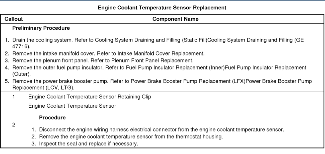

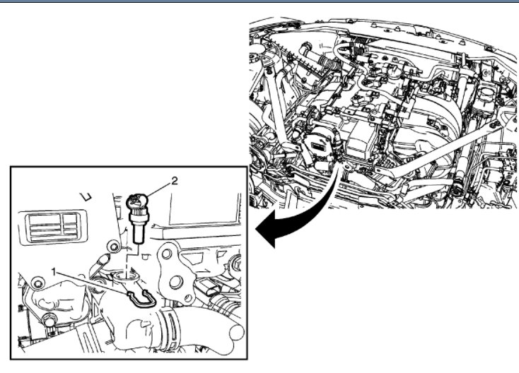

Yes, that sounds like you could be having an issue with the coolant temperature sensor. Here is a tutorial for you to view on the sensors replacement:
https://www.2carpros.com/articles/symptoms-of-a-bad-coolant-temperature-sensor
https://www.2carpros.com/articles/coolant-temperature-sensor-cts-replacement
I've attached 2 pictures below of the location and steps for replacement for your car. Hope this helps and thanks for using 2CarPros.
