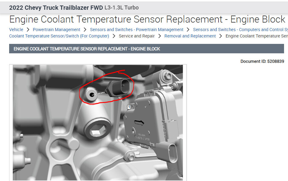

There is more than one. One is used by the engine's computer (PCM) to control the air/fuel mixture (screwed into the engine block), and there is one in the radiator for the cooling fan operation.

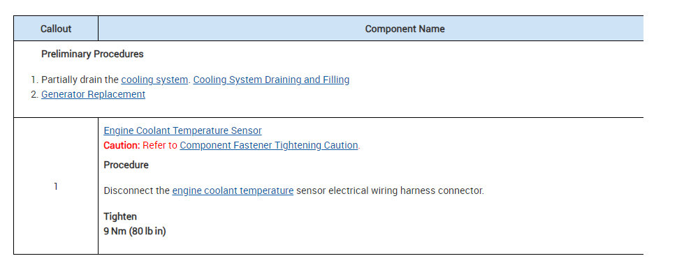

It is really easy to replace. You will need to drain the coolant to below the height of the sensor so coolant isn't lost. Then it is nothing more than disconnecting the electrical connector and using a deep well socket, unscrewing the sensor, and screwing the new one in place.
If you want to do it yourself, I'll be here to help if needed. Also, if you tell me the symptoms you are experiencing, I can better point you in the right direction of the sensor in question.

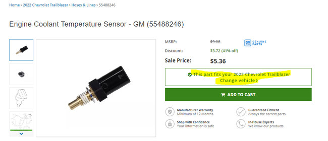

See pics below.
