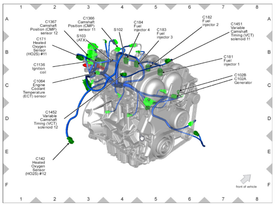

location coolant temperature sensor. Check out the diagrams (Below). Please let us know if you need anything else to get the problem fixed.

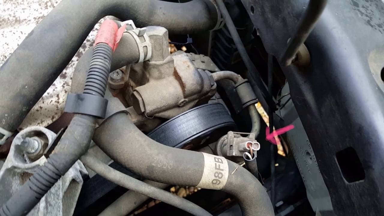

Below you will find the location attached to this post so that you are able to find it. It is on the back side of the engine but should be accessible.
Let us know if you have other questions. Thanks
