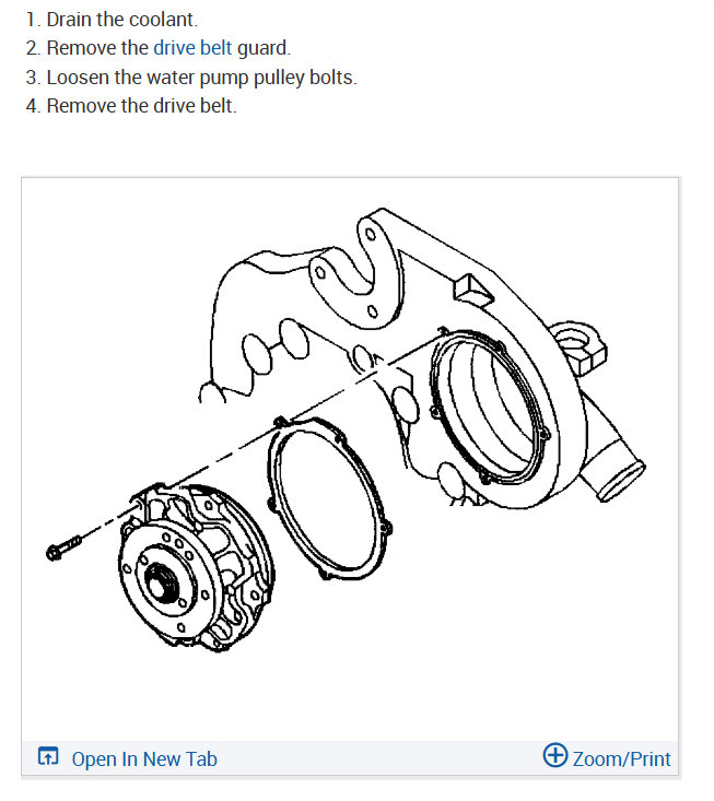

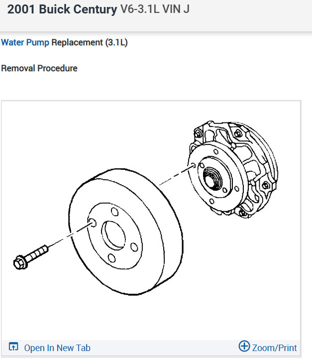

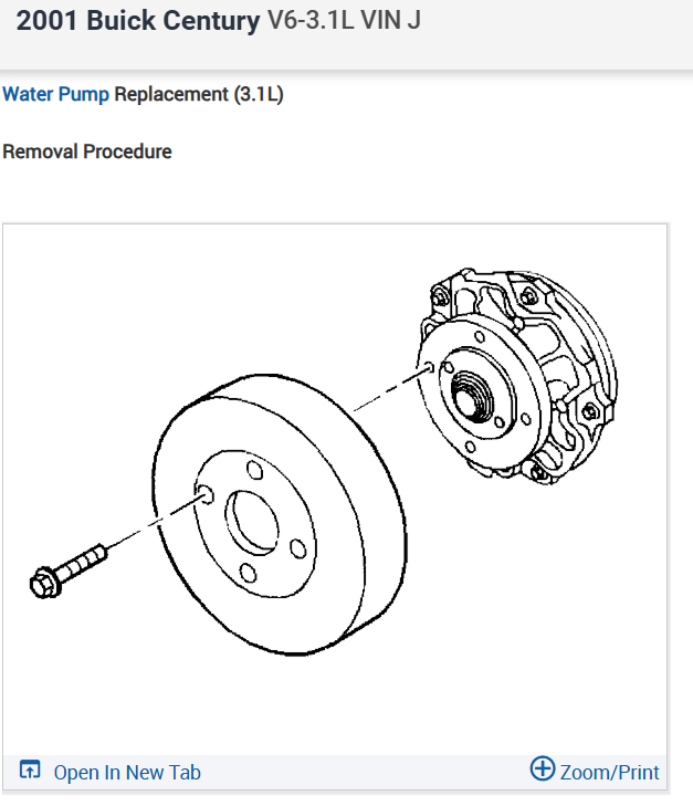

I have seen the water pump impeller become loose or rust out causing this problem. With the thermostat out and the upper radiator hose off you can start the engine for a second to see if coolant is pumped out, have a drain basin ready to catch the coolant. Check out the images (below). Please upload pictures or videos in your response of any problems so we can see what to help you with.
