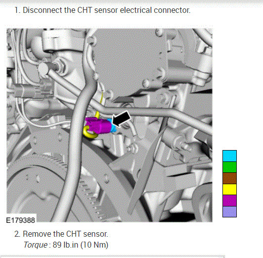

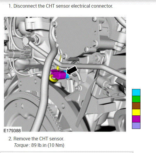

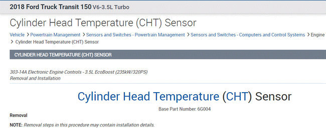

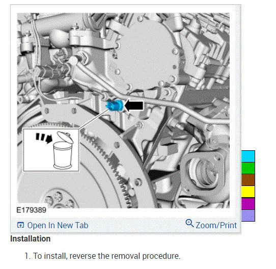

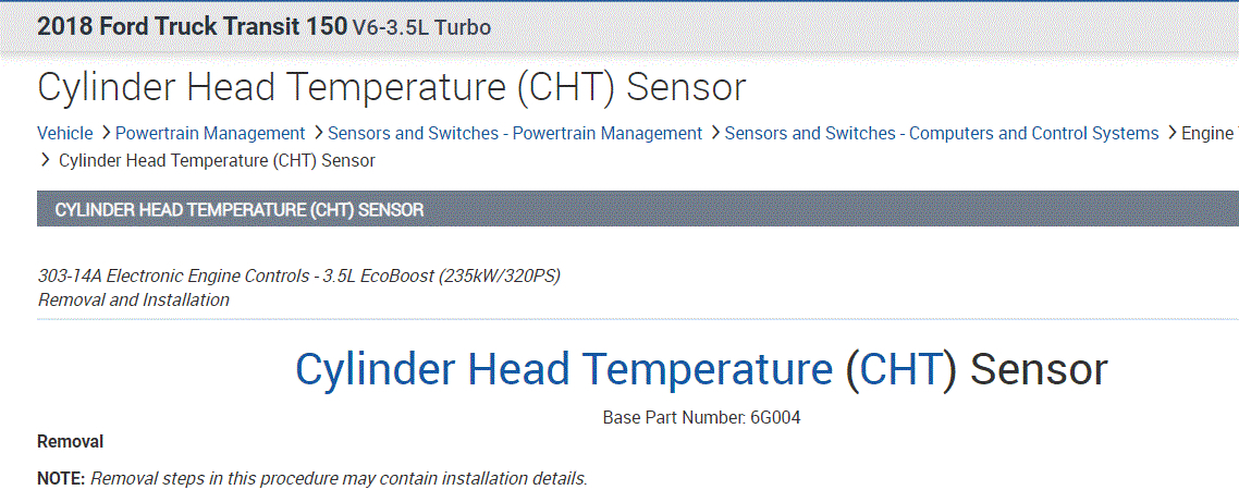

This vehicle has a cylinder head temperature sensor (CHT). The sensor is located on the rear of the right cylinder head.
If you look at the attachments below, they provide the directions for removal and replacement.
I hope this helps. Let me know if you have other questions.
See pics below.
