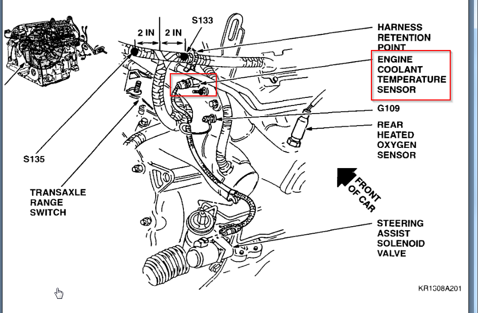

I need location of engine coolant sensor.
Apr 19, 2020 at 7:38 PM

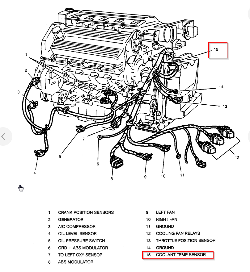

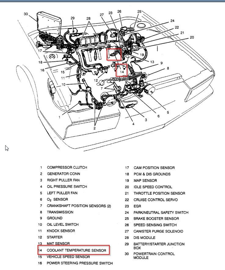

I attached a couple of views of it. Looks like it is just under the throttle body on the front of the engine. Let me know if you still can't find it and we can see about getting more detail. Thanks
