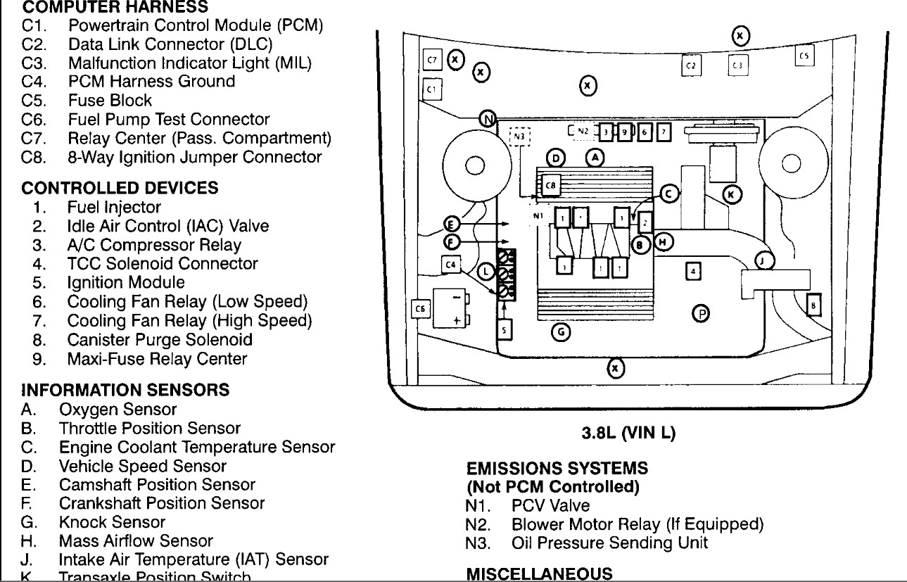

Where is the engine coolant sensor located on a 1995 Buick lesabre

Here is the location of the engine temperature coolant sensor. Check out the diagrams (Below). Please let us know if you need anything else to get the problem fixed.

Thanks, do I need to remove the throttle body to replace?

you shouldn't have to
