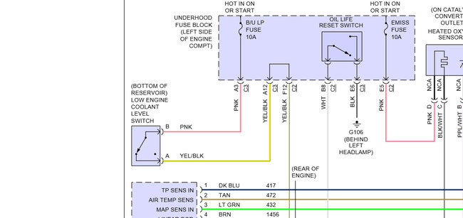

my engine coolant light is staying on. The reservoir is full. What can some of the causes be?

The switch for the coolant level is actually at the bottom of the coolant reservoir. So you may want to take a look at the bottom of the tank and see if the harness plug either fell off or if there is a wiring problem down there. The pink wire at the plug for the level switch is the power wire and the yellow/black wire is the wire that signals the ECM that the switch is closed and the reservoir is full. here is a wiring diagram to help to identify the harness plug down there. Should be very easy to find.
