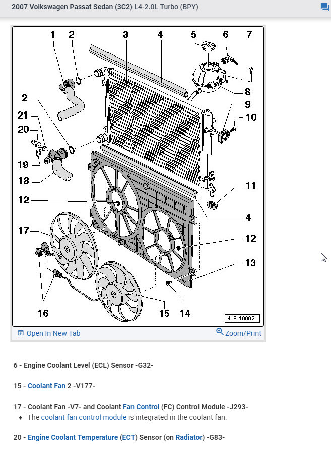

Where is it located?
Aug 25, 2019 at 8:56 AM
Hi Treveor,

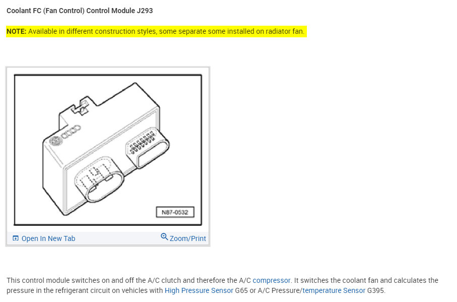

Please see the attached information for the location of this module. Let me know if you need anything else. Thanks
