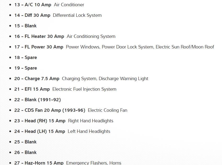

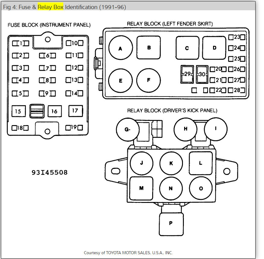

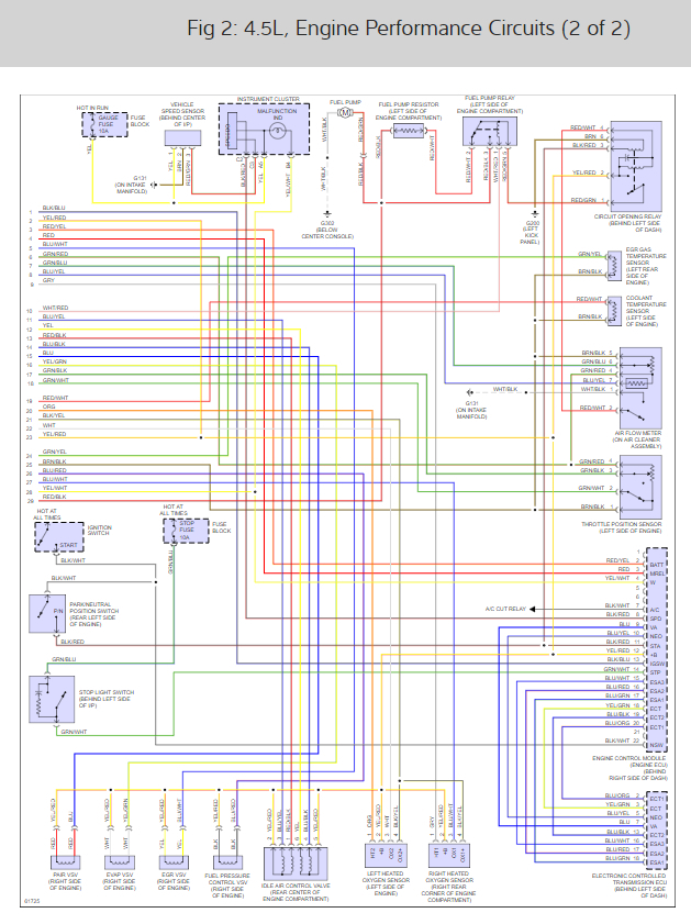

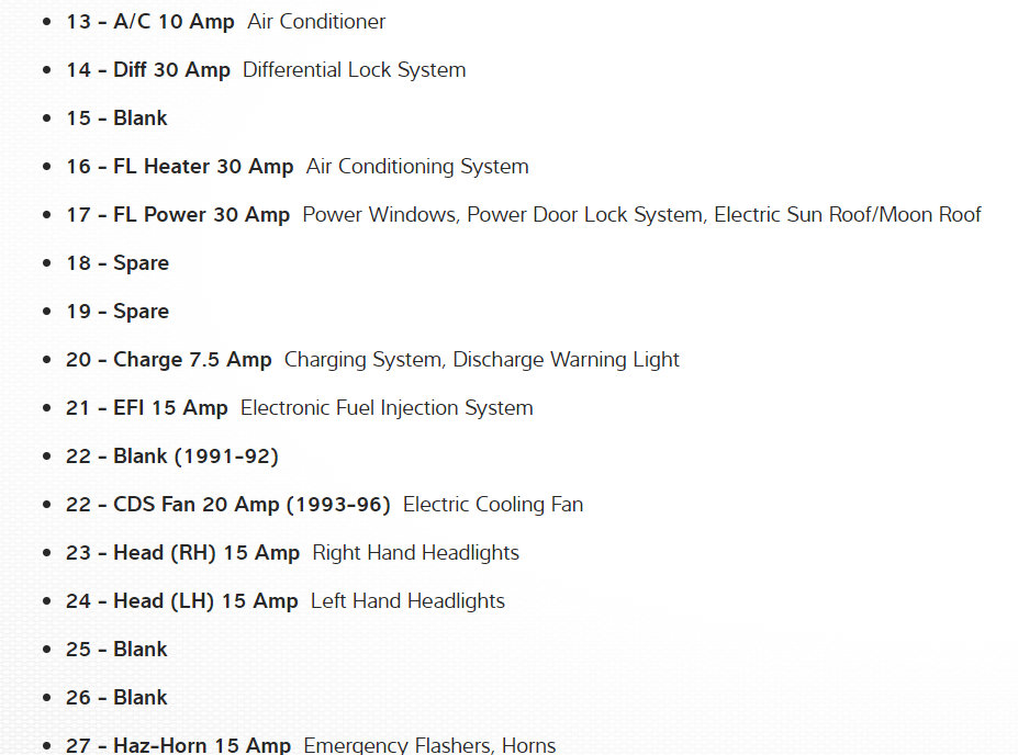

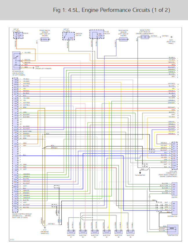

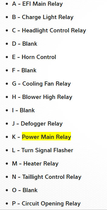

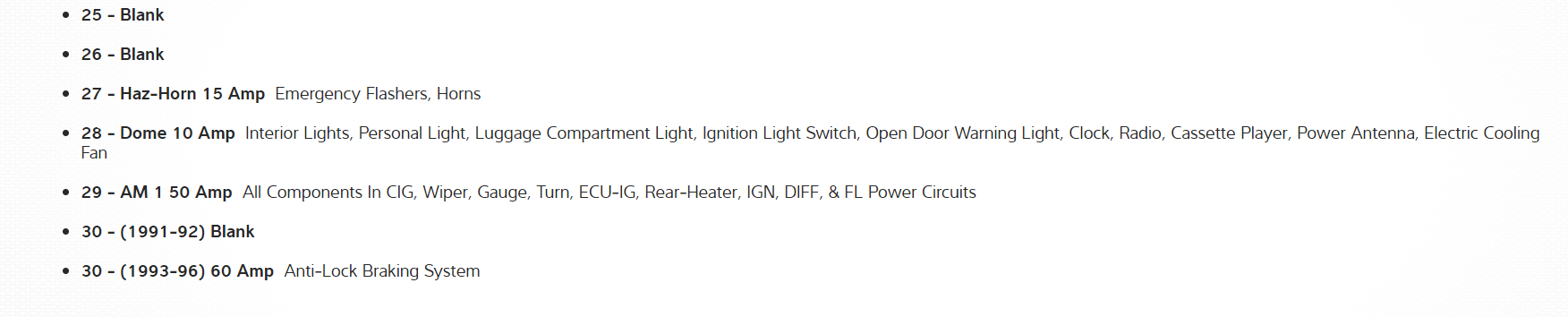

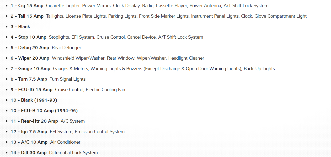

Yes it should be but if the computer has no power or ground it will never work. I would check the circuit open and EFI relay.
and
Here is the location of the relay and the engine wiring diagrams to help you run down the power and ground. Check out the diagrams (below). Let us know what happens and please upload pictures or videos of the problem.
