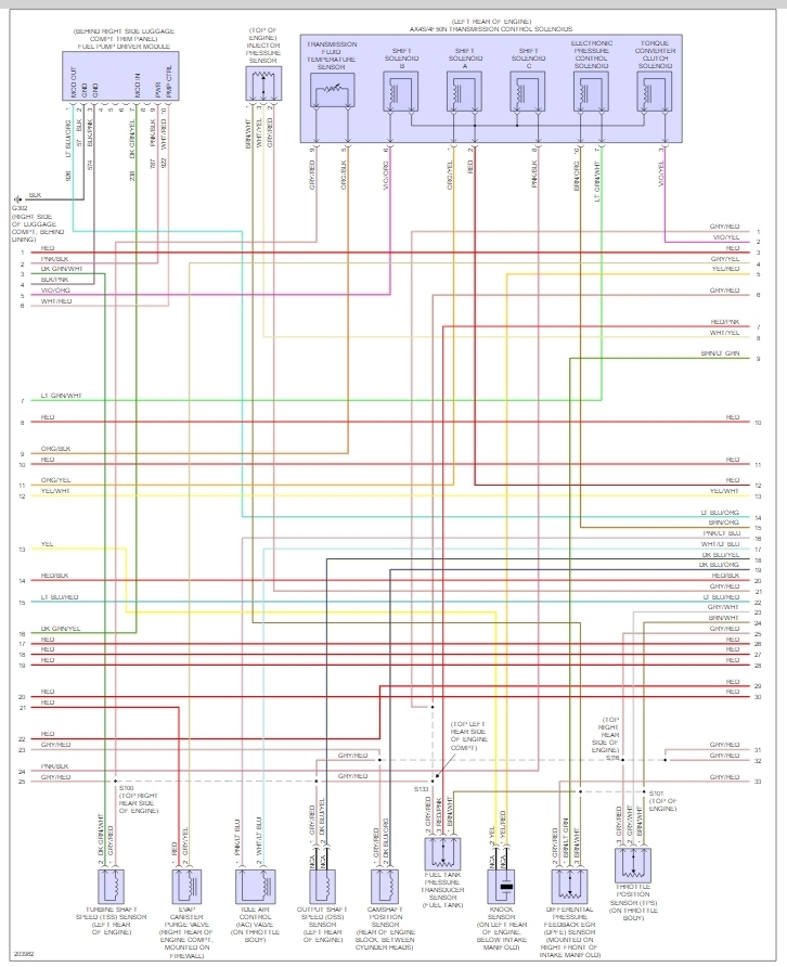

I did all the above changes plus installed a refurbished ECM by Cardone. The car is now running and drivable but the IACV is still not working correctly so I put some resistance in line and got the idle speed down to 1100 with AC off and car in neutral.
Now with the different computer, the shift points are higher than they should be, similar in the older cars to the TV rod being out of adjustment .
Mar 29, 2016 at 7:41 PM
Sometimes it takes time for the new computer to learn the transmission, here is a wiring diagram, you can see the wires come right off of the computer, have you done a pin to pin check?
Apr 4, 2016 at 1:34 PM
sorry here you go, please let me know.
Apr 4, 2016 at 1:35 PM
