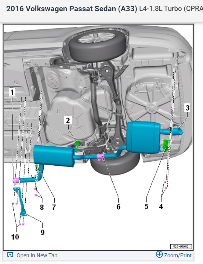

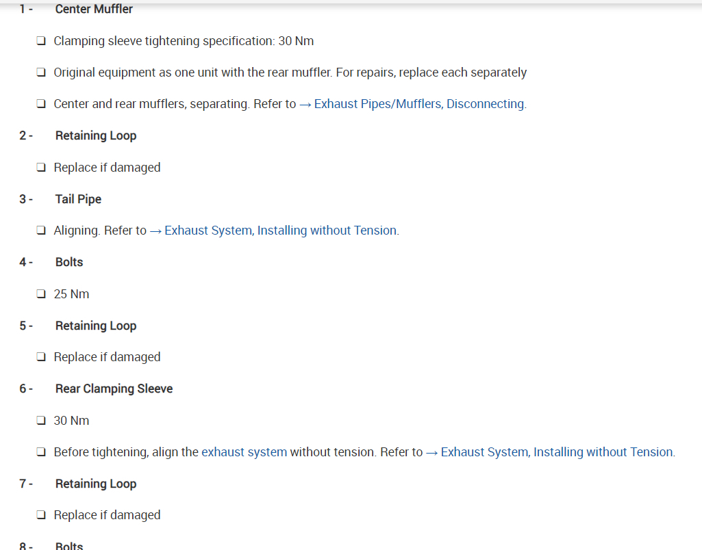

When accelerating in from low to mid (2,000-3,000) RPMs, can occasionally hear a very faint rattle for maybe half a second as it transitions to higher rpm (3500-4000). It is very quiet and barely noticeable. Sounds kind of like a panel slapping something. Or the clicking of gears on each other. Like I said though it is not constant and sometimes doesn't happen. No idea what it could be. Nothing is hanging from the undercarriage. Maybe engine mounts? Or something more internal?
