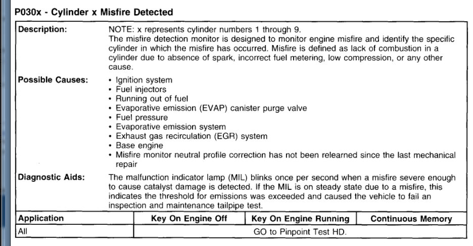

As for the issue, it appears you have a severe misfire that has damaged the o2 sensors. The two o2 sensor codes (p0030, p0130) are most likely a result and not the cause.
What have you done to address the misfire? If nothing, we need to start with this guide:
https://www.2carpros.com/articles/engine-misfires-or-runs-rough
I would suggest swapping things from one cylinder to another on the other bank. Start with the plug and then the injector. If the misfire moves to that cylinder then that is the issue.
Then we need to check the compression if it stays on number 3.
Let's run through this material and go from there.
