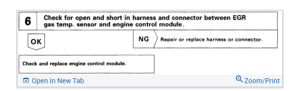

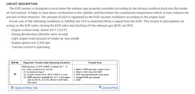

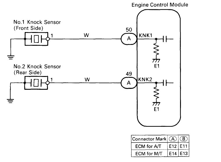

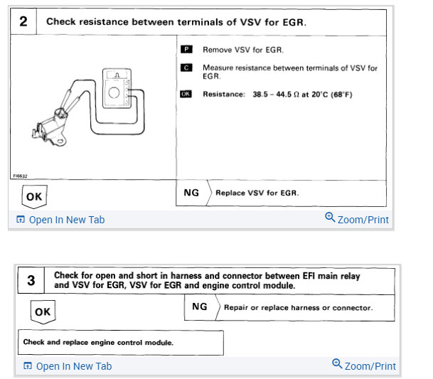

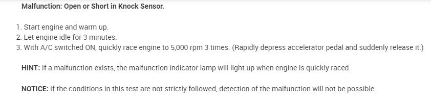

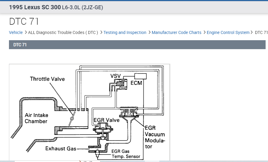

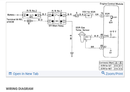

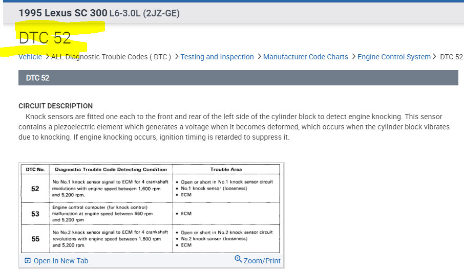

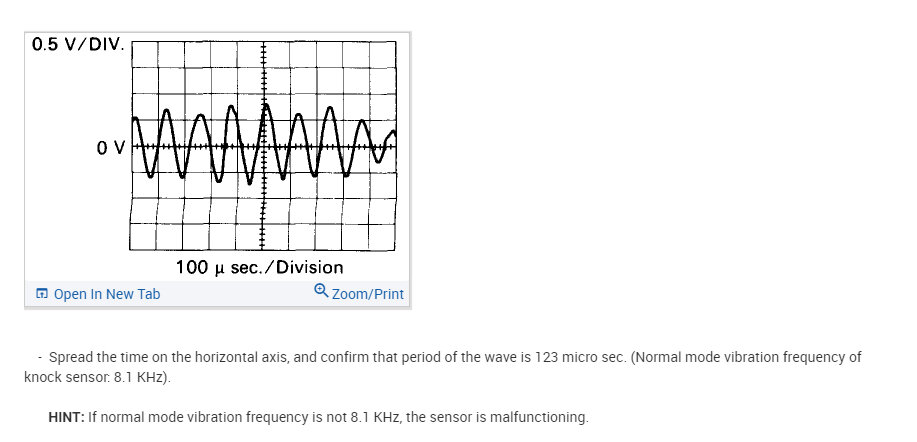

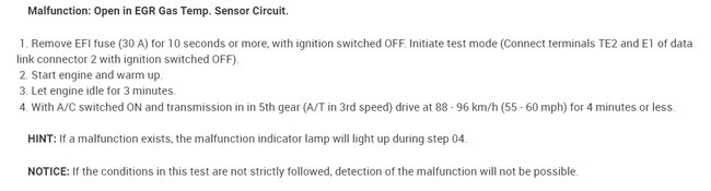

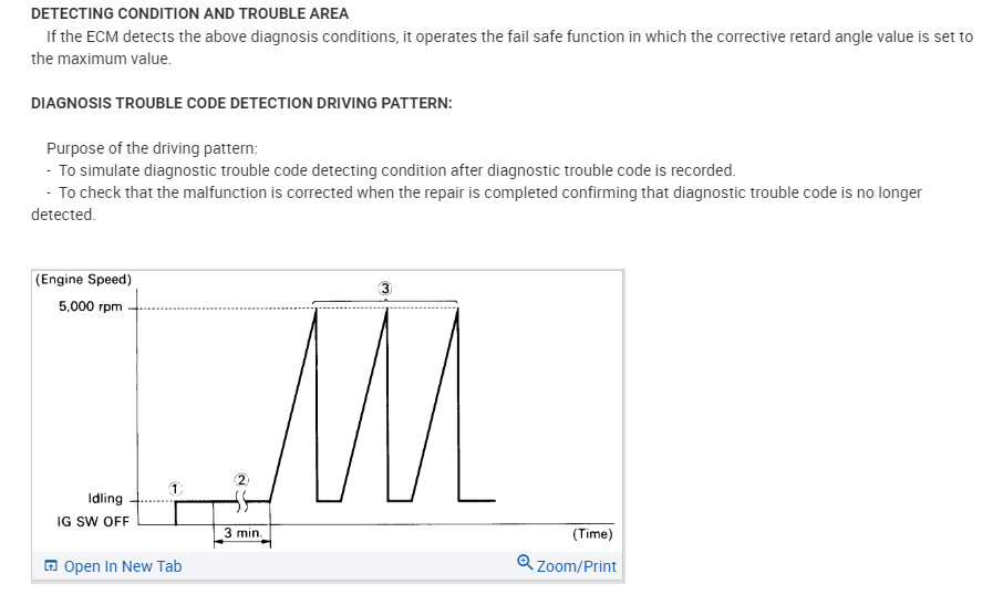

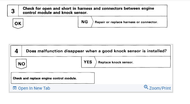

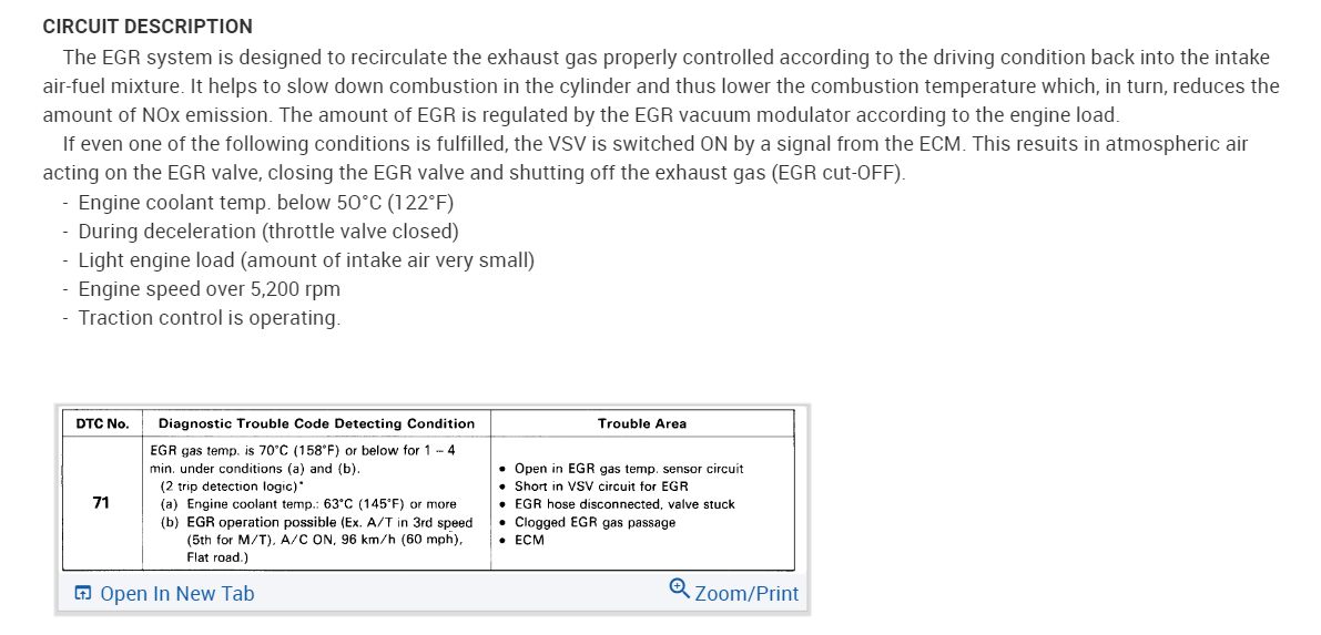

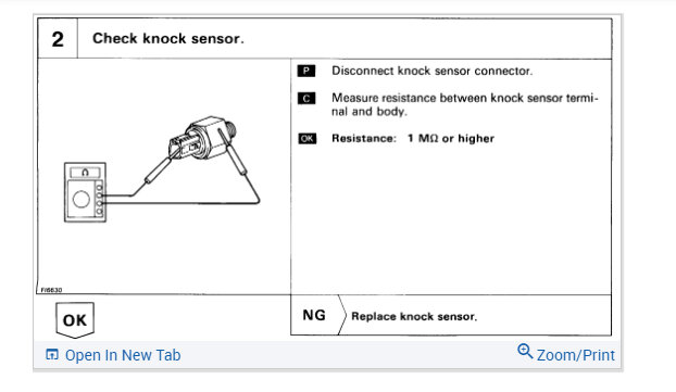

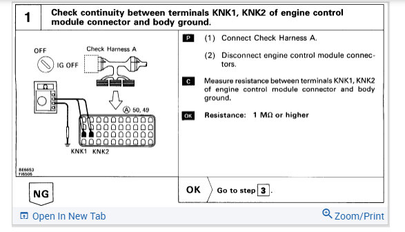

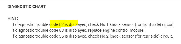

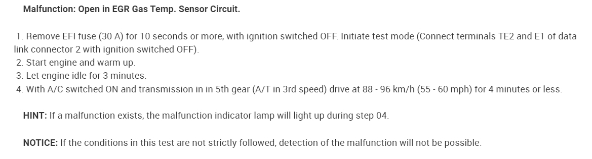

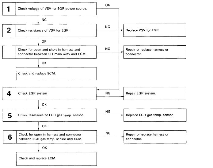

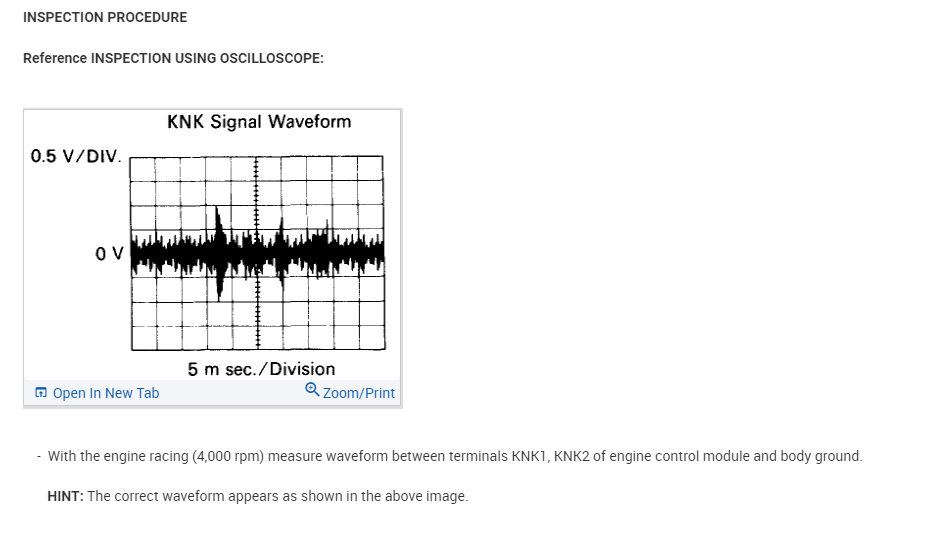

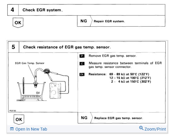

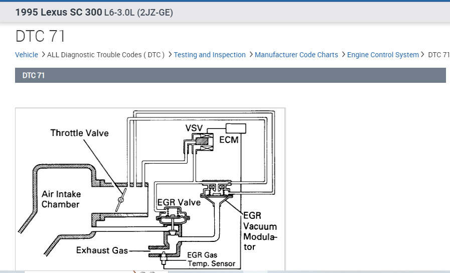

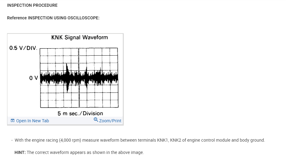

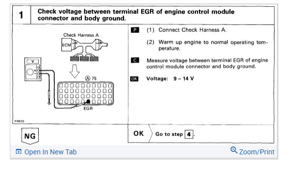

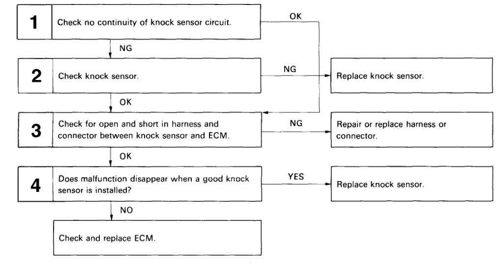

Code 52 is related to the engine knock sensor and the 71 is tied to the EGR system.

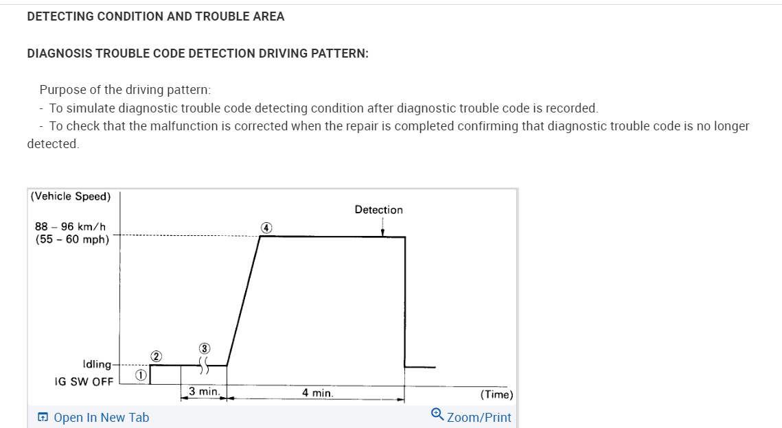

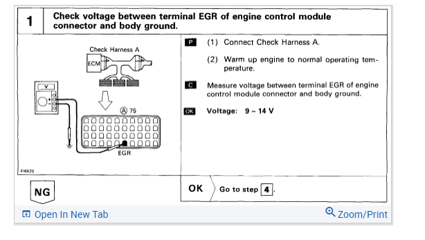

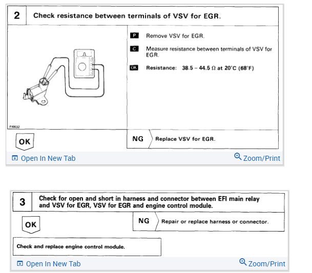

So, I need to know how the vehicle is running. If it idles smoothly, I would suggest starting with the 52 code. If the vehicle has a rough idle, then start with the 71.
Let me know. If you want, I have attached the diagnostics for both below for you. Take a look through them and let me know if you are comfortable performing them.
See pics below.

Thanks for the info. Based on a high idle, I suspect the problem is related to the EGR. Are you comfortable performing the diagnostics I attached above?
Also, take a look at this link and let me know if anything helps:

Hey thanks Joe, and I should be able to preform those diagnostics above. I will definitely let you know if anything changes.

I replaces the EGR as it was bad, and the light went away. Although, the idle problem still exists. It will fast idle at about 3-4k rpm and remain that way even after the engine reaches operating temperature.
