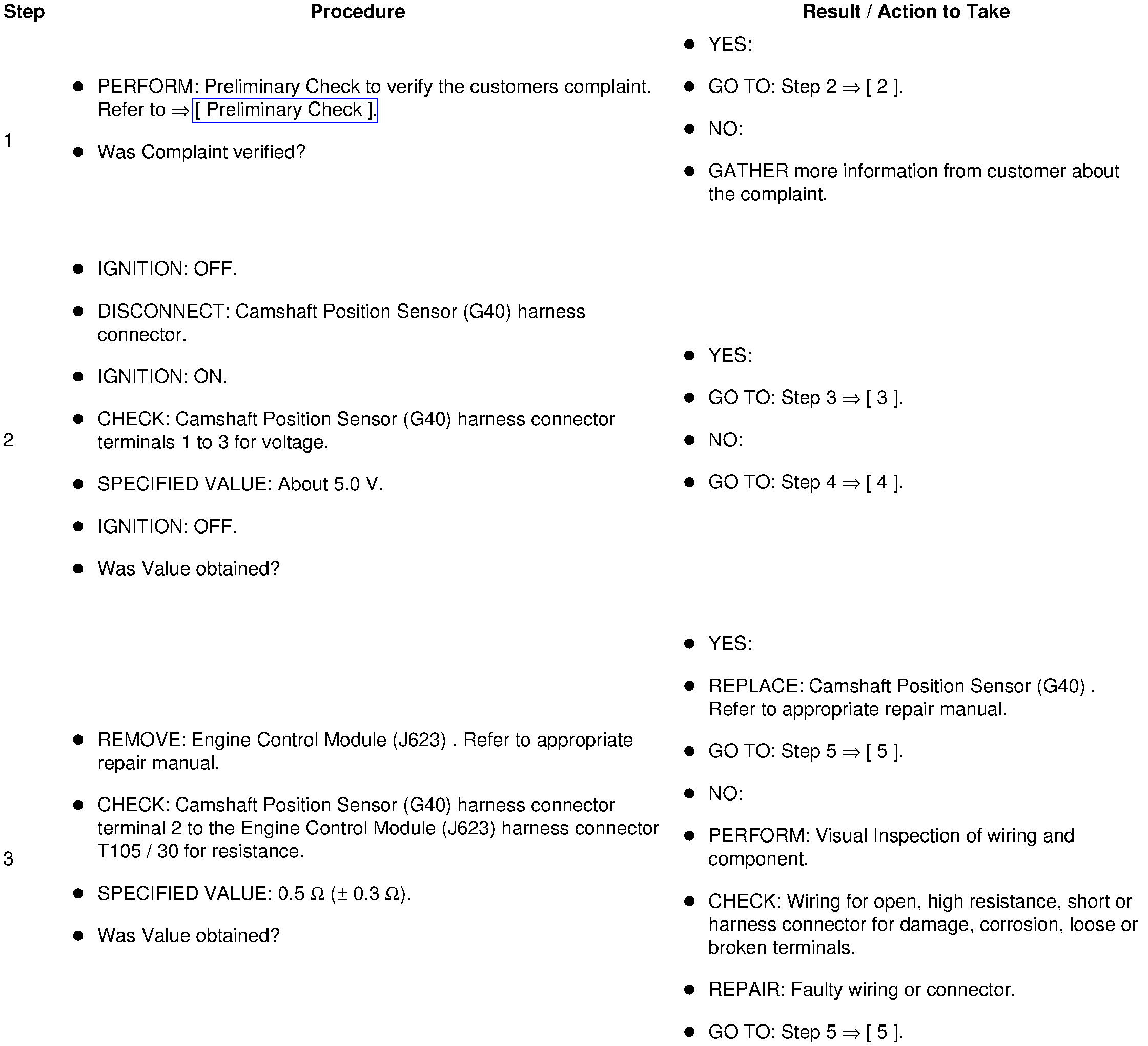

CAMSHAFT POSITION SENSOR (G40), CHECKING
Camshaft Position Sensor (G40), Checking
General Description
Using the signal from the Camshaft Position Sensor (G40) , the precise position of the camshaft relative to the crankshaft is determined very quickly when the engine is started. Used in combination with the signal from the Engine Speed Sensor (G28) , the signal from the Camshaft Position Sensor (G40) allows the Engine Control Module (J623) to detect which cylinder is at TDC. The fuel can be injected into the corresponding cylinder and ignited.
Special tools, testers and auxiliary items required
Multimeter.
Wiring Diagram.
Scan Tool.
Test requirements
Fuses OK.
Battery voltage OK.
Switch OFF all electrical and electronic accessories.
Vehicles with Auto. Transmission, ensure Selector Lever position is in "P".
Vehicles with Man. Transmission, ensure Shifter Lever position is in "N" with Parking Brake applied.
Coolant Temperature: 80° C.
Observe all safety precautions: [ Safety Precautions ] See: Computers and Control Systems > Technician Safety Information > Generic Scan Tool.
View clean working conditions: [ Clean Working Conditions ] See: Computers and Control Systems > Technician Safety Information > Generic Scan Tool.
For Hybrid vehicles refer to: [ High Voltage System General Warnings ] See: Computers and Control Systems > Technician Safety Information > High Voltage System General Warnings.

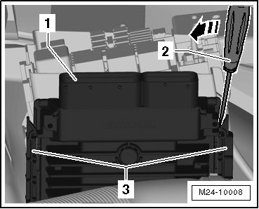

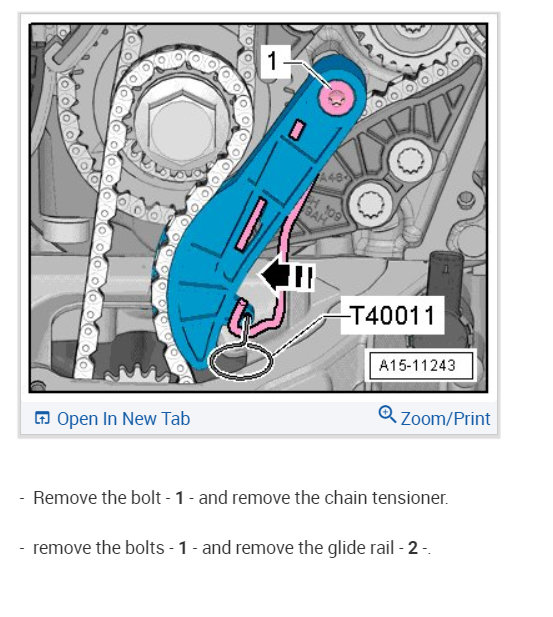

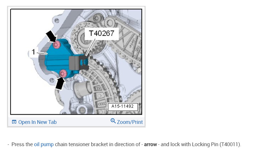

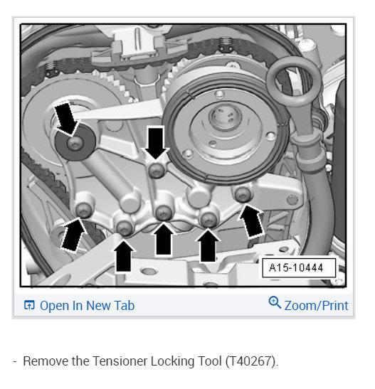

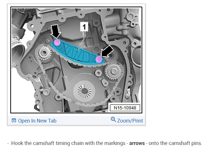

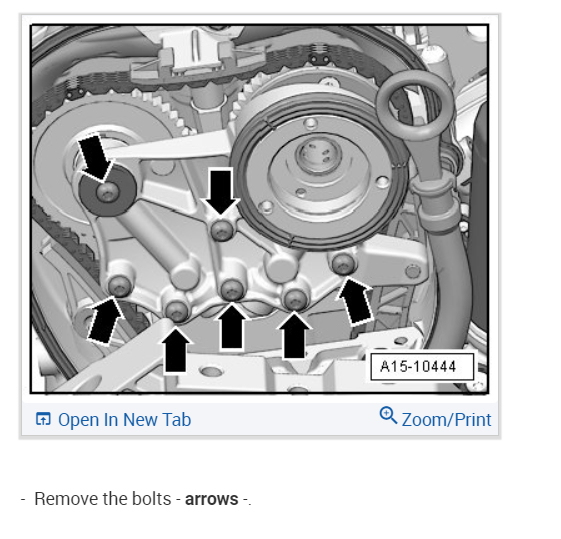

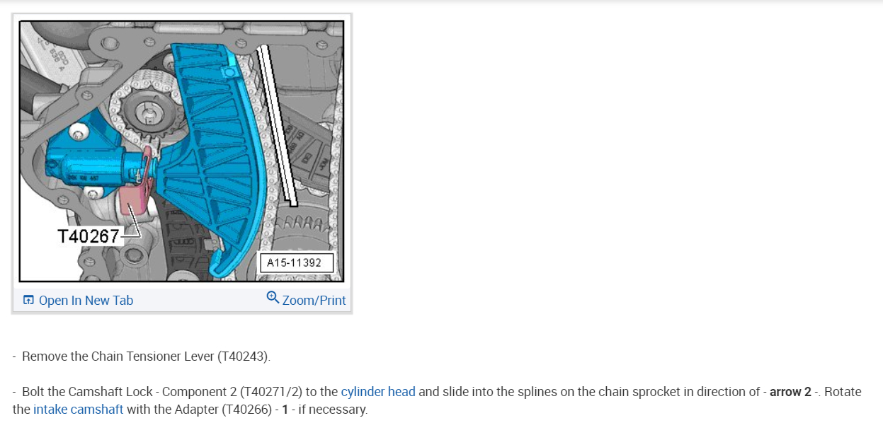

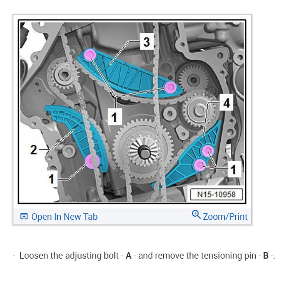

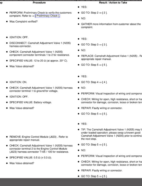

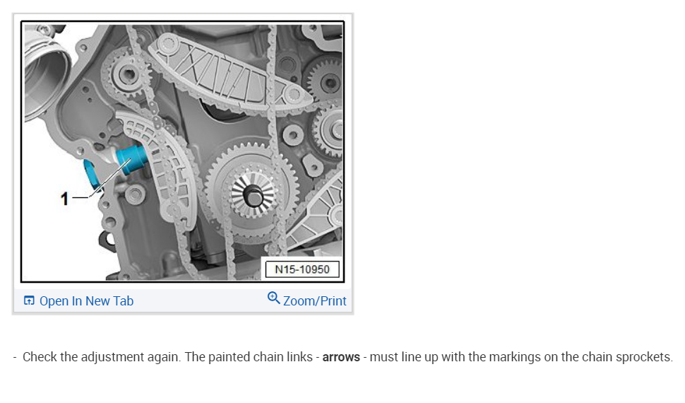

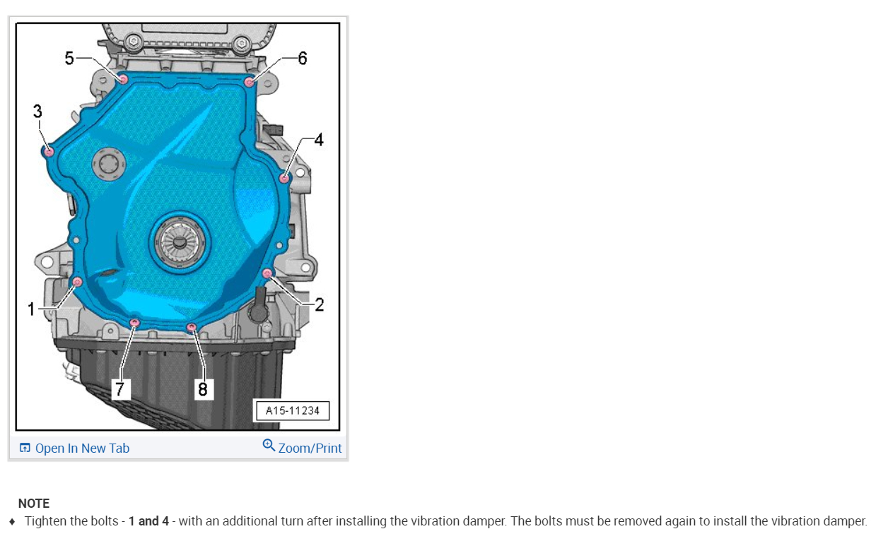

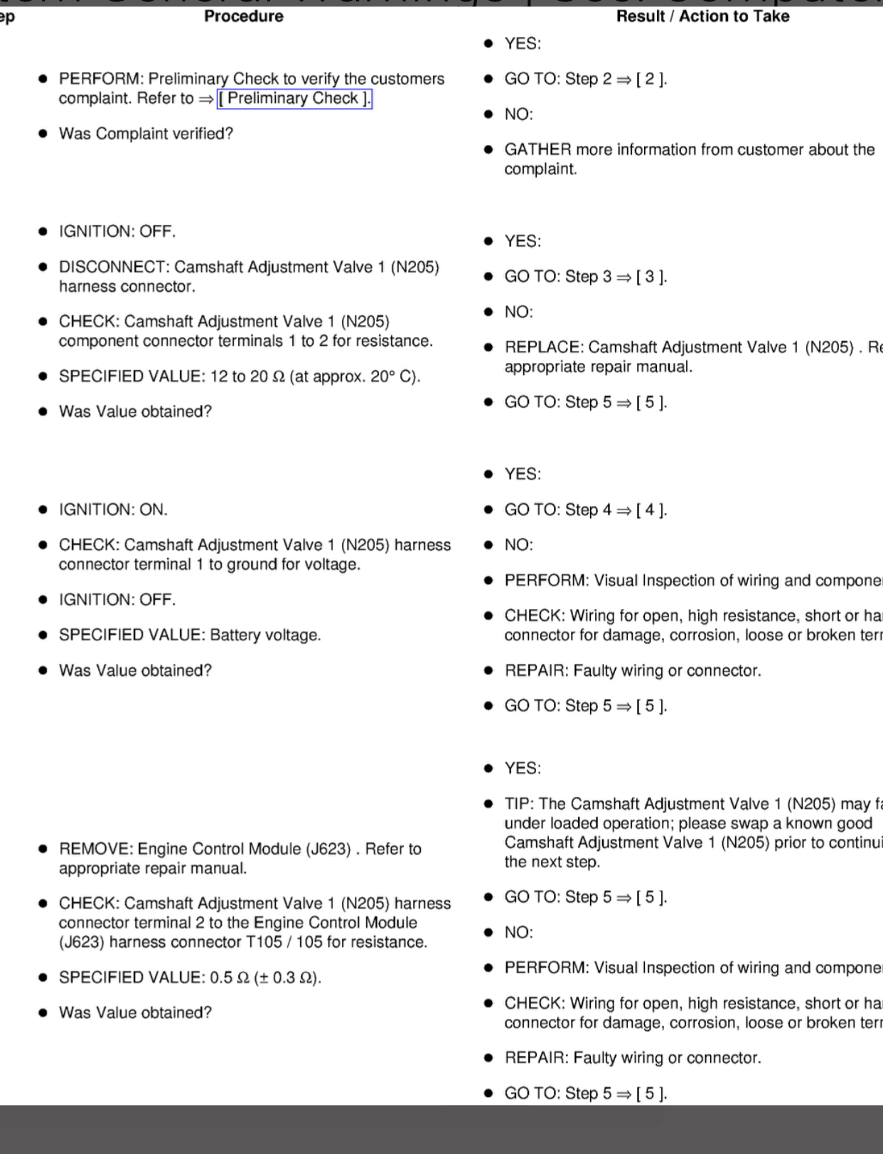

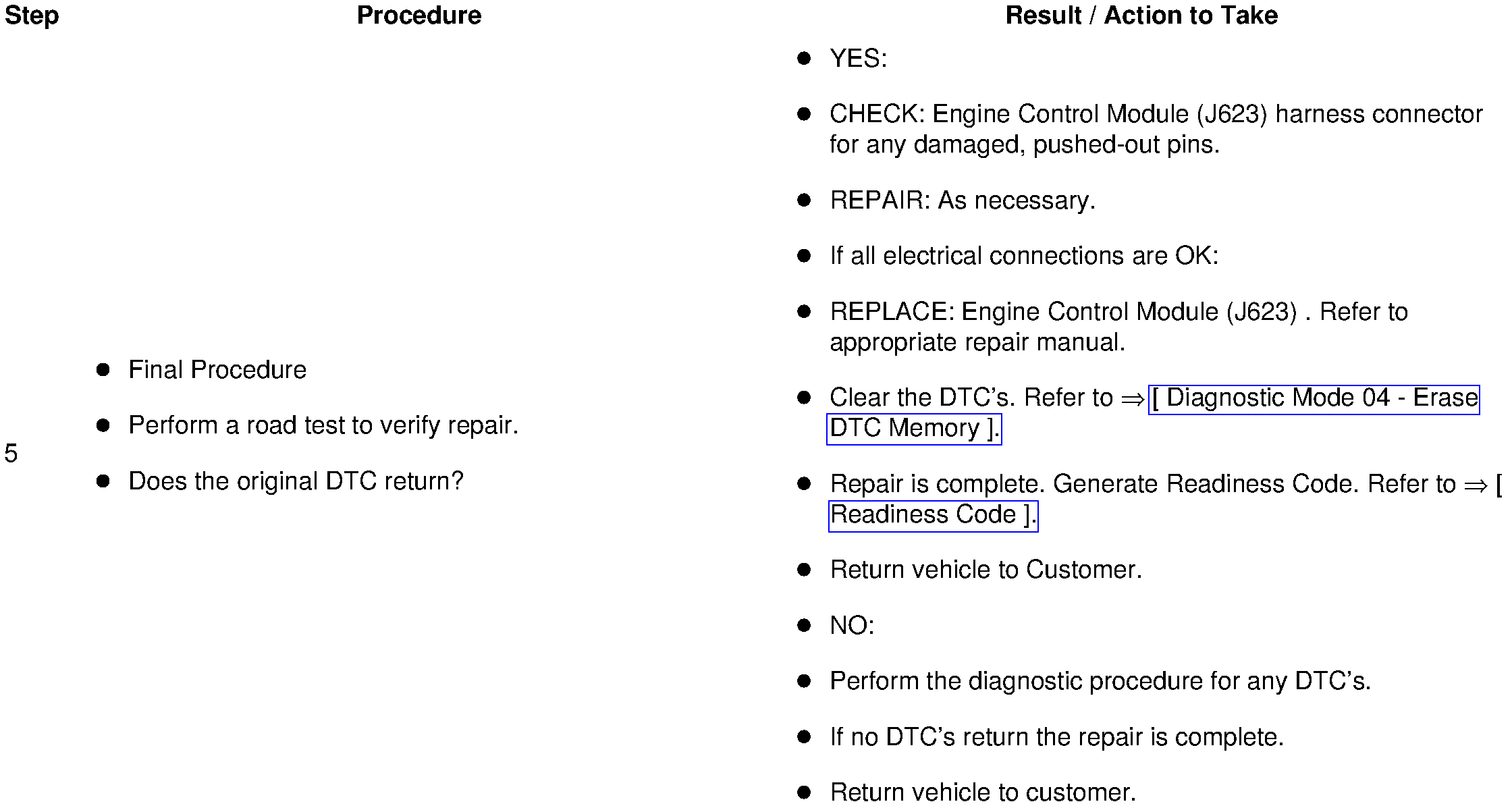

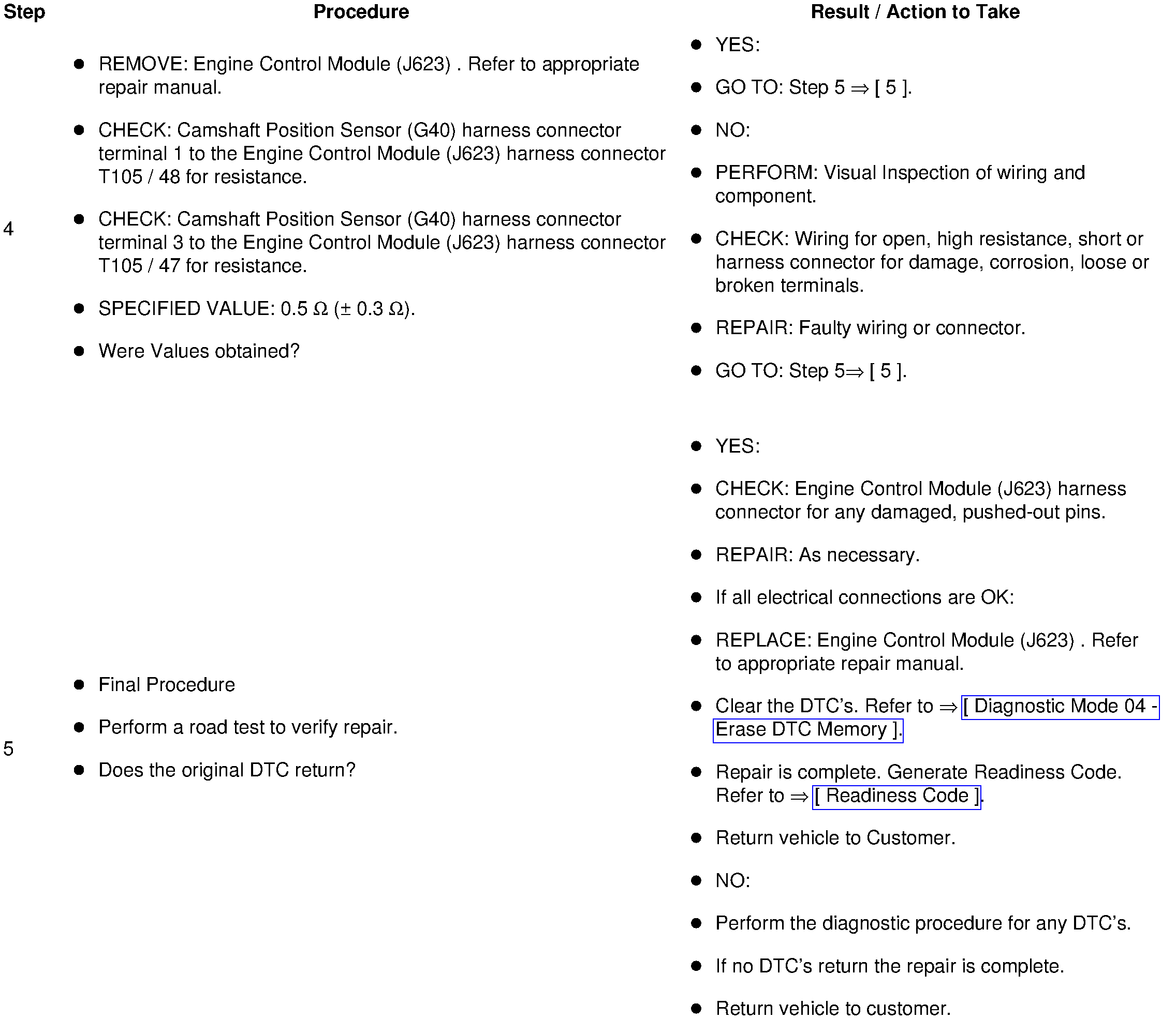

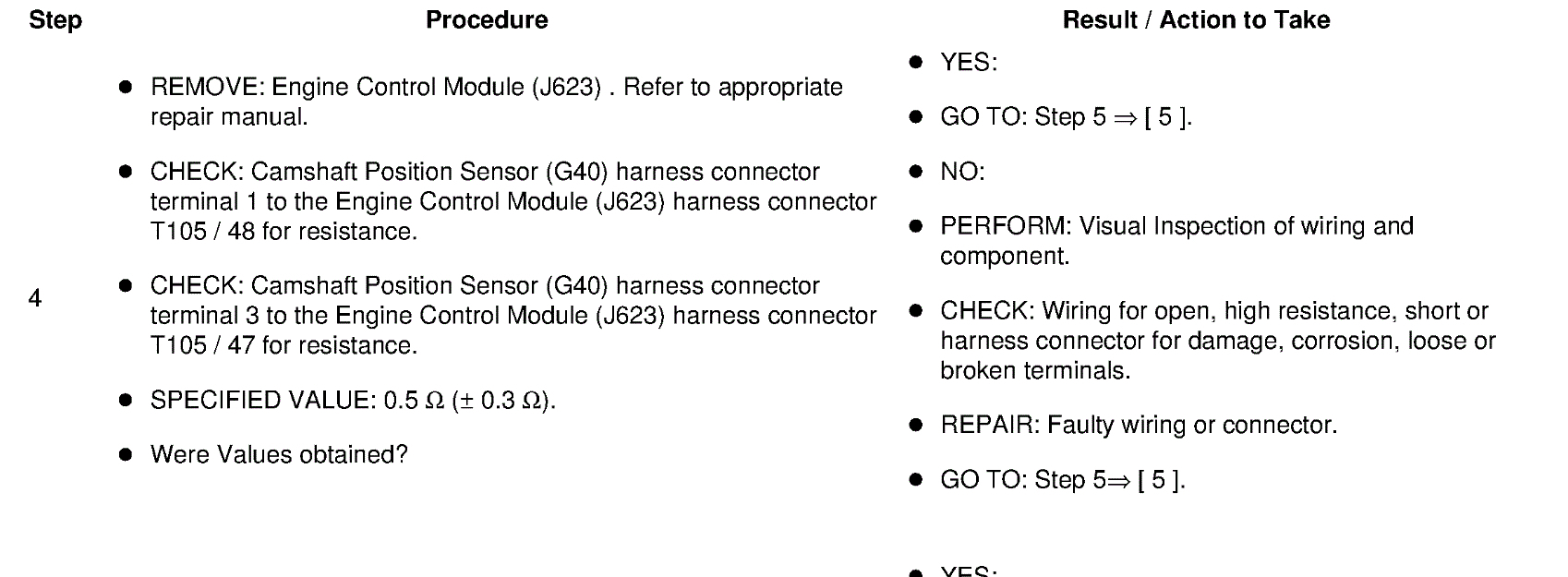

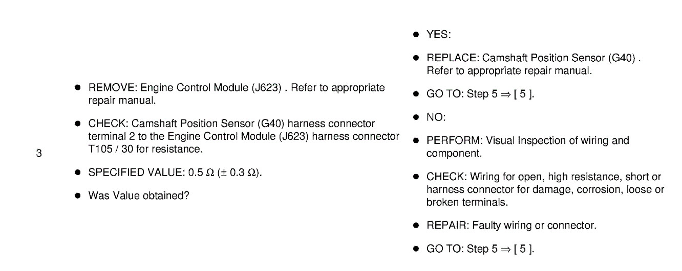

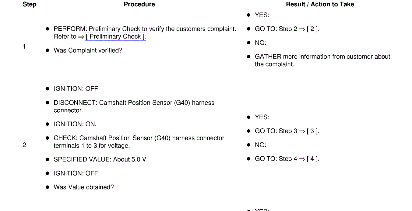

Test Procedure
pic 1

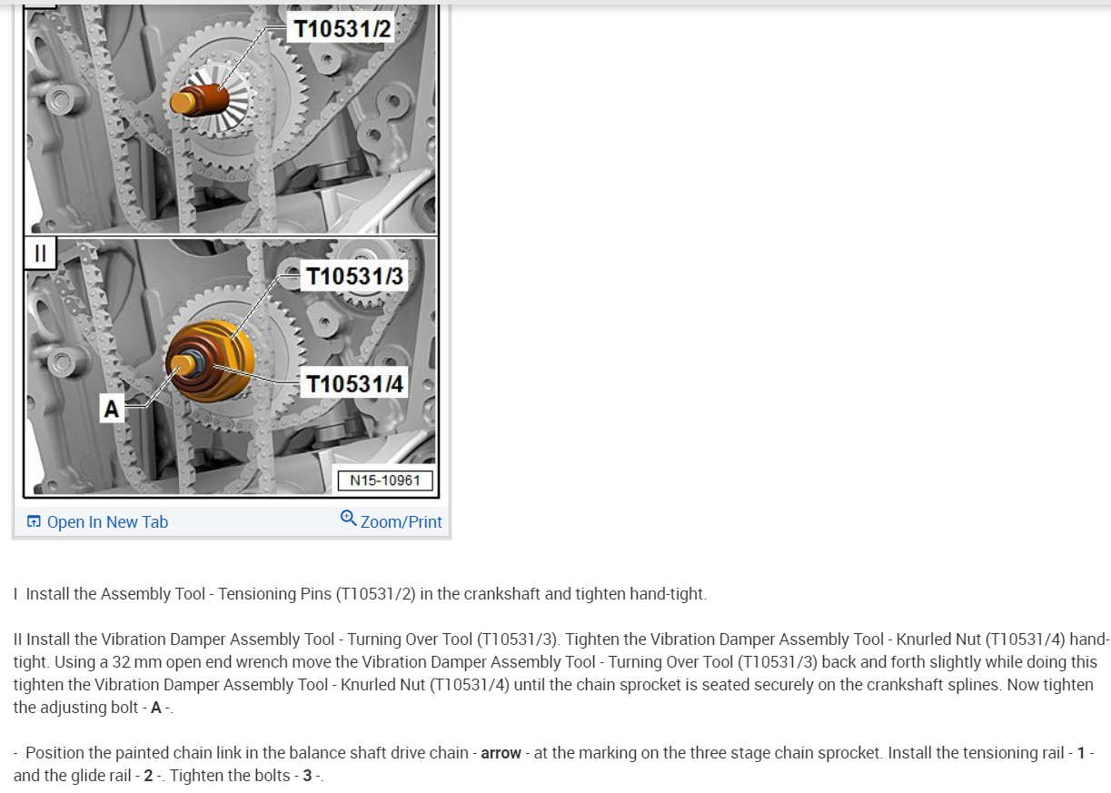

pic 2
______________________
Let me know if you get these.
