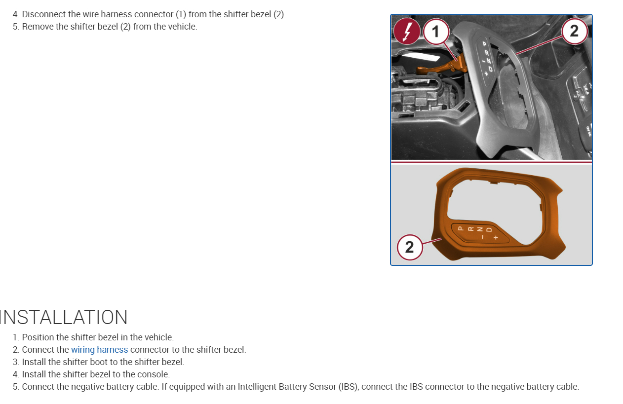

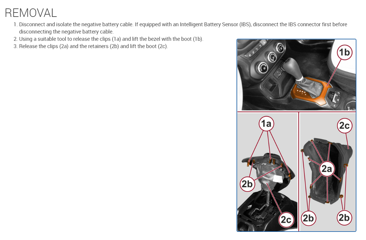

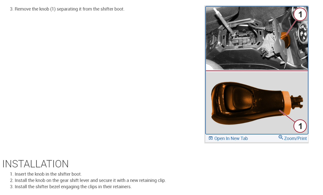

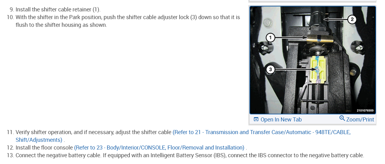

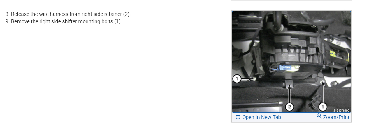

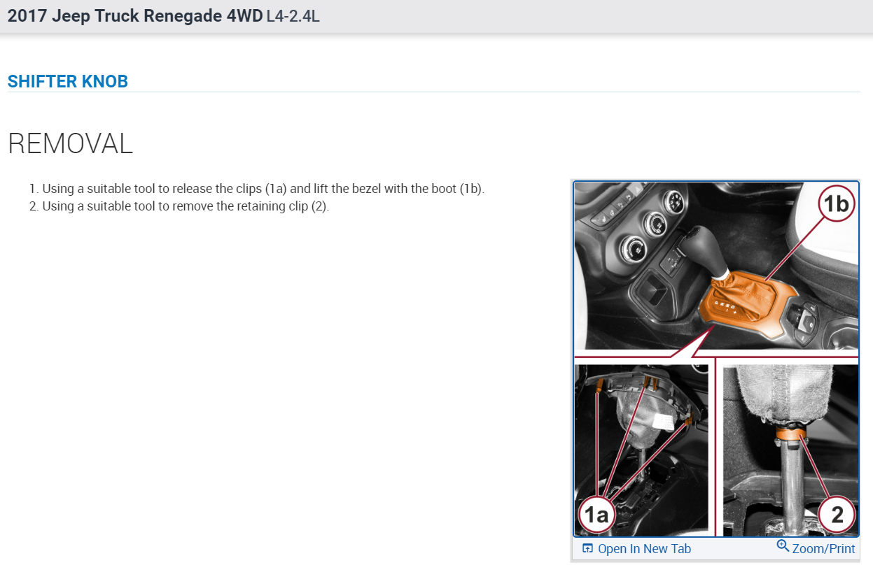

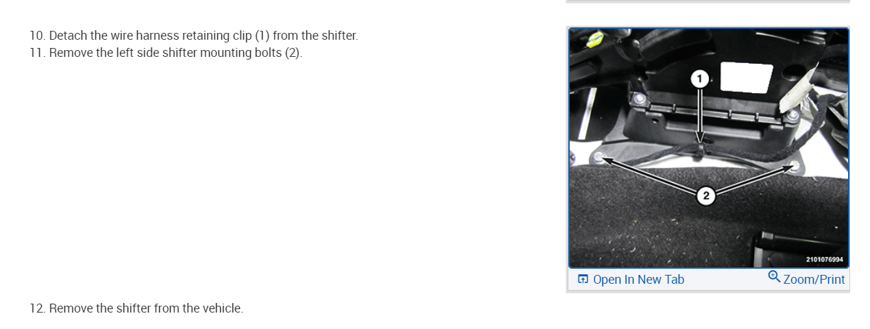

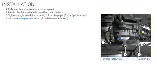

This vehicle is my daughters, and it was acting funny shifting and stuff. I put my OBD Scanner on it and came up with a P0820, which confirms a shifting issue to me. To address this kind of repair, is it something that I can get into?
