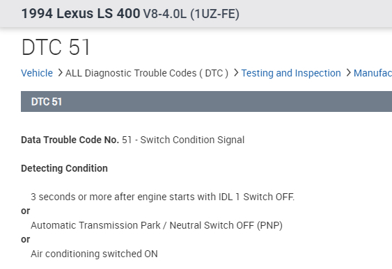

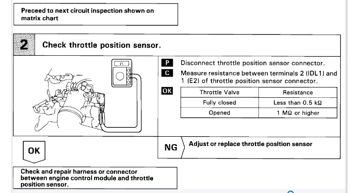

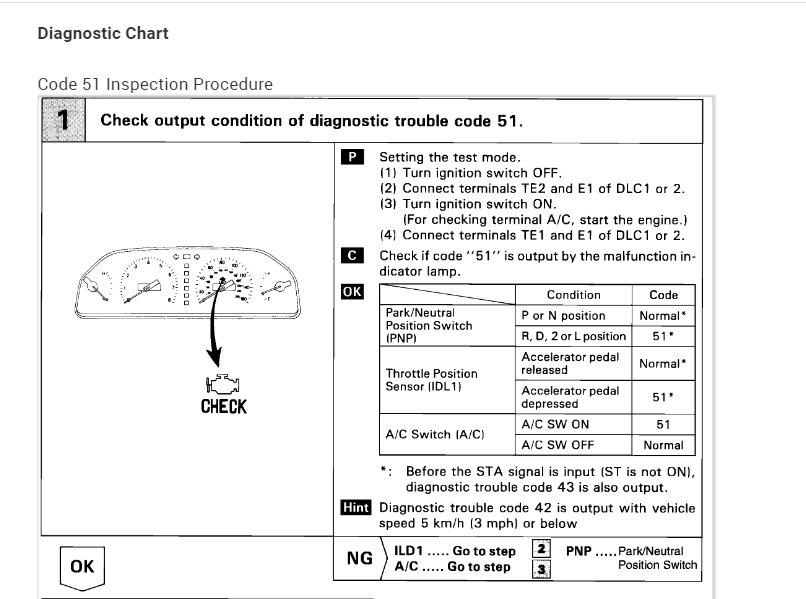

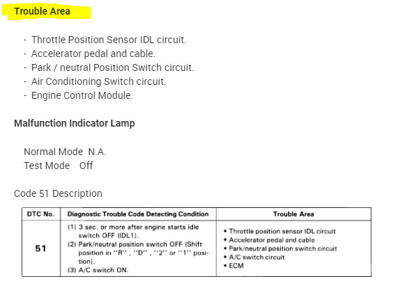

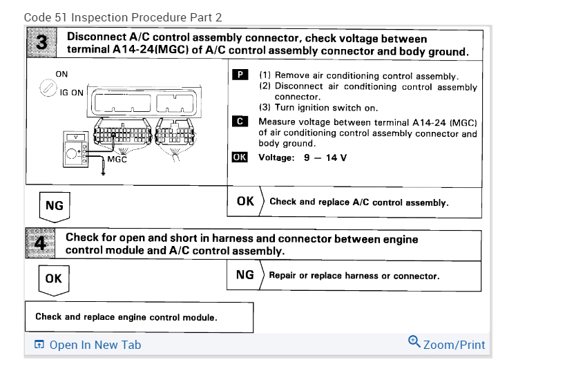

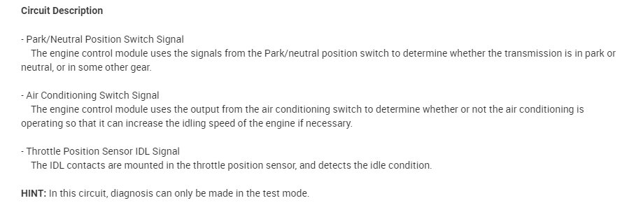

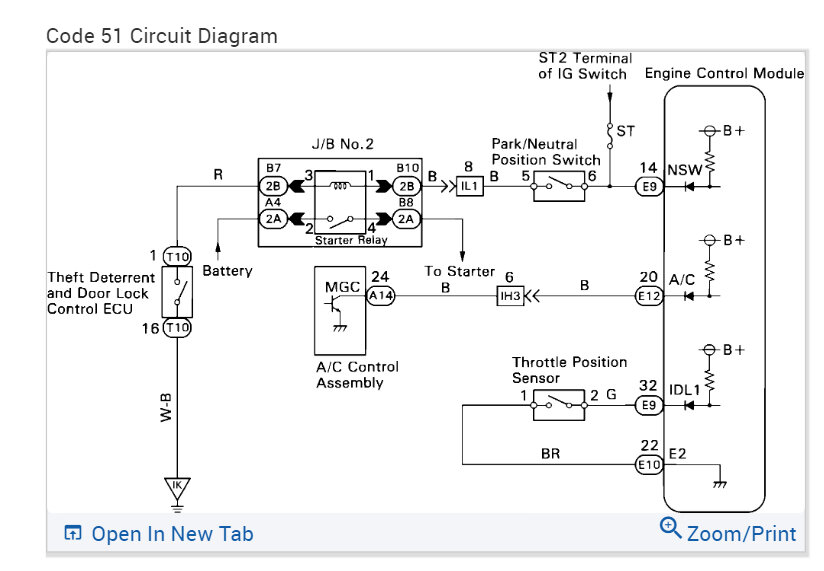

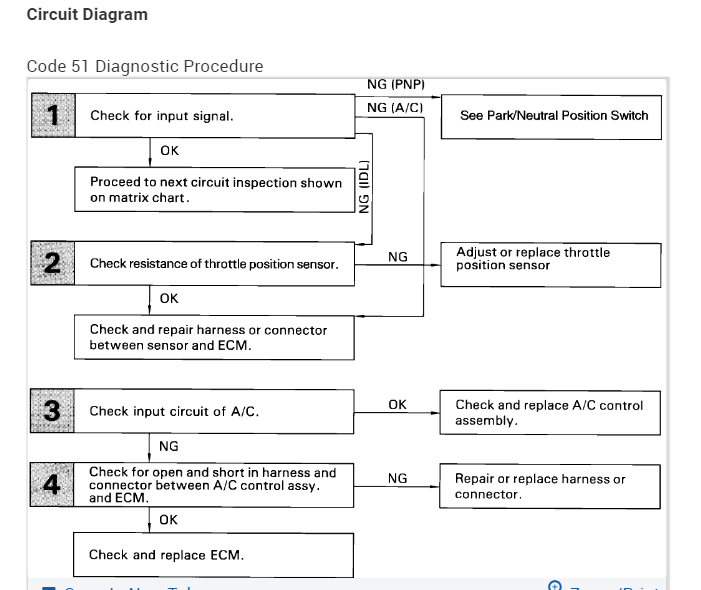

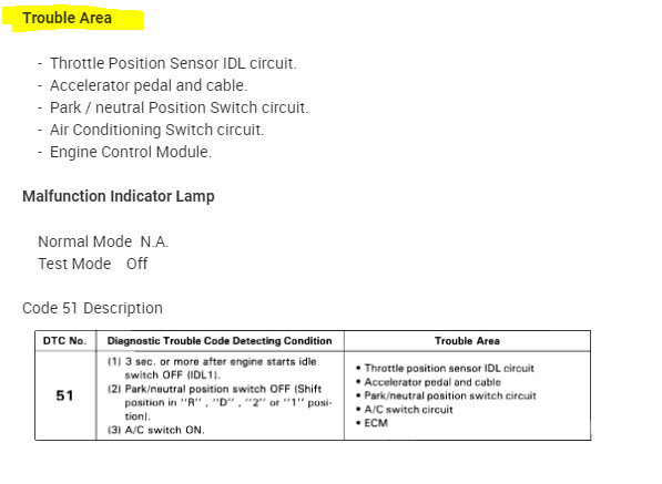

Also, according to my manual, DTC51 is a switching-related issue. I attached the information below along with diagnostics. Let me know if you are finding something different.
See pics below.
