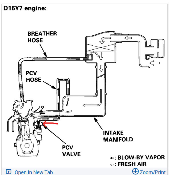

What would cause engine to burn oil and how do I fix?
May 22, 2025 at 6:05 PM
CERTIFIED EXPERT
53,854 POSTS
Most of the time when the engine starts burning oil it will be the PCV system, I would change the valve out to see if it helps, (the spring breaks inside the valve). Check out the images (below). Please let us know what happens.
