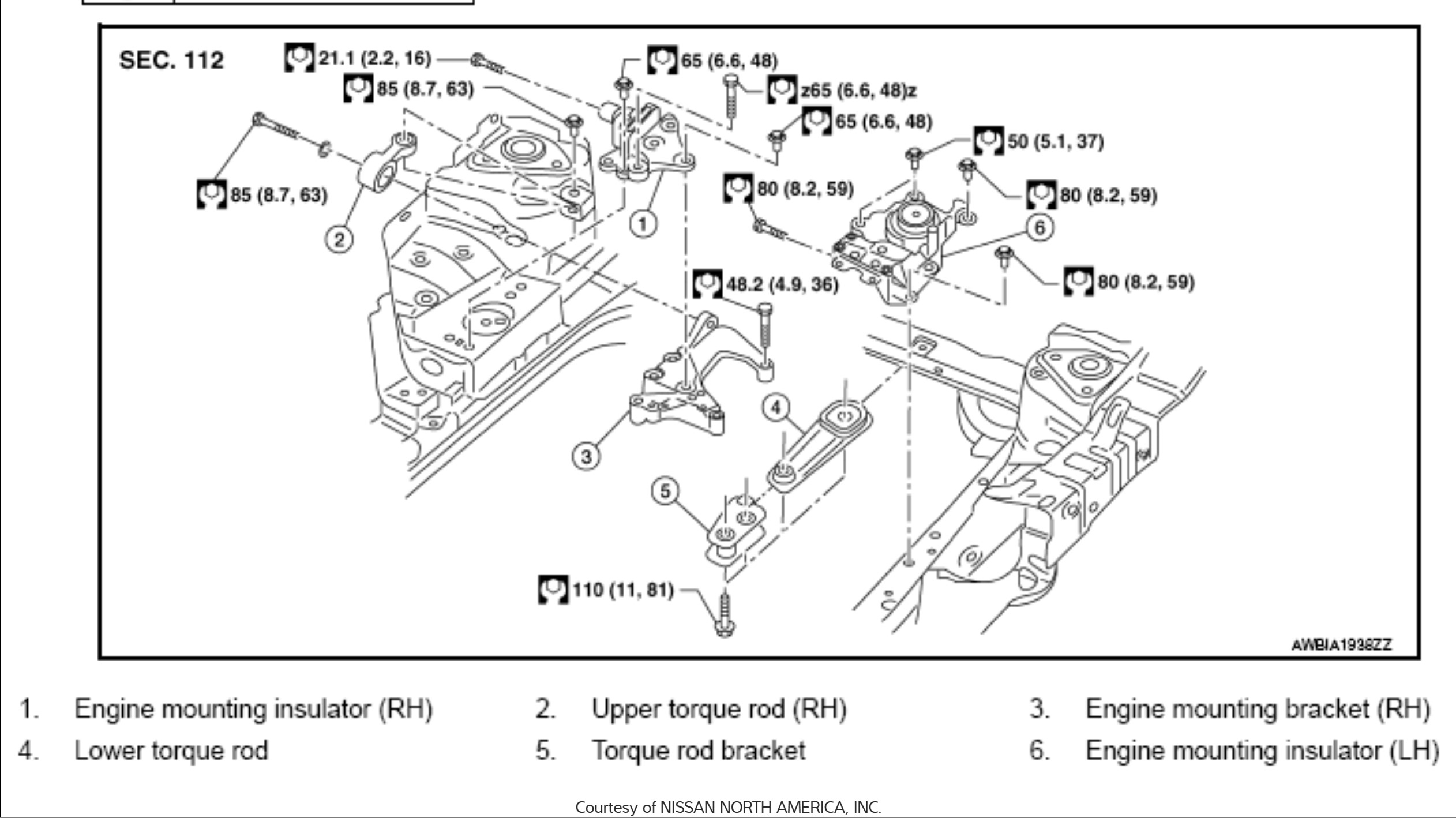

I am adding a picture for you. Please let me know which number is broken.

MALACHI BAKER
The break seemed to be about where (6) is, the technician showed me the break on the engine side of it since that's what was hanging down. The break looked to be about 6-8in long and 1-1 1/2in thick of solid aluminum.

So, with this mount from what I can see mounts the transmission. This is exactly where they would have been working. This mount in particular is very sturdy and hard to believe it just broke. I also find it hard to believe that they didn't notice that it was broken if it indeed came in with the issue.
They would have had to pry up on the engine maybe or they set up the lift wrong and pushed up on the motor.

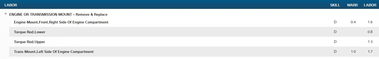

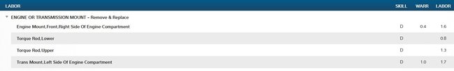

Also, the labor time to replace this part according to Nissan is:
1.7 hrs.
I would strongly advise not going aftermarket for this type of part as it may fail prematurely.
With parts and labor, the job should be around $600-$700.

I am adding an image of the part and retail price as well as the labor times for you.
