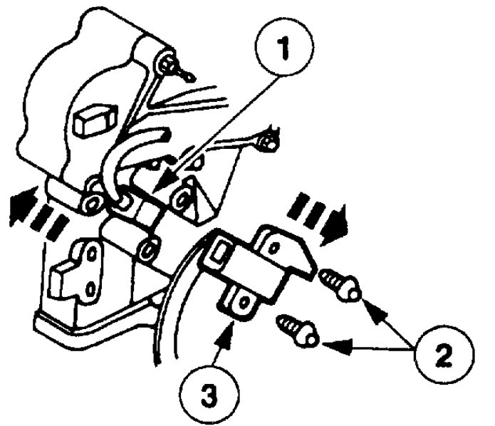

Intermittently, more and more frequently while driving the SUV will be running fine. While driving at any speed it suddenly bogs down and will not accelerate. Occasionally it will shut off completely. Once you cut the car off it will crank right back up and it will be fine until its next episode. Any suggestions?
Oct 30, 2017 at 10:04 PM
Is the check engine light on? If so we need to get the codes and see what they are.
Here is a guide to help you gather the codes:
If not It sounds like a crankshaft angle sensor or fuel pump is going out.
Here is a guide to help us find the problem:
https://www.2carpros.com/articles/engine-stalls
If nothing turns up I would try the crankshaft sensor first.
Here is a guide that will give you an idea of what you are in for when doing the job:
Below is what it will be like on your car in front of the engine near the crankshaft.
Please let us know what you find.
