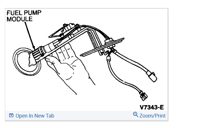

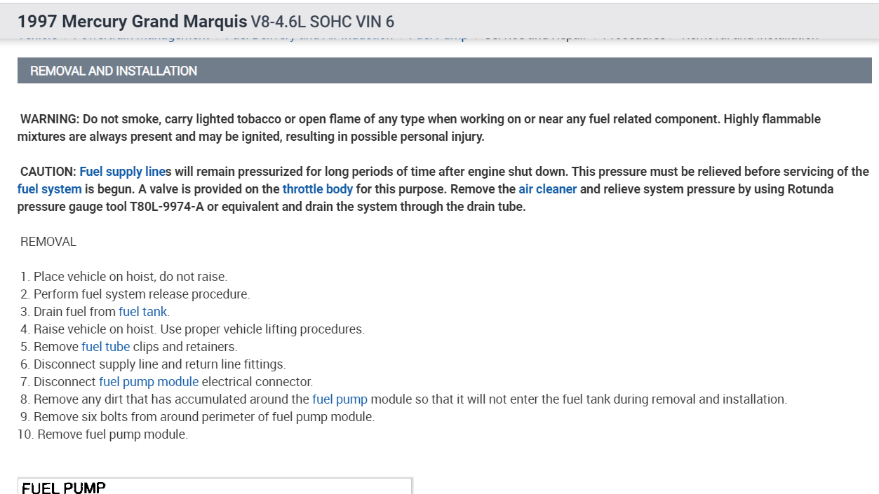

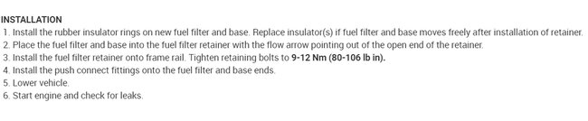

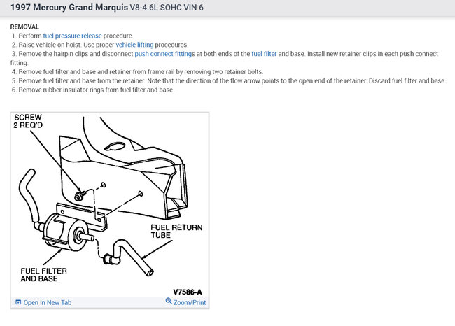

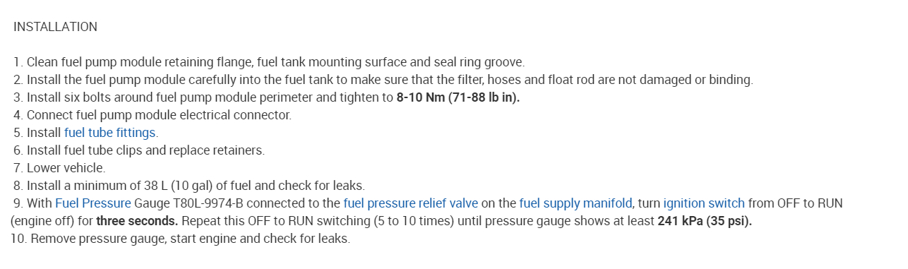

Yep, this sounds like a typical fuel pump failure, but I would start by changing out the fuel filter, here is the location so you can change it out. I have also included how to change the fuel pump out in case you need it.
This guide may help as well:
https://www.2carpros.com/articles/engine-stalls
Check out the images (below). Let us know what happens and please upload pictures or videos of the problem so we can see what's going on.
