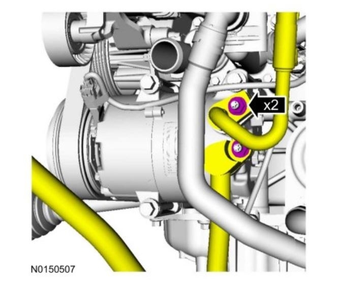

3. Refer to: Air Conditioning (A/C) System Recovery, Evacuation and Charging See: Heating and Air Conditioning > Procedures > Air Conditioning (A/C) System Recovery, Evacuation and Charging (412-00 Climate Control System - General Information, General Procedures).

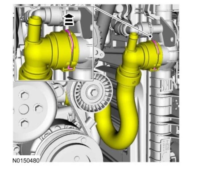

5. Refer to: Cooling System Draining and Vacuum Filling See: Cooling System > Procedures Cooling System Draining and Vacuum Filling (303-03A Engine Cooling - 1.6L EcoBoost (132kW/180PS)- Sigma, General Procedures).

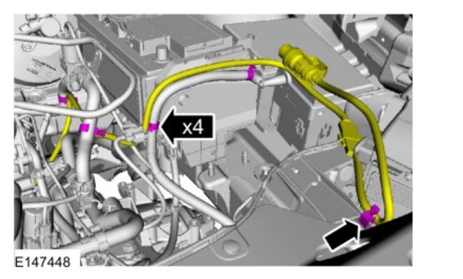

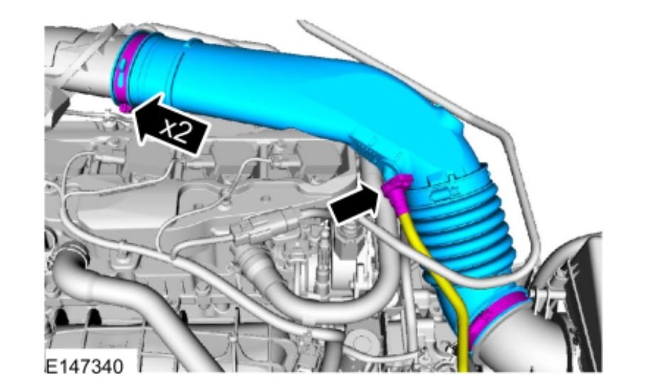

11. Refer to: Air Cleaner See: Air Filter Element > Removal and Replacement > Air Cleaner (303-12A Intake Air Distribution and Filtering - 1.6L EcoBoost (132kW/180PS)- Sigma, Removal and Installation).
12. NOTE: If equipped with block heater.
13.

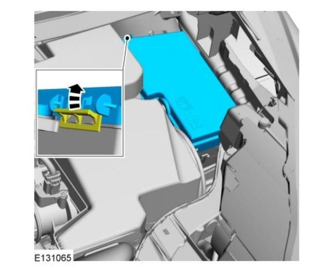

14.
15.

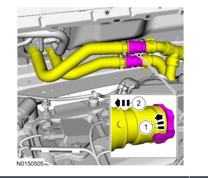

29. Refer to: Degas Bottle See: Coolant Reservoir > Removal and Replacement > Degas Bottle (303-03A Engine Cooling - 1.6L EcoBoost (132kW/180PS)- Sigma, Removal and Installation).
30. Use the General Equipment: Hose Clamp Remover/Installer

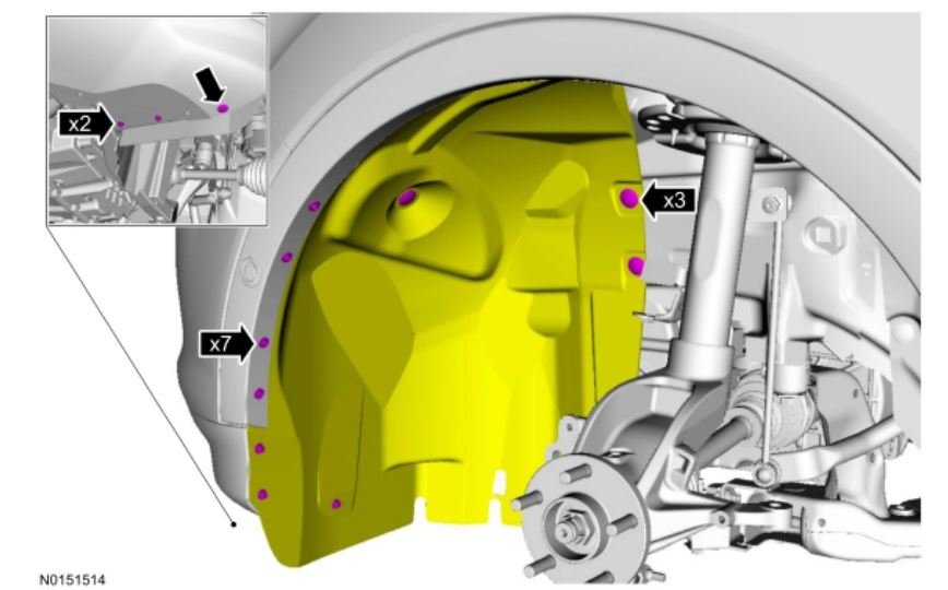

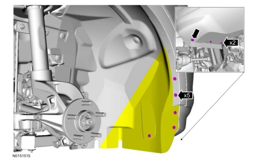

36. Remove the front wheels and tires.
Refer to: Wheel and Tire See: Wheels and Tires > Removal and Replacement > Wheel and Tire (204-04A Wheels and Tires, Removal and Installation).
37.
38.
Remove the drain plug and drain the engine oil.
Use the General Equipment: Oil Drain Equipment
Install the drain plug.
Torque : 21 lb.ft (28 Nm)

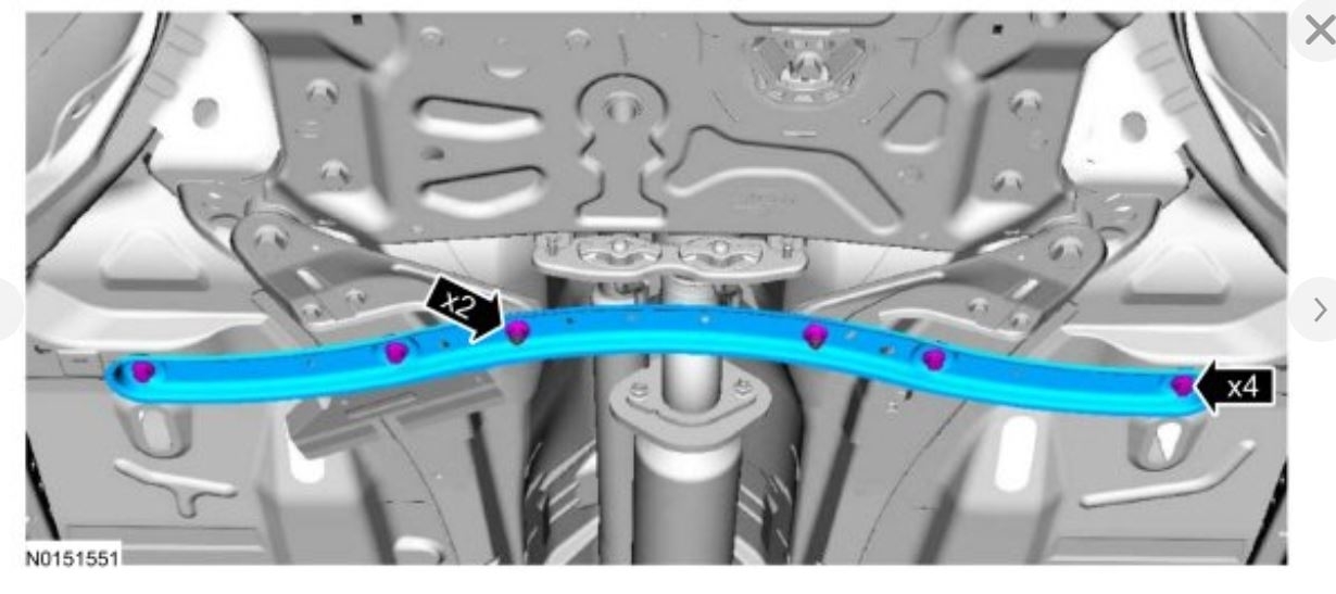

39. Use the General Equipment: Strap Wrench

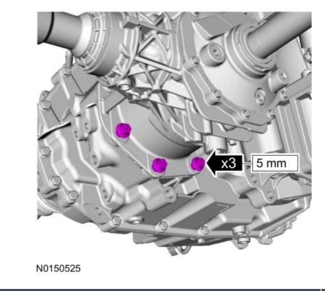

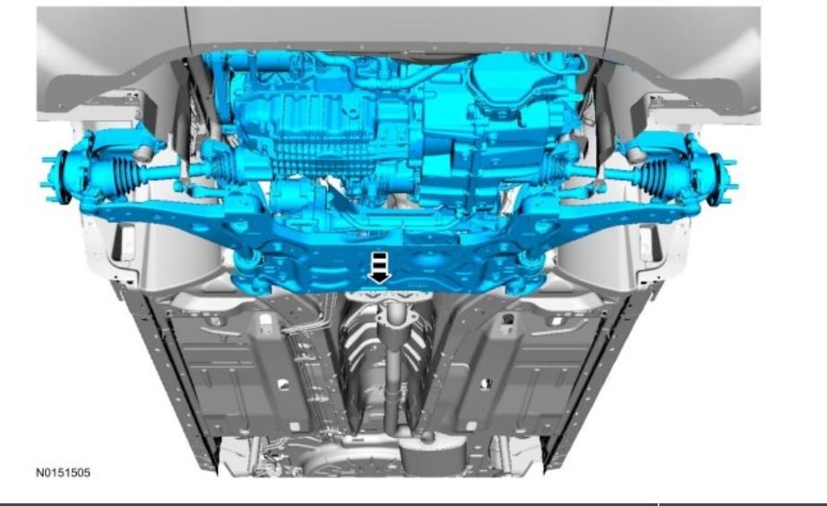

40.
41.
42.
43.
44.
Vehicles with
45.
46.
All vehicles

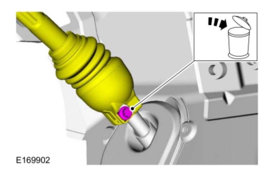

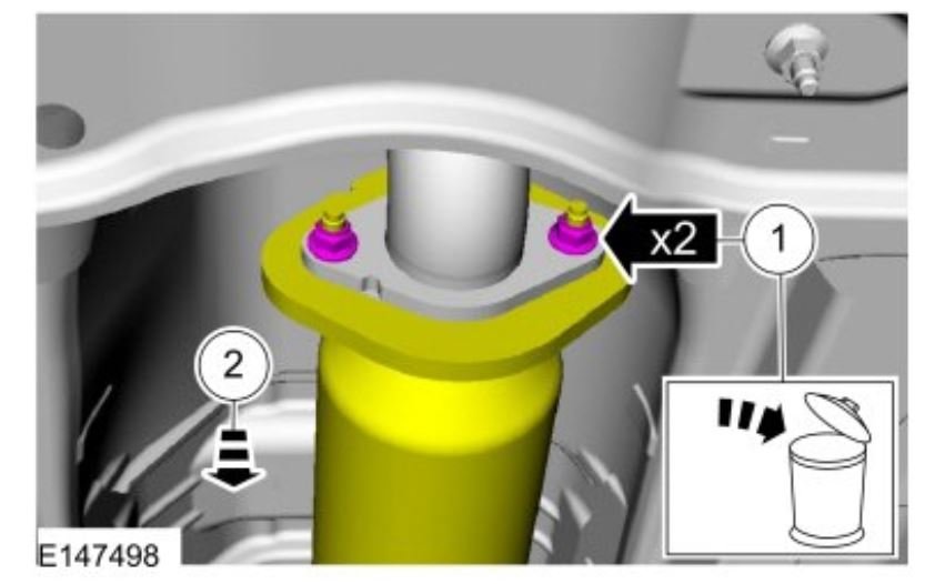

47. NOTE: Discard the O-ring seals and gasket seals.
48. NOTE: LH shown, RH similar.
Both sides.

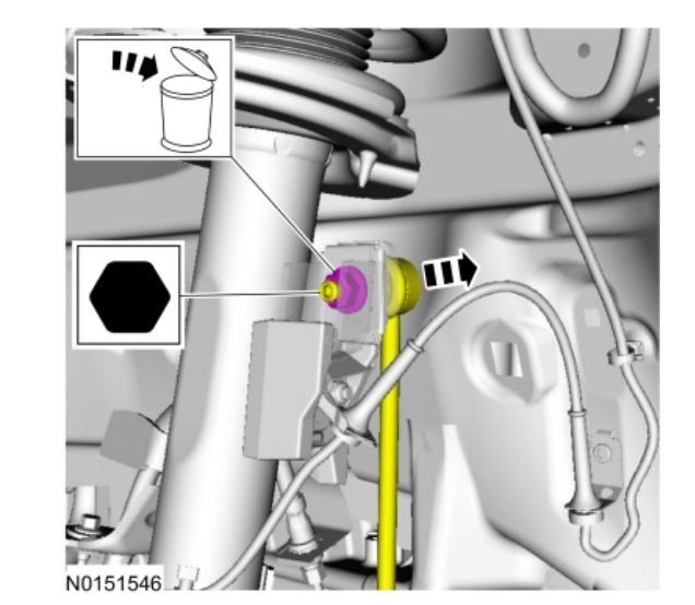

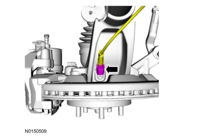

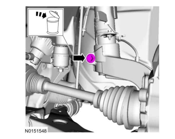

49. NOTICE: Use the internal or external hex-holding feature to prevent the ball and stud from turning while removing or installing the stabilizer bar link nuts. The link boot seal must not be allowed to twist while tightening the link nuts or damage to the boot seal will occur.
Both sides.
