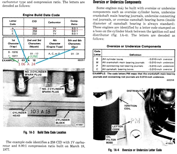

I am trying to setup timing. I have all information but suspect someone changed engine. There are three different references for the 258. Hence I need help identifying 106 A 24 this is on the block between cylinder 3-5 on passenger side. I know it is 24th day and a 258 but what year? Also have a serial number below the year date stamp it is # 970 490.

Well buddy, you cannot go wrong with that year!
I have got the same one in "Mr. Jeep", the one barrel is long gone, he now has a Holley 390.
Screenshot you a table below.

I have the information for years beginning to the 1978 on, the distributor setup is wrong.
My question is 1977 motor in my 1978, but the information for for distributor setup for 1977 is different than 1978. So which do I use?

Yes, you have answered the block question thank you!
