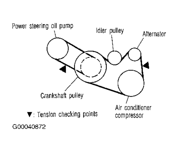

How many drive belts does this car have?
Dec 31, 2022 at 5:19 AM
CERTIFIED EXPERT
53,854 POSTS
It looks like there are 2 drive belts, one for the power steering and one for the A/C compressor and alternator. Check out the images (below). Please let us know if you need anything else to get the problem fixed.
