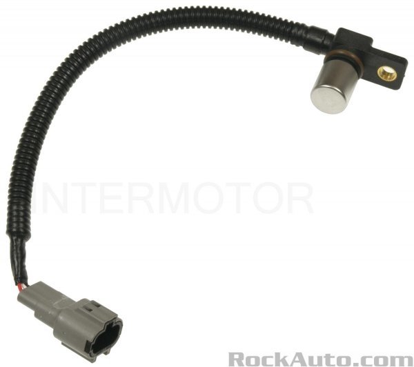

The description sounds like a crankshaft position sensor that is failing. They are known to become heat sensitive. It is in the front of the engine down on the bottom in a bracket near the crankshaft. It is a simple remove and replace sensor.

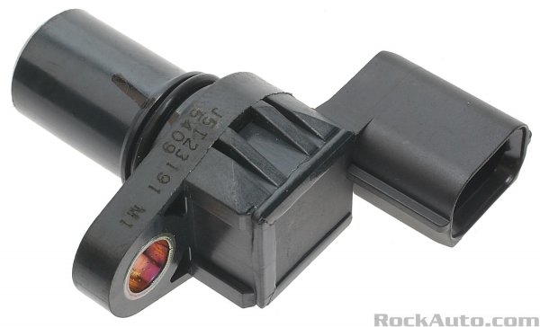

The camshaft sensor controls the timing but they generally do not fail this way, but just in case, The sensor is on the back of the cylinder head, held in with one bolt. It is a plug and play item. You remove the bolt, remove the sensor by wiggling it to free it and pull it out. Apply some oil to the new sensors o-ring, slide it into the hole and tighten the bolt and plug the connector in.

Below are pictures of both the one with the long wire is the crank sensor.
