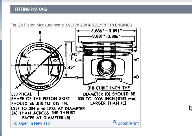

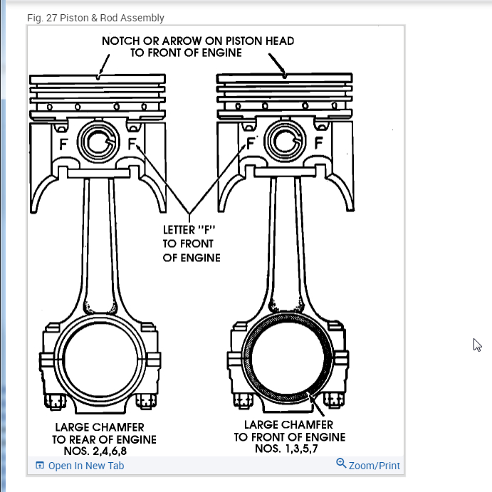

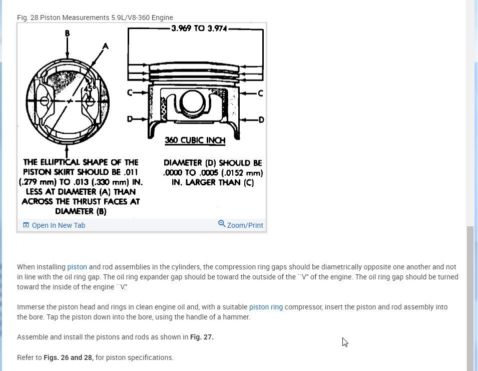

what is the direction of connecting rods on pistons?
Aug 8, 2020 at 2:57 PM
I am attaching all the info on the pistons in case you need that as well.
Let me know if you have questions. Thanks

To add to this, be sure the connecting rods are also correct, if the pistons were replaced on the rods it is possible to get them backwards.
