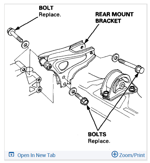

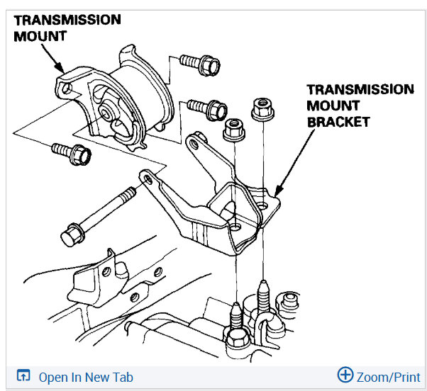

I am wanting to know mainly where the transmissions mounts are cause I think I have a bad one but also would like to know the engine mounts as well
May 21, 2025 at 1:38 PM
Yep, when one engine mount goes bad it is best to change them all out. You will to support the engine and transmission from above or below, (flood jack or engine hoist). I would disconnect the battery as well. Check out the images (below). Let us know if you need anything else.

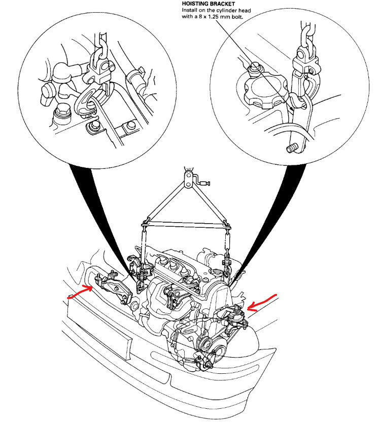

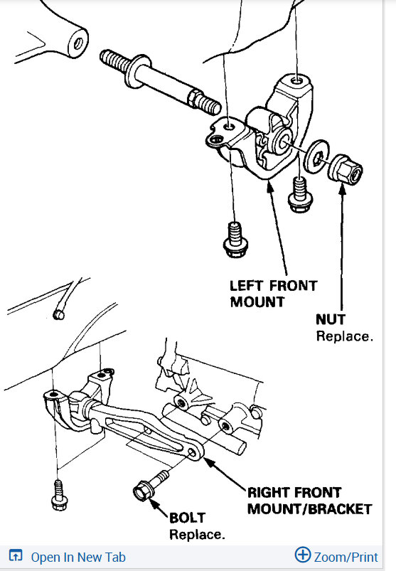

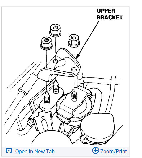

Can you give me a better description on where these are located the pics are a little vague.
May 22, 2025 at 7:48 PM
DAVID CHANDLER FARR
  • 41 POSTS
Can you be more specific on where these mounts are located on the car?
May 22, 2025 at 10:57 PM
That is all they give us, sorry. I would open the hood and look around using a flashlight, you should be able to find them. Have a good weekend!
