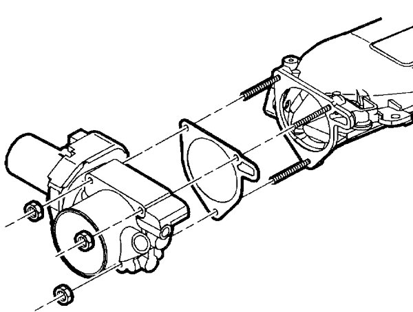

These cars are easy to fix so don't let them tell you stuff like that. With only 85k on the car it is still young, I would run the codes to see if any are present even if the check engine light is not on. This video can help
https://www.youtube.com/watch?v=LBCpCWEFnTg
If no codes are present I would replace the throttle body, this is a common failure which will cause the problem you are describing. Check out the images (below). Please upload an image or a short video in your response, so I can see what's going on.
