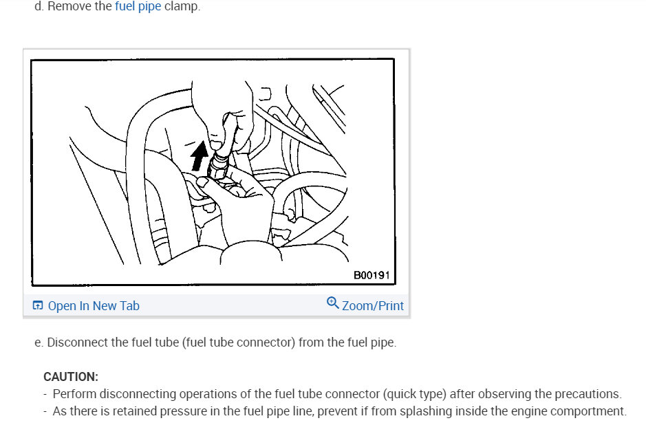

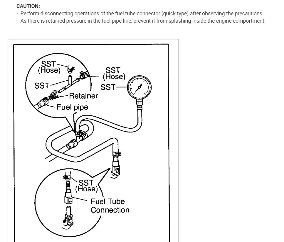

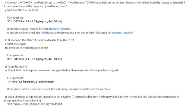

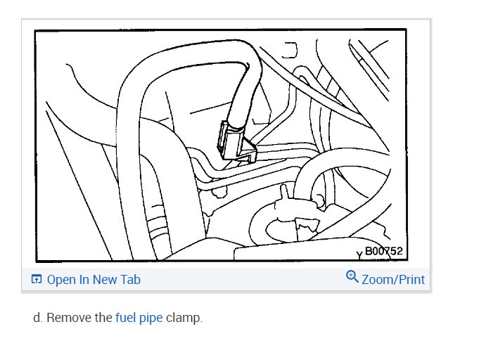

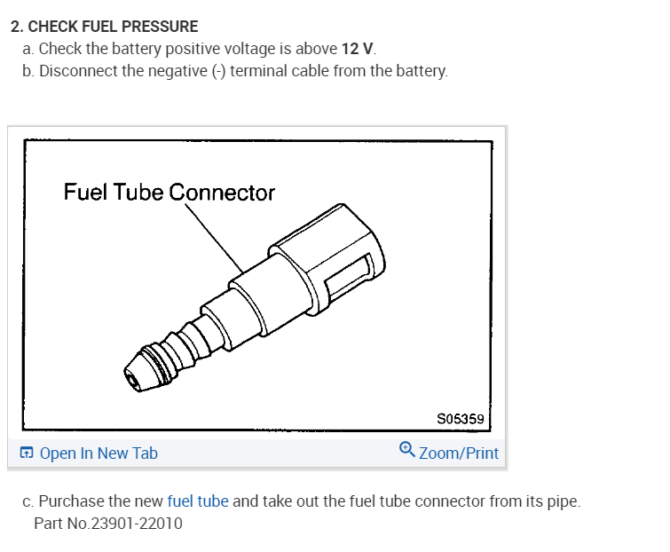

The first thing we need to do is run the codes and make sure the air filter is clean. Next, we should do a fuel pressure test because it sounds like the fuel pump is getting weak. Here are a few guides to help us see what's going on:
https://www.2carpros.com/articles/engine-has-low-power-output
and
and
This guide is to test the catalytic converter:

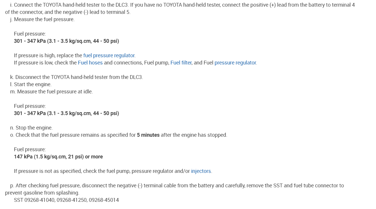

Fuel pressure: 301 - 347 kPa (3.1 - 3.5 kg/sq.cm, 44 - 50 psi)

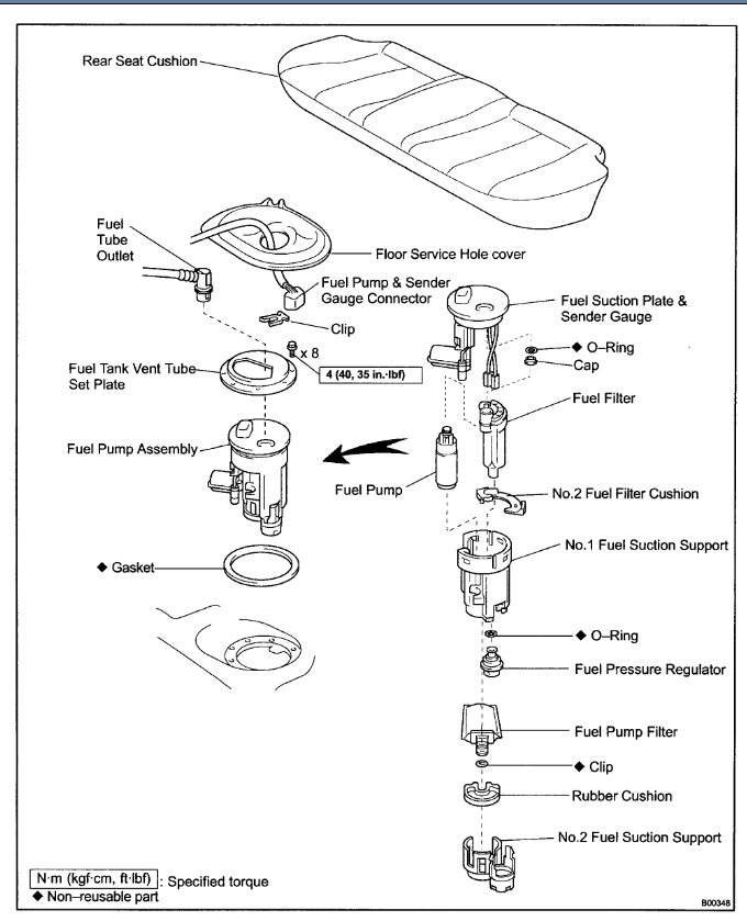

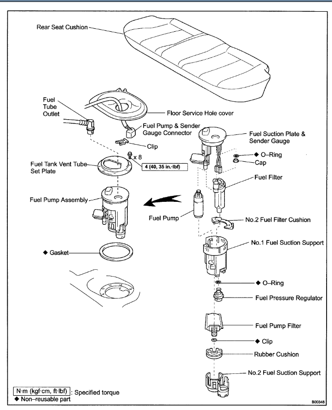

You can rent a fuel pressure gauge for cheap at the local auto parts store. The fuel pump is changed out under the rear seat so that's good. Check out the images (below). Let us know what happens and please upload pictures or videos of the problem so we can see what's going on.
