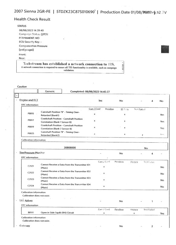

Replace the engine? That's a quick way to make money and an easy way to cover all the bases. Ugh! If it is running good, there are no engine noises such as knocking or ticking, drive it. I didn't know the oil got that low. That likely caused the variable valve timing to go off because it is controlled by oil pressure
Make sure the engine oil is clean and full. Have the codes cleared and drive it to see if they come back. I suspect they won't. Even if they do, if there are no engine noises and it's running good, don't be afraid to drive it.
Let me know. Also, let me know if there are any engine noises. Actually, if you could start it and record it running, I should be able to tell if there is a concern.
