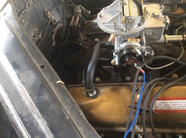

Turns over but doesn’t seem to be firing. Looks like a fuel spot under the fuel pump.To be honest,the mechanic that was to have rebuilt the engine called my car his project,smarted out at $3,600.00 and 3 weeks turned out to go to 9 weeks and $5,000.00 and he was adding things I didn’t want at this time.Wires loose,from battery on .fitting on carburetor has no line going to it. Picked up car ran for 5-7 minutes backfired cut off. had it towed home. got it restarted 2 days later seemed good.Drove about 5 minutes backfired cut off has not restarted.looks like fuel getting into carburetor.but like I said turning over but no firing. Distributor was loose turn by hand, tightened bolt. that was when it ran in garage.was told by someone else that is suing him he has a thing of keeping cars doing what he wants to it run up bill until bill is more than car is worth.So this really does sound like a rat trap.telling you this so you might have an idea of what we are facing. Carburetor is a hell if I know.He bought a new Chinese made one then charged for a rebuilt twice the amount he said he paid.he put an electric choke on it I didn’t want, put a fan on it, I did not want. when he clipped onto wire it cut through all but 2. It is a 1965 Ford Falcon station wagon, v8/289.

Also the open vacuum port you mentioned can cause the backfiring.

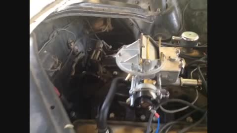

Did you get picture or video?

Battery,12.6 volts solenoid volts coil 6.5 volts.turn key on electric choke sounds like it’s running constant.

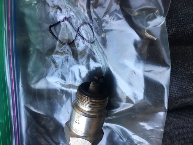

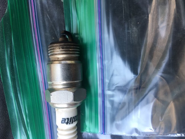

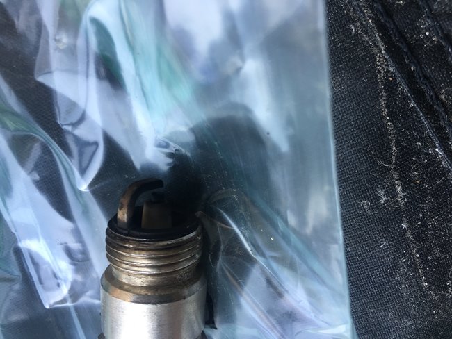

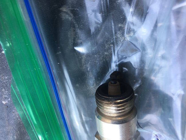

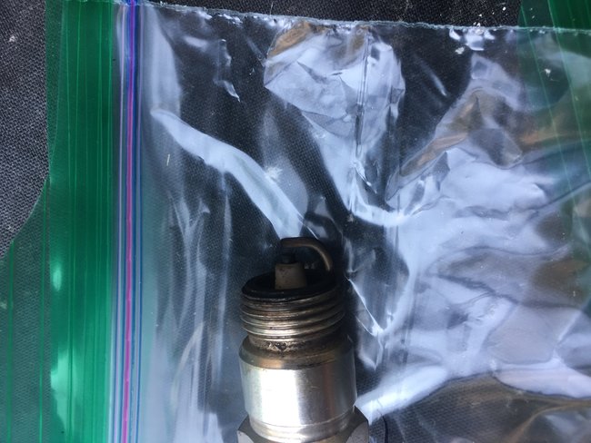

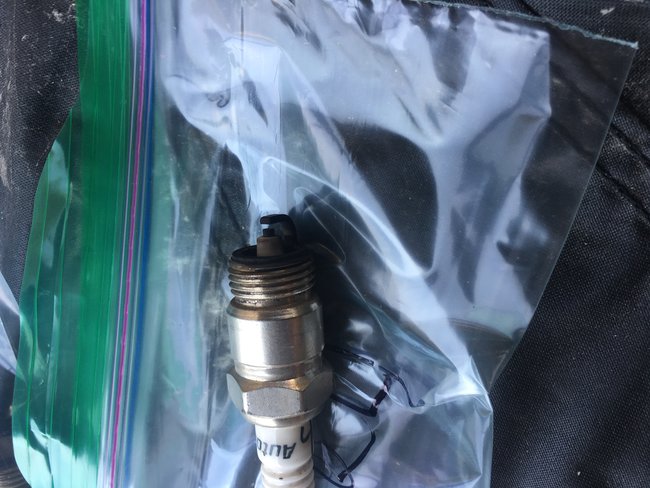

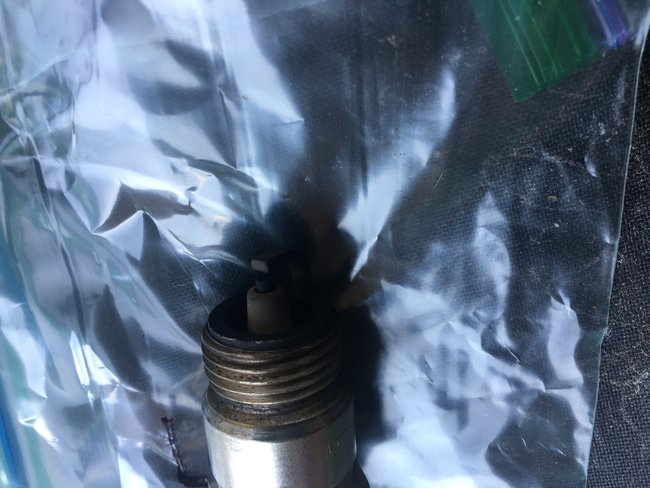

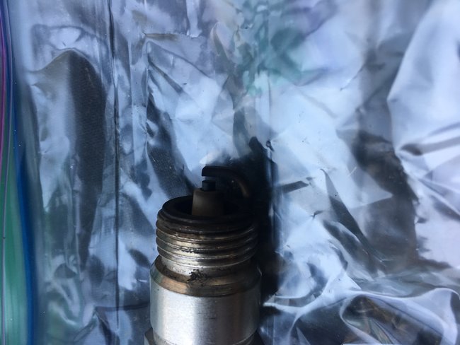

Lets make sure we have not only spark, but good spark. I need you to pull all the spark plugs. Keep them in order as you pull them so you know which one came from each cylinder. Once you have done that I need you to look at each of them and note what color the porcelain is on each plug. Take notes so you can tell me if they are all the same color, If some or even one is a different color take a close up picture of it and tell me which cylinder it came from. A normal plug should be tan to medium brown.
Once you have that done, plug one of the spark plugs into a plug wire and hold the threads on the plug to the engine block and crank it over with the key. (This will take 2 people) I suggest your wife hold the plug and you crank the motor because I need you to tell me if you have spark at the plug and what color the spark is. Is it blue, yellow, orange or white?

Plugs are new. this is plug number one:
Sep 2, 2019 at 9:14 AM

2,3,4,5,6,7,8.
Sep 2, 2019 at 9:32 AM

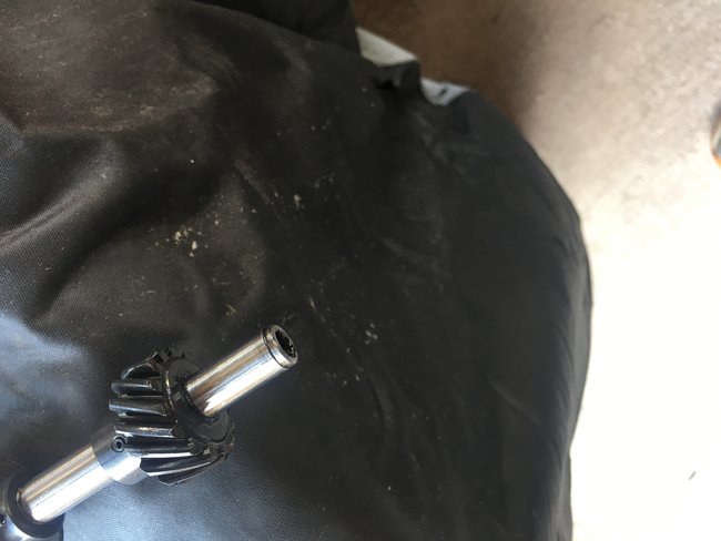

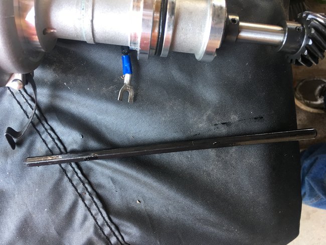

Rod fell off of distributor fell into hole fell out of end but into correct hole.

Good work. Can you please shoot a quick video with your phone of the engine cranking over so we can see what's going on? that would be great. You can upload it here with your response. I will be able to tell if the engine is okay from the video.

Okay, so put everything back in,what about the rod that fell off of distributor, just stick it back in bottom the into engine?Do I need to turn balancer to TDC or TDC plus degree.

That rod runs your distributor and the oil pump so it is critical it goes back in correctly.

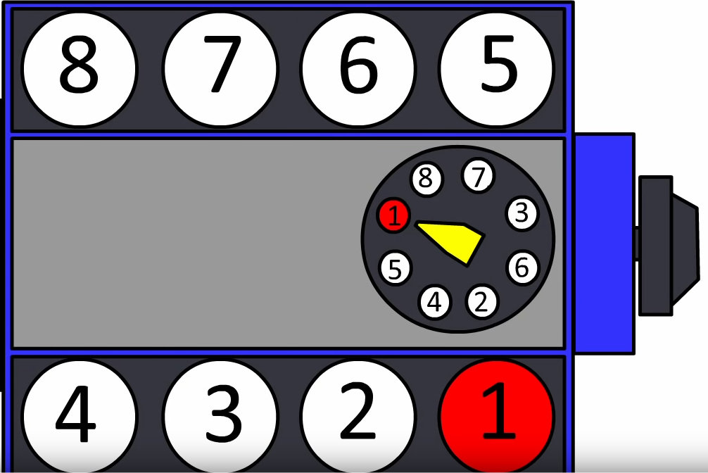

First you need to set the motor to top dead center on the compression stroke on the #1 cylinder. The easiest way to do this is to pull the #1 spark plug. Put your finger over the plug hole. Not in the hole but over it. Then crank to motor until you feel the pressure blow your finger off the hole. Then put a ratchet on the crank bolt that holds the harmonic balancer on and line up the notch on the balancer with the TDC mark on the timing chain cover. That will be TDC top dead center.
Then put the rod back in the hole. Note:
Both ends of the rod should be keyed. Make sure the end that was down goes back in down and engages the oil pump.
Now comes the fun part. The distributor is run by the end of the cam shaft. You will notice the worm gear on the end of the distributor. As you drop the distributor back in the hole the rotor will turn as the worm gear engages. Here is what needs to happen all at once. The slot in the rod has to line up with the slot in the bottom of the distributor shaft when the distributor drops all the way down you need the rotor pointing at the #8 spark plug so that it is pointing at #1 on the distributor cap. See image below.
In order to do this you need to line up the rod with the slot on the bottom of the distributor shaft and because it will turn as you put it in you need the rotor pointing at the #4 cylinder so that as it rotates on the way in it ends up pointing at #8 when its all the way down.
You will find you will need to turn that rod just a bit again and again until it lines up.
If this is not put in correctly, the car will not run.
Also note.. when the distributor is installed the shoulder at the bottom of it should be all the way down to the motor with no gap. If you have a gap it is not all the way down and is probably hanging up on the rod.
