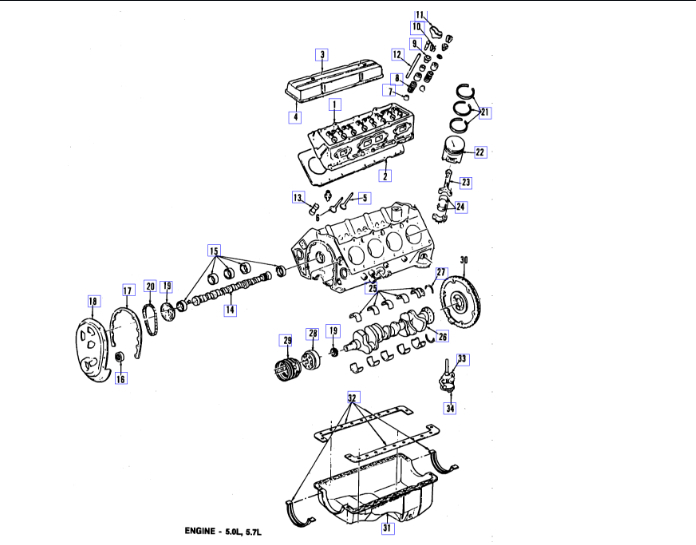

The 350 motor block is the same from 1987 to 1995.
Even if you got another year engine, you would need to strip it down to a long block and change everything from your engine to the donor motor.
