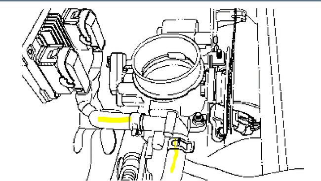

I believe they go to the throttle body. See the attached pic for a 2004 and let me know if that is correct.
