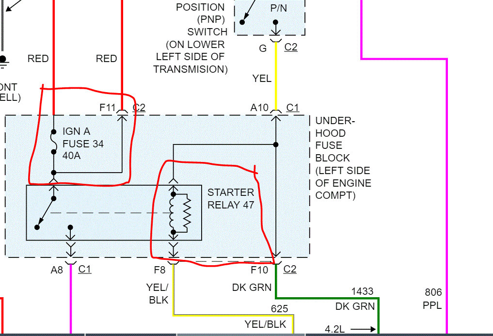

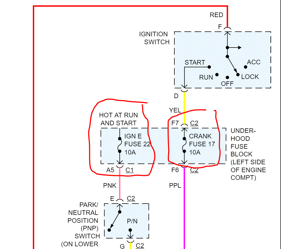

Okay, since we know the battery is good and the starter is new, then there are a few fuses I need checked. All are located under the hood in the power distribution box. See pics 1 and 2.
I would also like you to check the starter relay. It is in pic 2 as well.
Here are links you may find helpful for testing. If you have a relay in the box with the same part number, switch them to see if there is a difference.
