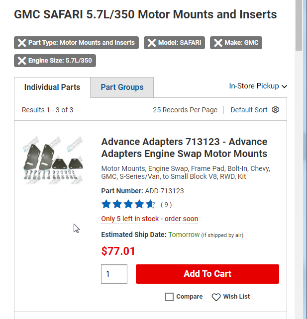

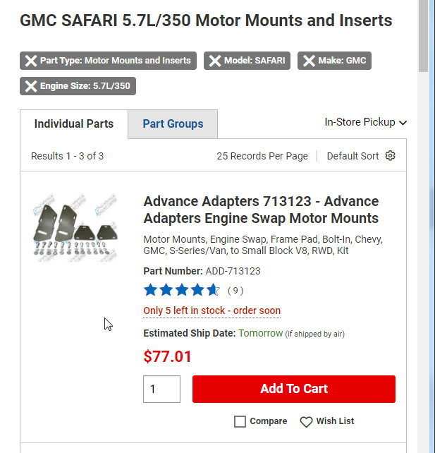

Next search the aftermarket parts world for things that will make this easier. Starting with engine mounts. It appears Summit has altered mounts for this Van to have a 5.7L/350 in it so it may be easier then I thought. Please see the attachment below.
Here is the website that I found:
https://www.summitracing.com/search/part-type/motor-mounts-and-inserts/make/gmc/model/safari/engine-size/5-7l-350
