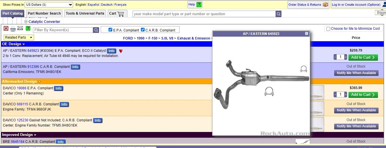

https://www.2carpros.com/articles/engine-has-low-power-output
1. Low fuel pressure. If the pressure is low, it could not have sufficient fuel in the engine to rev up.

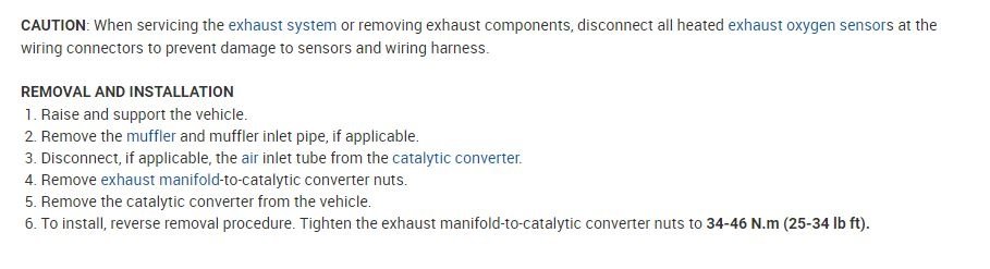

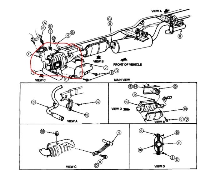

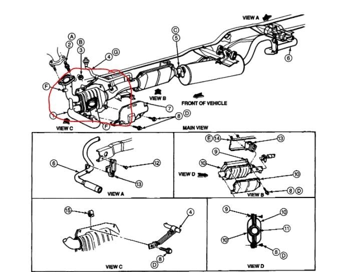

2. clogged catalytic converters. If the exhaust is blocked, it cannot breathe and there will be low or no power. You can check it by either using a back pressure gauge attached to one of the upstream O2 sensors or you can unbolt the head pipe from the manifolds and take it for a ride and see if the power has returned. I attached a picture of the part for you from Rock Auto.
https://www.2carpros.com/articles/bad-catalytic-converter-symptoms
https://www.2carpros.com/articles/catalytic-converter-replacement
