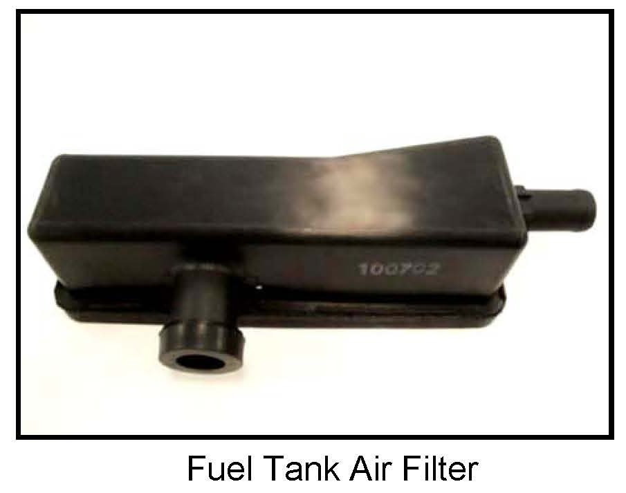

This Bulletin provides the procedure to replace the Fuel Tank Air Filter in 2003-2004MY Kia Sorento vehicles. Over time, the fuel tank air filter accumulates dirt, which can restrict airflow. If the fuel tank air filter is not replaced during regular maintenance the restriction of airflow will eventually reach the point where the vehicle may experience fueling difficulties. Kia is also providing an owner's manual insert for the 2003-2004MY Kia Sorento identifying that at a minimum the fuel tank air filter is to be replaced every 30,000 miles.
pic 1

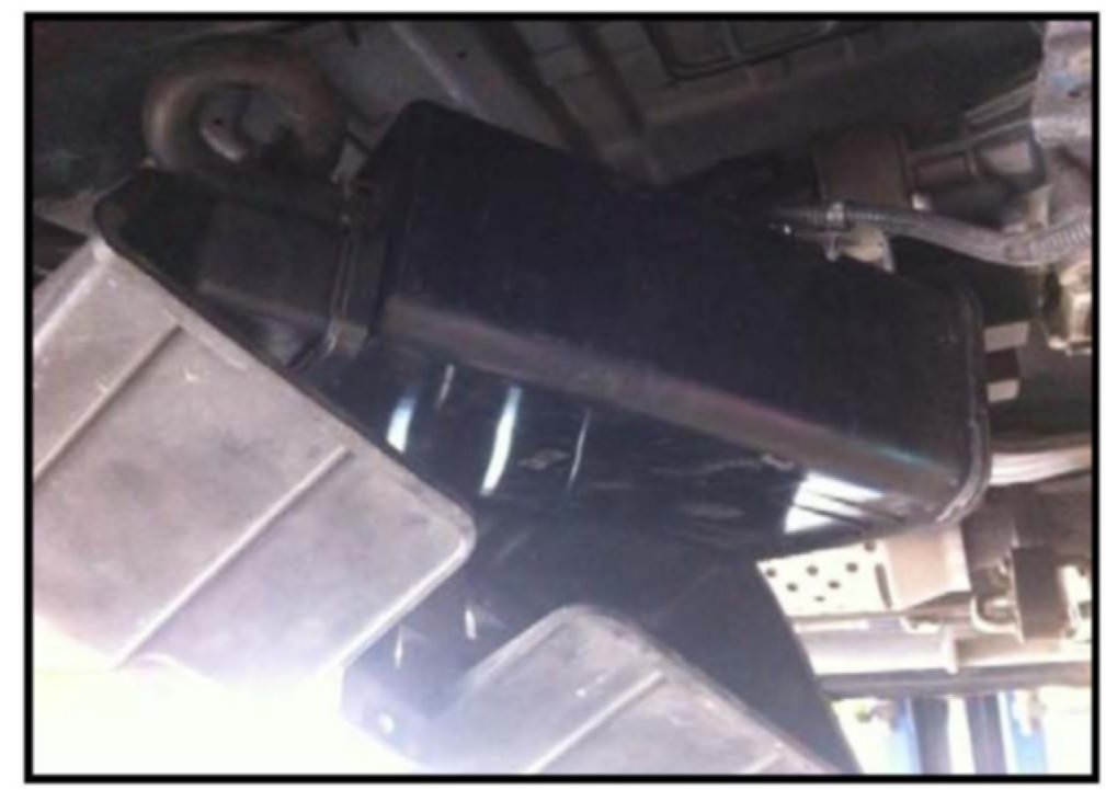

1. Turn off the engine.
Raise vehicle up on a lift.

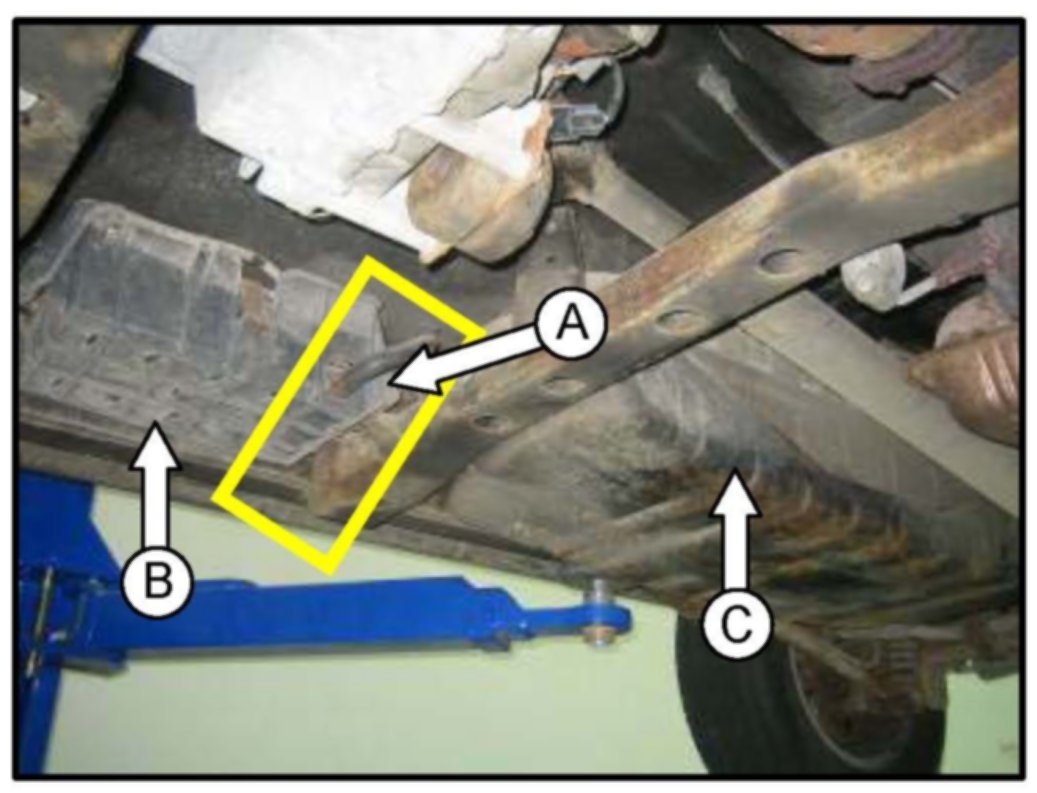

pic 2

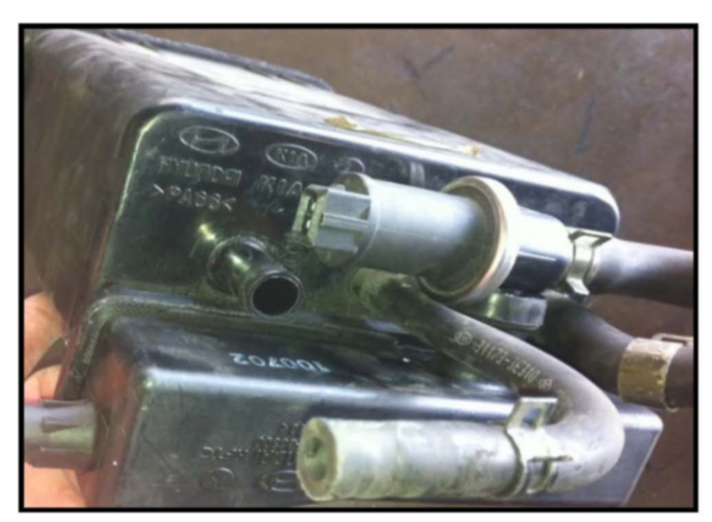

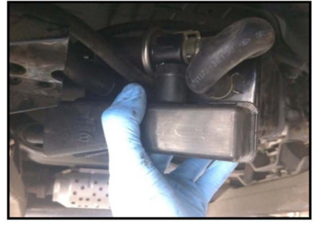

Locate the fuel tank air filter (A).
B: Canister housing assembly
C: Fuel tank

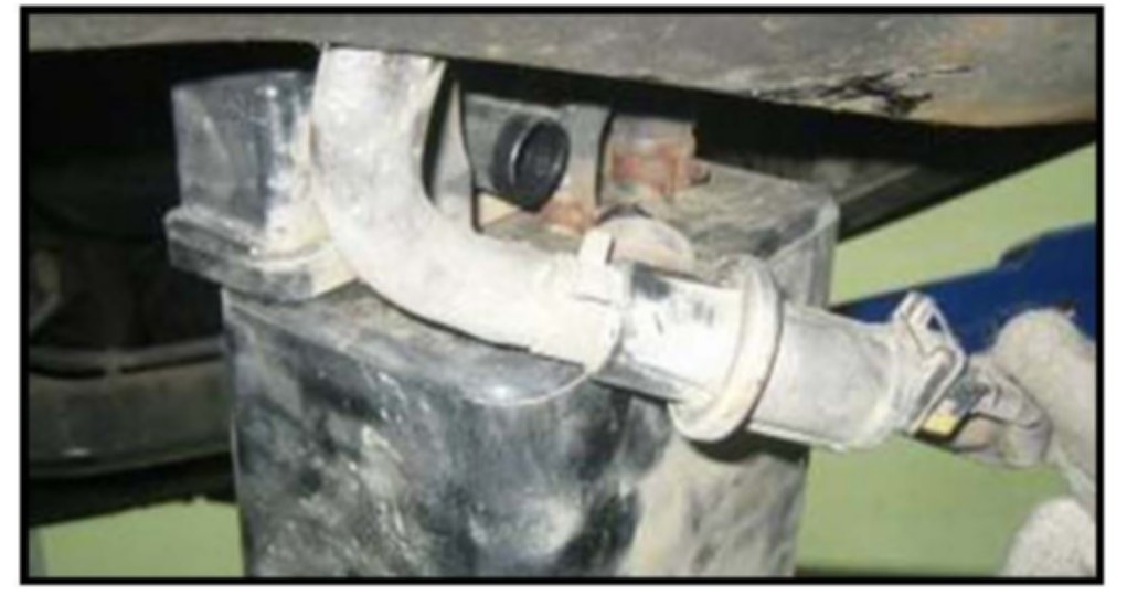

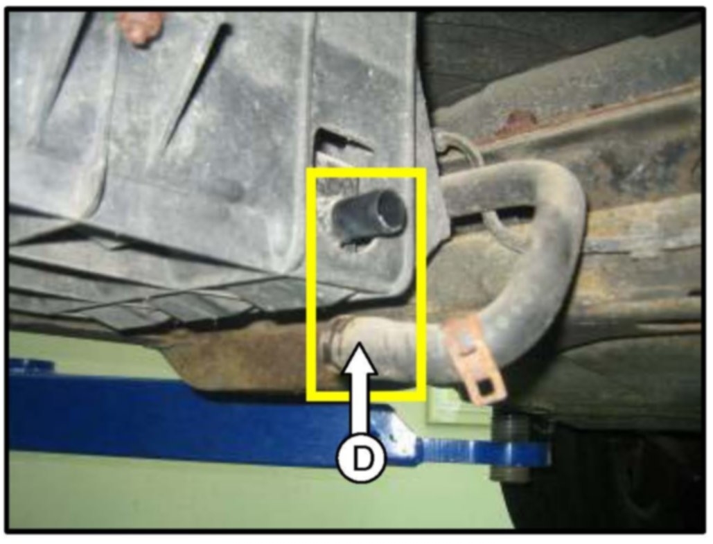

2. Move clamp away from hose end, and disconnect the air hose (D) from the fuel tank air filter as shown in the photo.

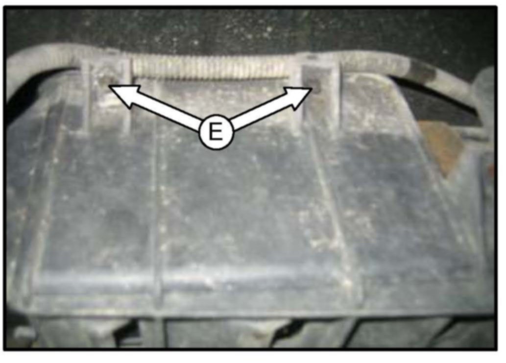

3. Remove wiring mounting clips (E) from canister assembly.
pic 5

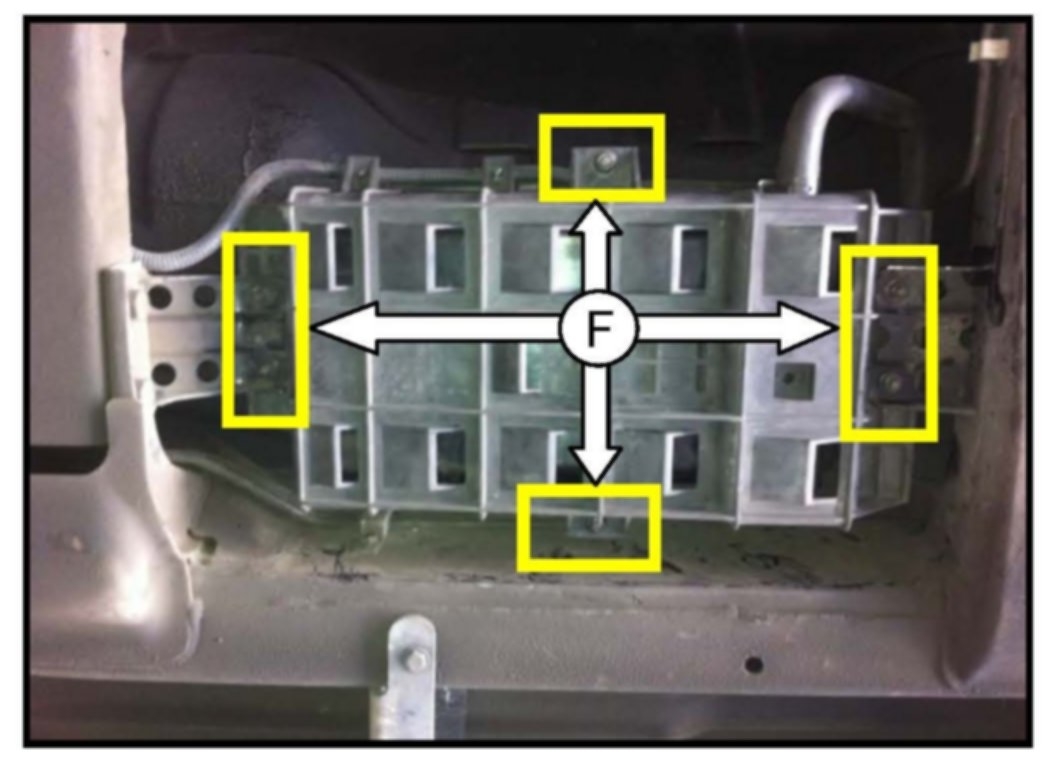

4. Remove the six (6) mounting nuts (F) that retain the canister assembly.
NOTICE:
Support the canister as necessary. Do NOT let the canister hang from the wiring harness or evaporative hoses.

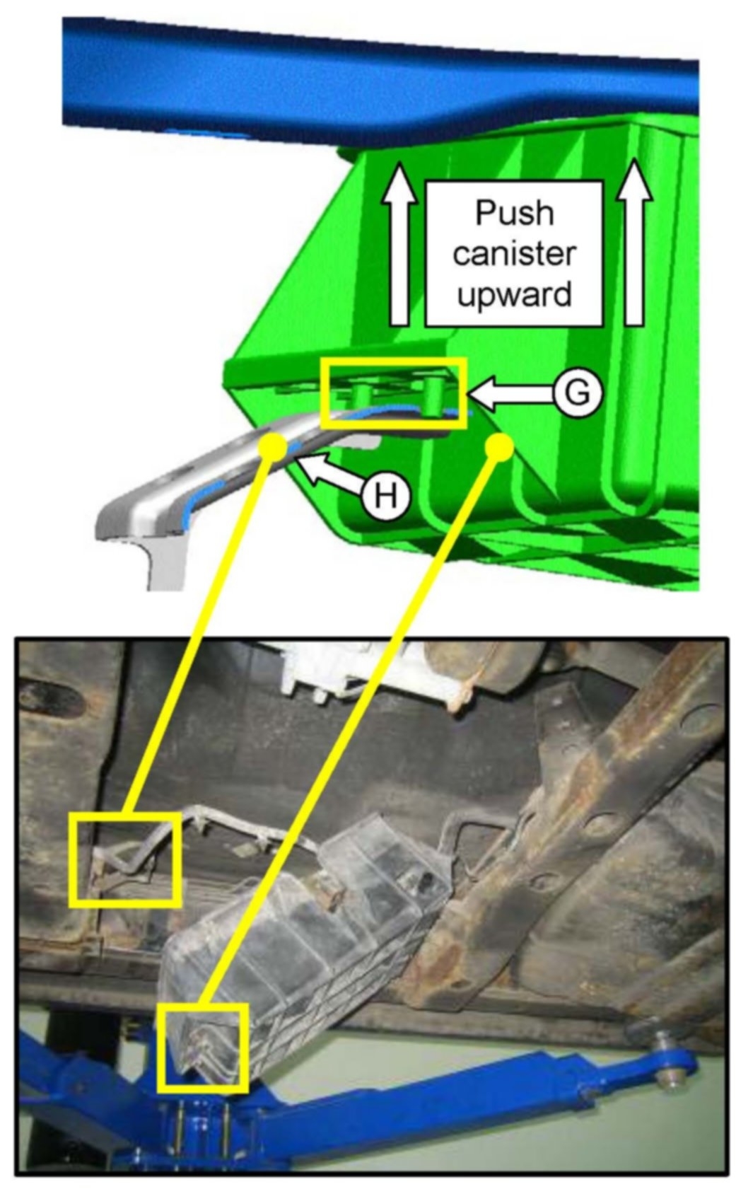

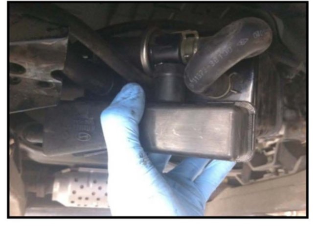

5. Push the canister assembly upward to remove the threaded studs (G) from bracket (H) as indicated in the photo on the right; then pull the canister assembly downward.
pic 7
6. Lower canister assembly and mounting bracket enough to separate the bracket from the canister assembly and fuel tank filter.

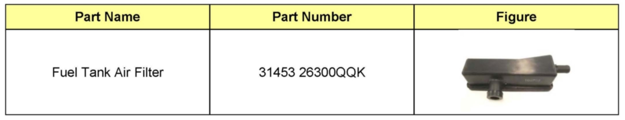

REQUIRED PART
pic 13

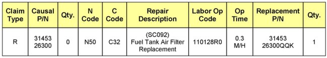

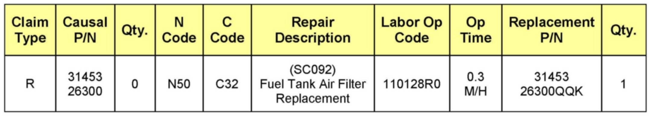

WARRANTY CLAIM INFORMATION
