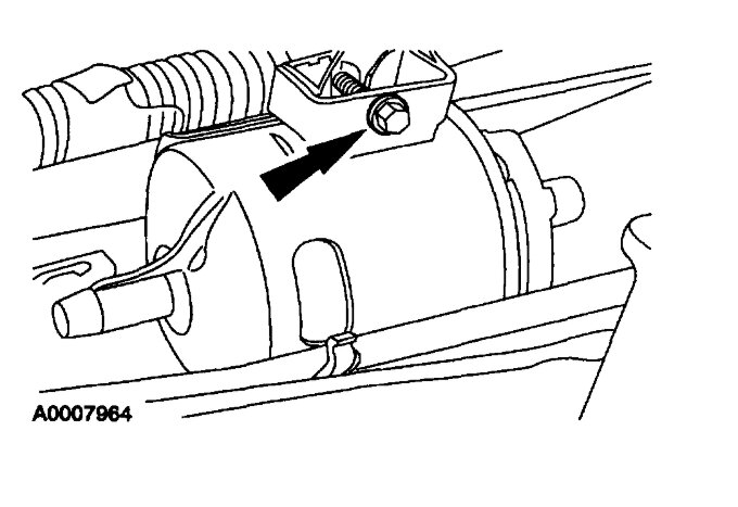

When you were doing the clutch did you notice any rattling from the exhaust? If the catalytic converter has come apart it will block the outlet of the exhaust not allowing the engine to reach any RPM.s Also, this truck has a fuel filter I would change as well which is on the frame rail on the drivers side rear the tank. This video will show you how
https://www.youtube.com/watch?v=wi6kzRjk5to
Please go over this video as well
https://www.youtube.com/watch?v=U1RoG3I-Oww&pp=0gcJCZEKAYcqIYzv
If you have a check engine light on please run the codes, also check all ground wires you took off while doing the job. Check out the images (below). Let us know how it goes
