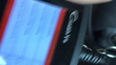

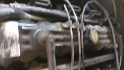

I do have a scanner. I’m going to make a video of how it sounds on start up and while running. I will also get video of scanner. thanks for your reply.

Second video.
Mar 7, 2021 at 10:15 AM
I was unable to see the data stream on the scan tool. At first, I saw fuel trims in the negatives. That usually indicates a rich fuel mixture. You mentioned the fuel smell, so I think that is the direction we need to go. The engine sounds like it has a dead misfire, so I have a feeling one of the injectors is stuck and dumping fuel causing the smell, misfire, and the rough idle. It is likely a result of the old fuel and work that has been done.

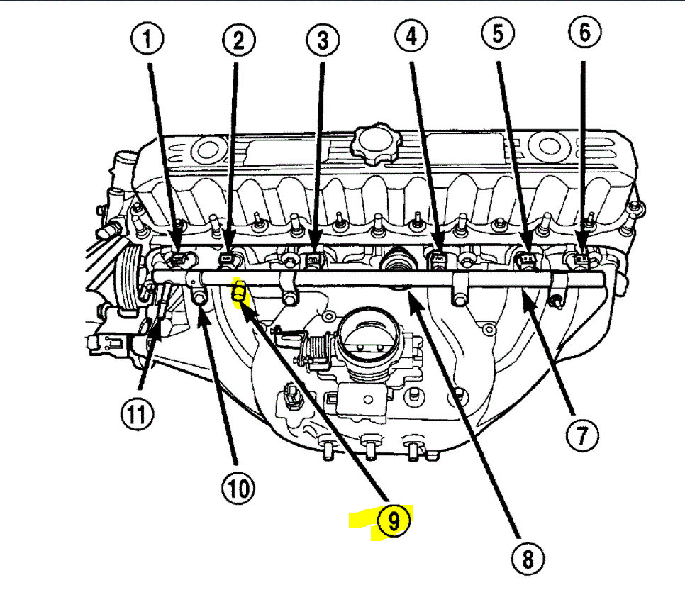

Also, I realize you replaced the fuel pump. Have you checked the fuel pressure to confirm it is within the manufacturer's specs? There could be an issue with the fuel pressure regulator allowing too much pressure. If you haven't, I would check it. Here is a link that shows how it's done:
I attached a pic below showing the test port location. I realize you may not have a fuel pressure gauge, but oftentimes a parts store will lend you one.
Here are the manufacturer's specs for pressure:

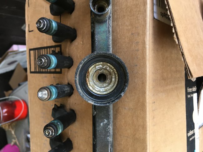

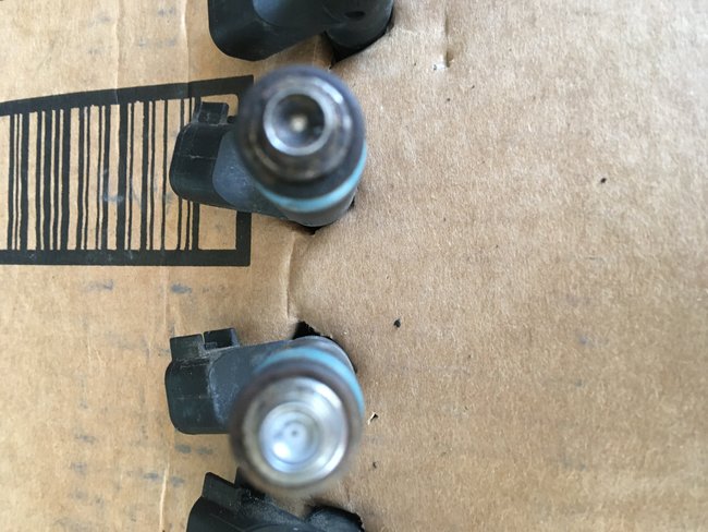

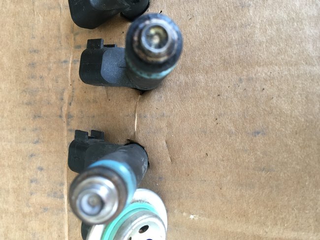

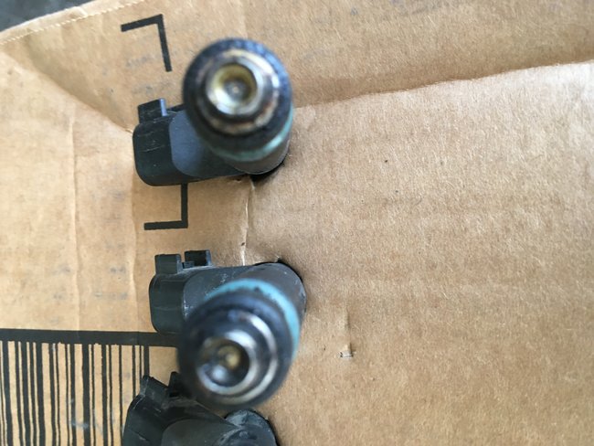

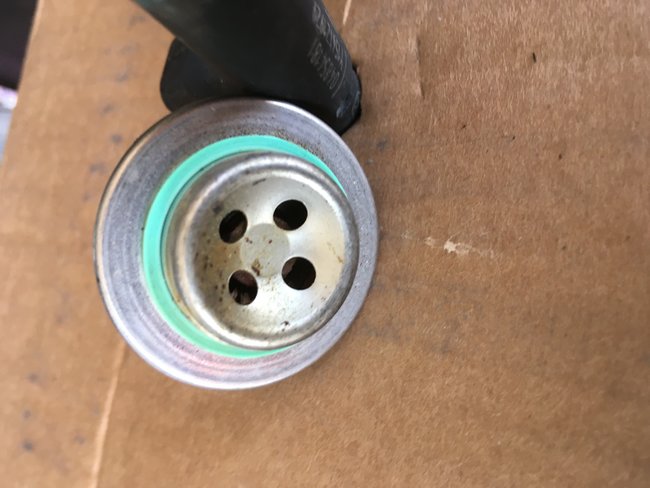

Hey Joe, this is what I found the dirty ones were the one that changed the idle when I unplugged them the clean ones no change in idle. But when I pulled out the whole rail and turned the key on I didn’t get any gas so I turned it over and still didn’t get any gas I’m confused. Anyway the damper is filthy would that have something to do with the way it is running should I replace all of them or can I clean the four up and by two new ones? Also the throttle body is filthy should I pull it off and clean it up what is the best way to do that? Also the oil does have gas in it again does that mean my rings are shot or am I just getting to much fuel I’m getting discouraged anyway let me know what you think and thanks again for your time and help.
Mar 14, 2021 at 1:18 PM
The smell of fuel could be due to one of the injectors being stuck open and then the cylinder not firing. I would try cleaning the good ones and replace the ones that made no difference when the engine was running. If there was no difference, they likely weren't working.
