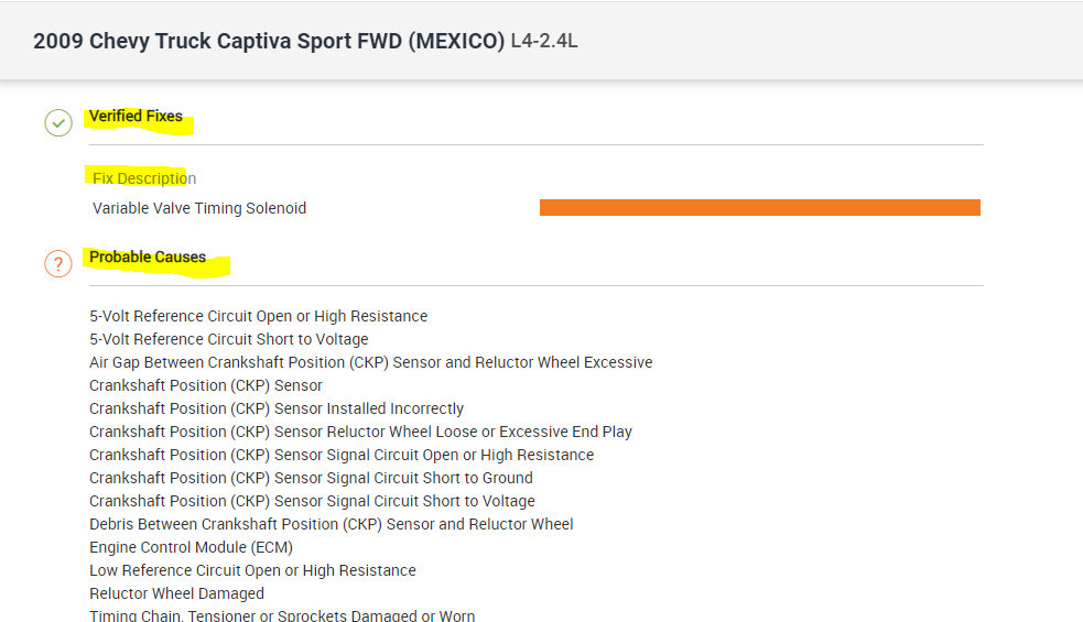

I checked the code, and it is a crankshaft position sensor code, but the repair, according to Alldata, is the VVT solenoid, which doesn't make sense to me. See pic below.
Check to see if there is spark at the plugs. If there aren't, we need to confirm there are no damaged wires to the CKP or something that was pinched.
