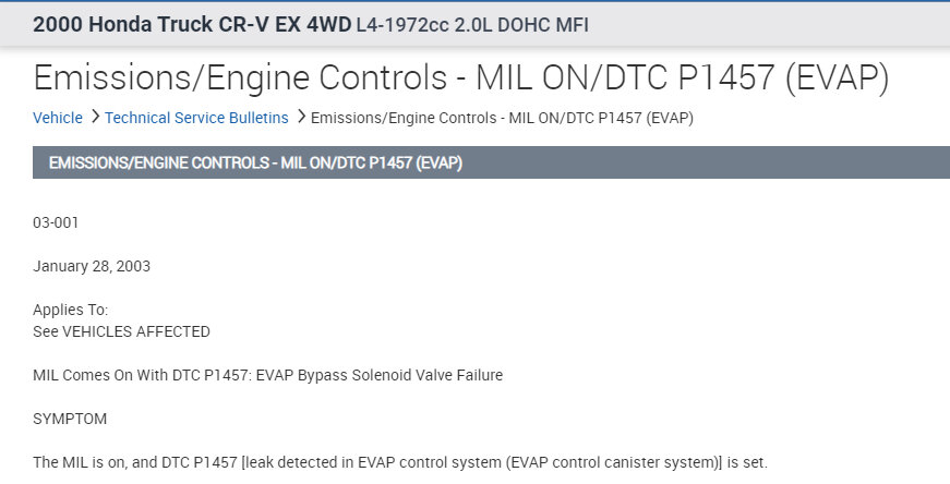

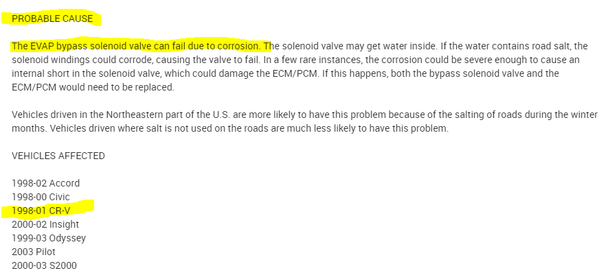

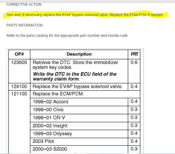

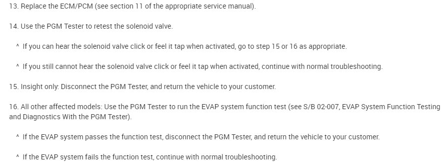

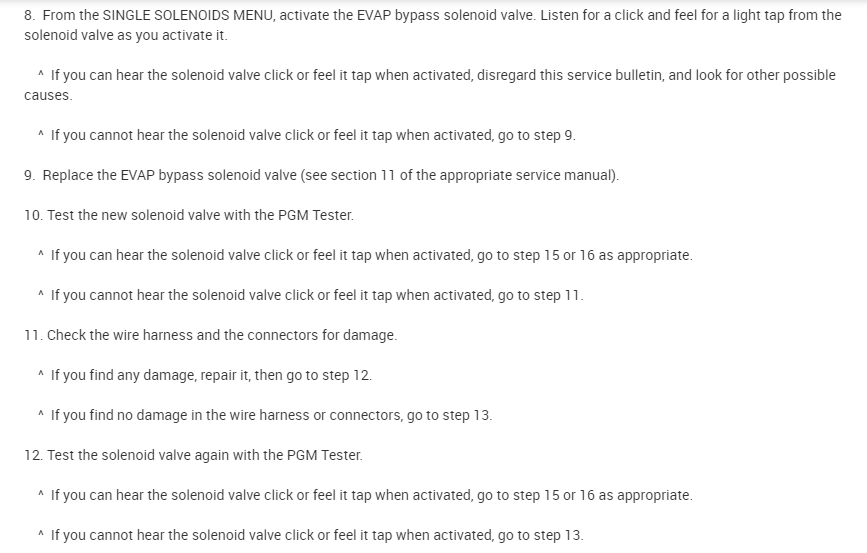

Misfiring. The test does not indicate what cylinder is misfiring. Two Diagnostic Trouble Codes were Present. P0420---B1 Catalyst System Efficiency Below Threshold; and P1457---Generic DTC Code--no description available. Emissions Results---MIL Commanded Fail.
