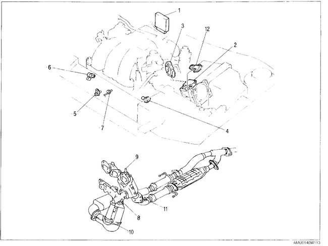

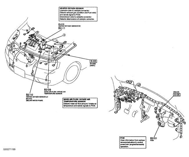

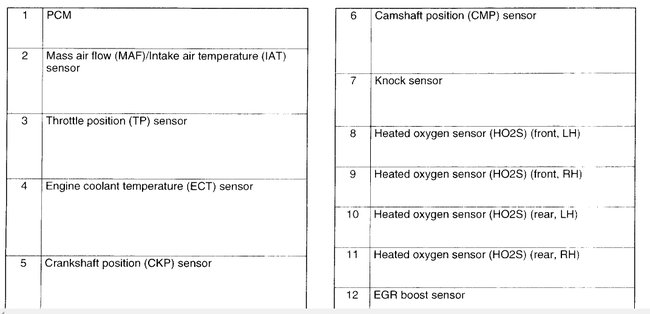

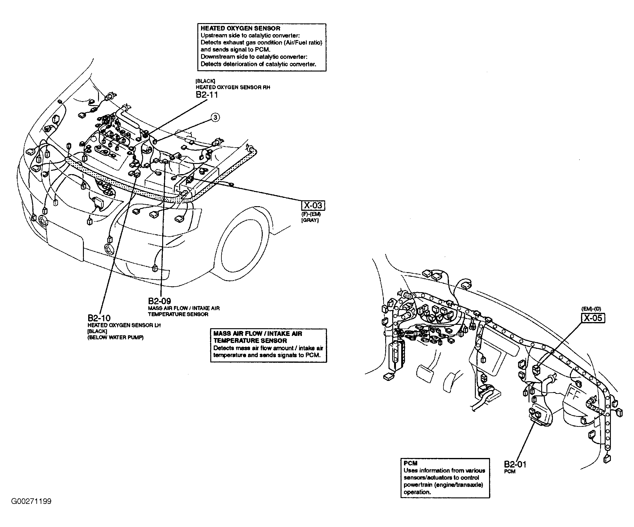

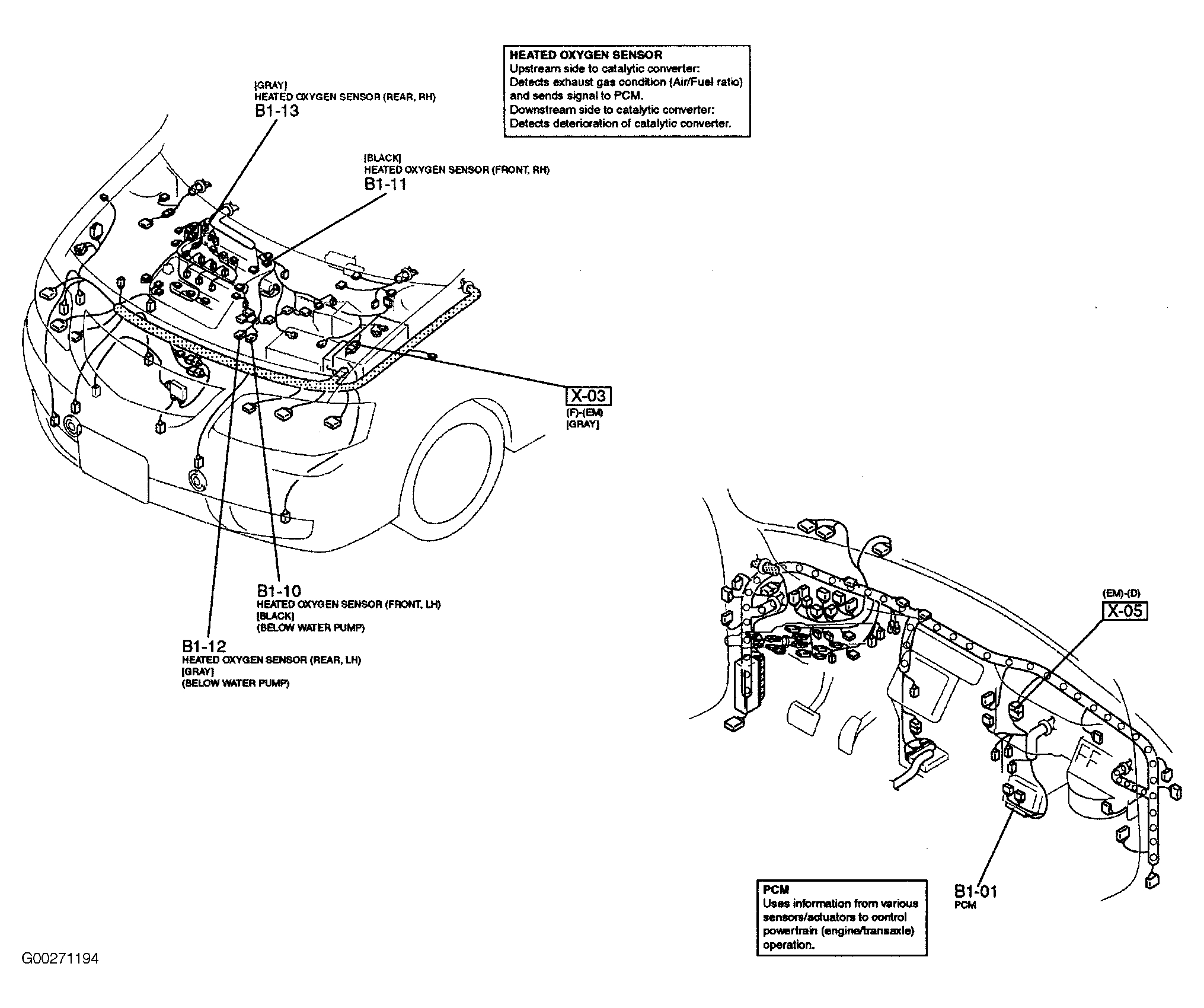

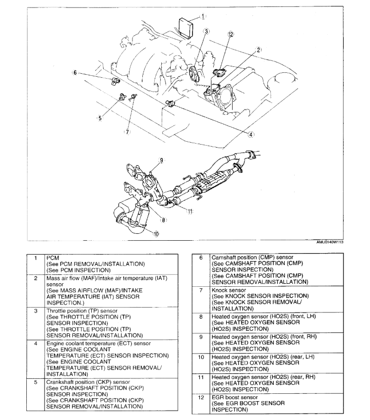

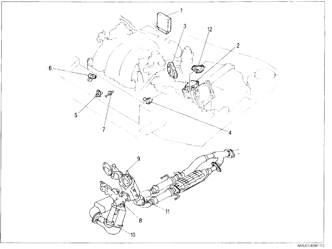

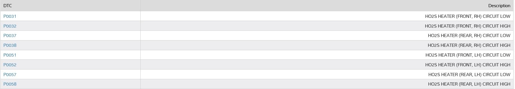

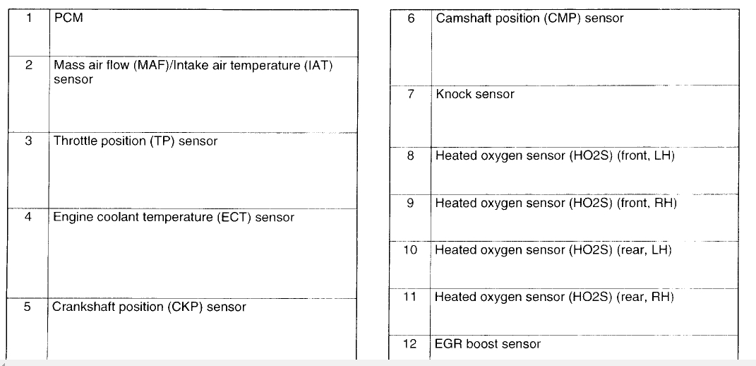

Using the diagnostic emission code reader, I can the bank 1 sensor 1 error. I replaced the sensor and cleared the computer and the light came back on with the bank 1 sensor 1 error. There are two sensors closed together and not sure if I replaced the correct one upstream or not. They are close to each other. P0030 OBD-II Trouble Code: HO2S Heater Control Circuit (Bank 1 Sensor 1). What I will do since I kept the original sensor I replaced is clean it up a little and put it back and use the sensor I originally purchased for Bank 1 Sensor 1 into the correct area. Thanks for the information. I obviously got confused with the location. Do you have a diagram? Thanks, Mark
