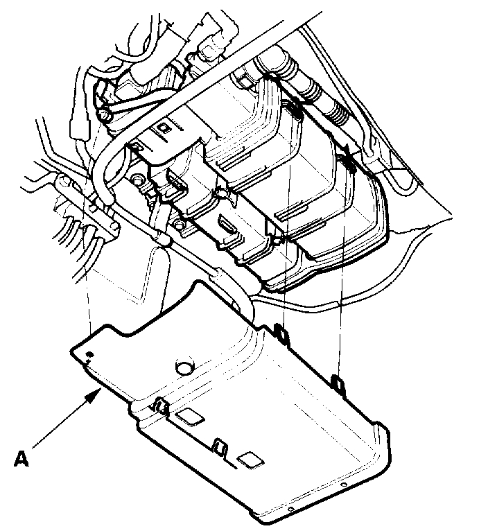

Picture 1
1. Remove the EVAP canister cover (A).

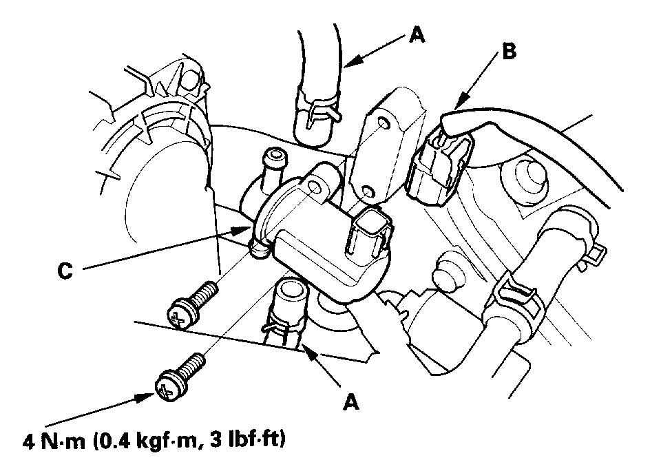

Picture 2
2. Remove the hoses (A), the FTP sensor 3P connector (B), and the EVAP canister vent shut valve 2P connector (C).
3. Remove the bolts (D)
4. Remove the EVAP canister assembly (E)

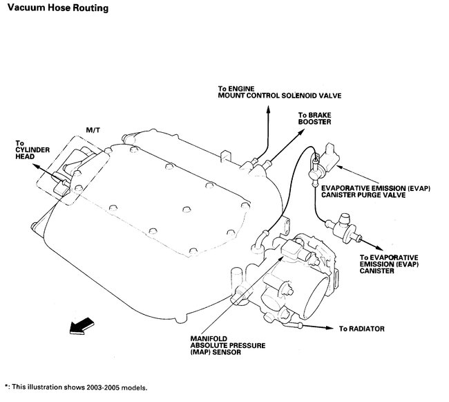

Picture 3
5. Remove the EVAP canister bracket (A).
6. Install the canister in the reverse order of removal

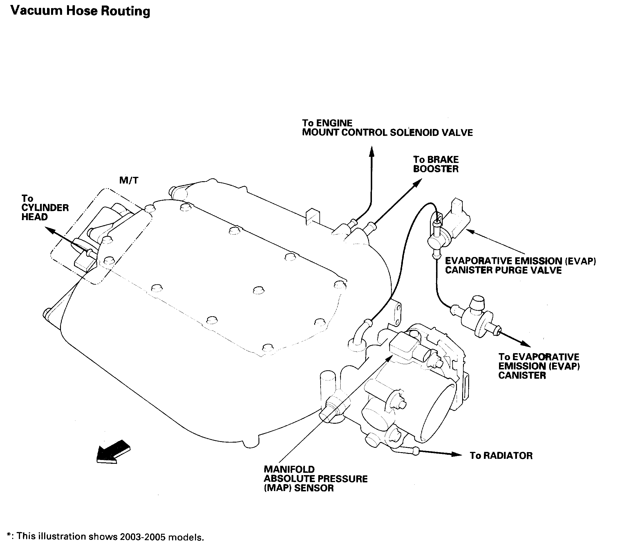

Next is the canister purge valve. It is located under the hood of the vehicle. See pic 4 for location. Check to make sure there are no disconnected or damaged hoses to it.

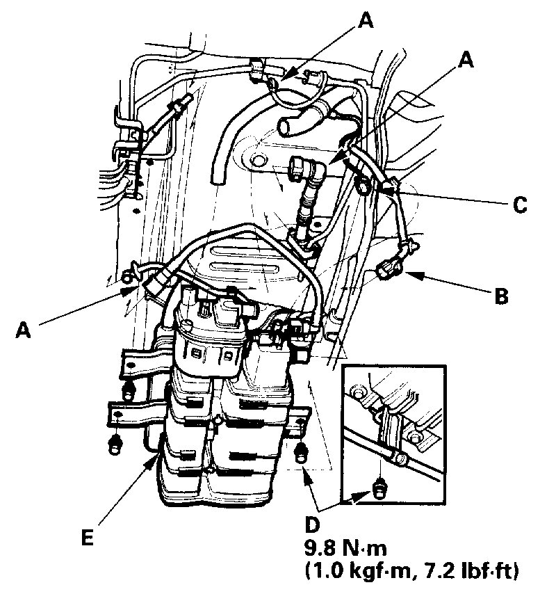

See Picture 5
1. Disconnect the hoses (A) and the EVAP canister purge valve 2P connector (B).
2. Remove the EVAP canister purge valve (C).
3. Install the valve in the reverse order of removal.
